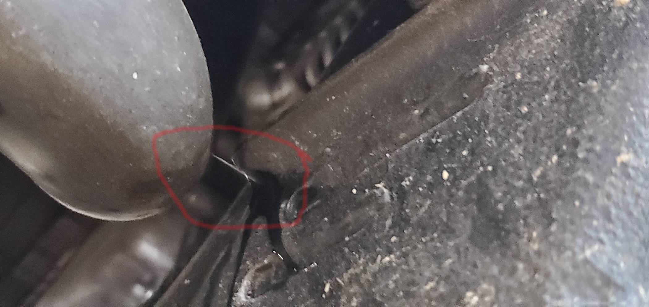

right in the center of the hose there was a Pin hole, its open on the bottom of the truck so it could have been road trash...
It had over heated before I knew what was wrong, I added water and it stayed in for 2 days then over heated again, I was parked at a store and noticed water on the ground in the front driver side, and when I looked up there I seen the hole under pressure was just pissing, I called Ford there were no hoses in the system they said they couldnt even get one, I said if I bring it in how long can it take? he told me since he couldnt even order one it could sit there weeks LOL I found a high end after market company that carried mishimoto it was $175 WTF could I do I had to order it!
I got the right antifreeze because these trucks think they are special LOL
I started the truck and it still showed as over heating and in limp home, but wasnt throwing codes but I wondered if clearing it anyway would reset the dash so I tried it and it just worked and I dont even know why :)
