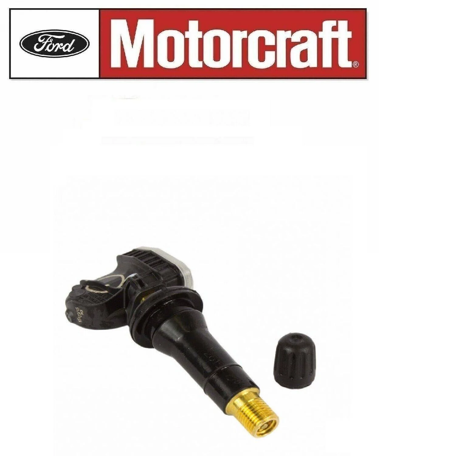

The valve stem might have TPMS engraved in it. If you're lucky you may be able to identify the unit per the stem. Here's a picture of a Bronco unit:
I don't see any engravings from this angle...
You might have to air down a tire completely and peek in.
