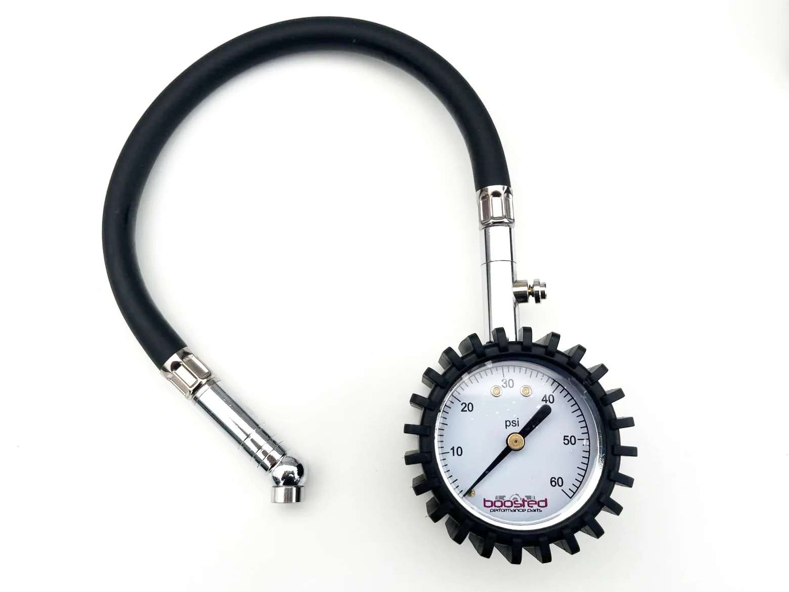

"Old School" TPMS.....always works, no batteries needed, only 2 minutes of your time.....
