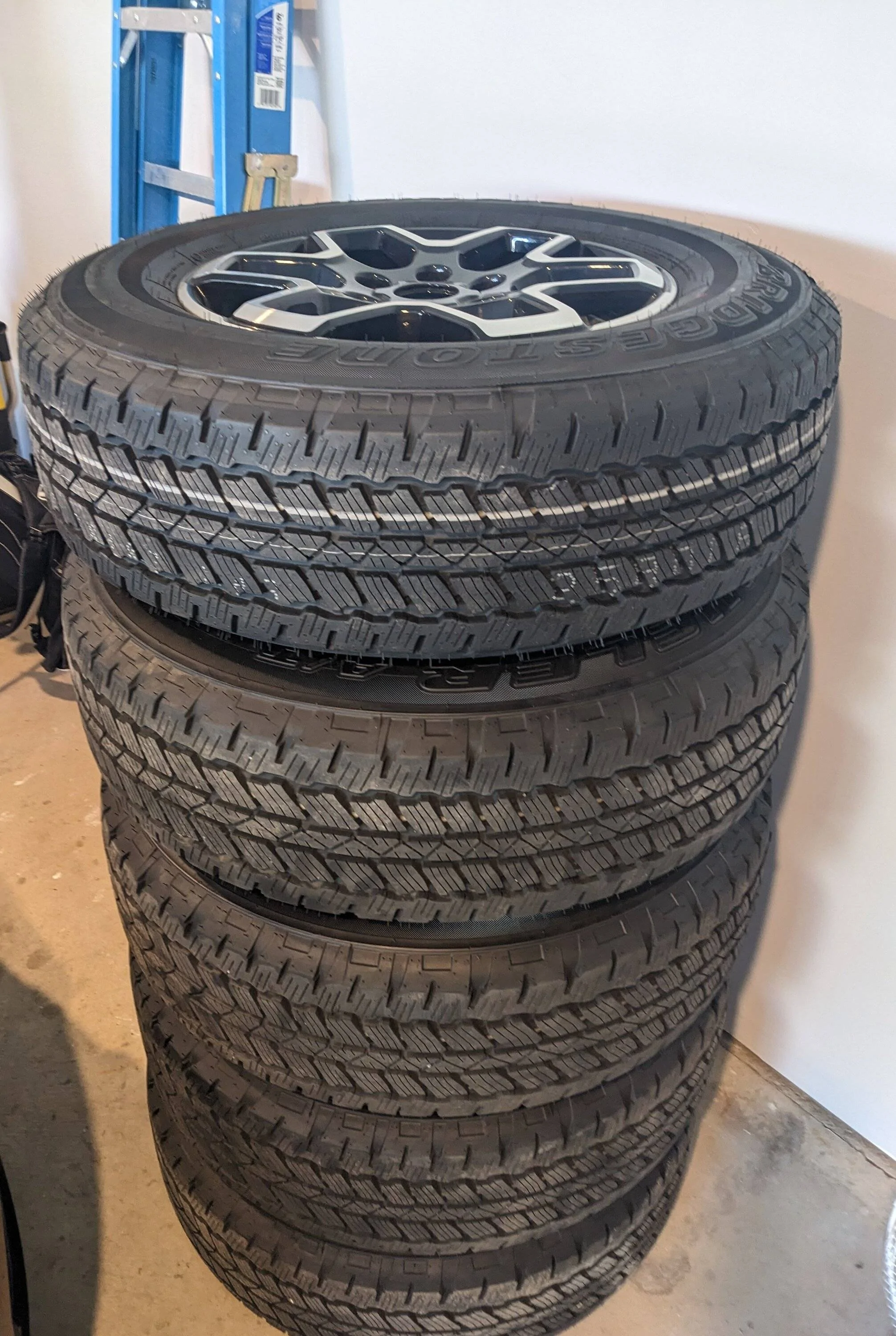

I purchased a set of 5 used 18" wheels/tires off a Bronco that has 15 miles on them.
I did some research and it looks like I should be able to run them on my 2023 Ford Ranger XL without any issues. I'm hoping anyway. I do have a couple questions.

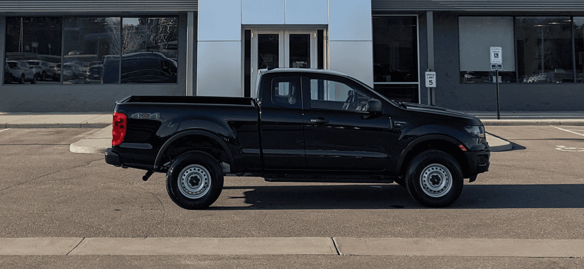

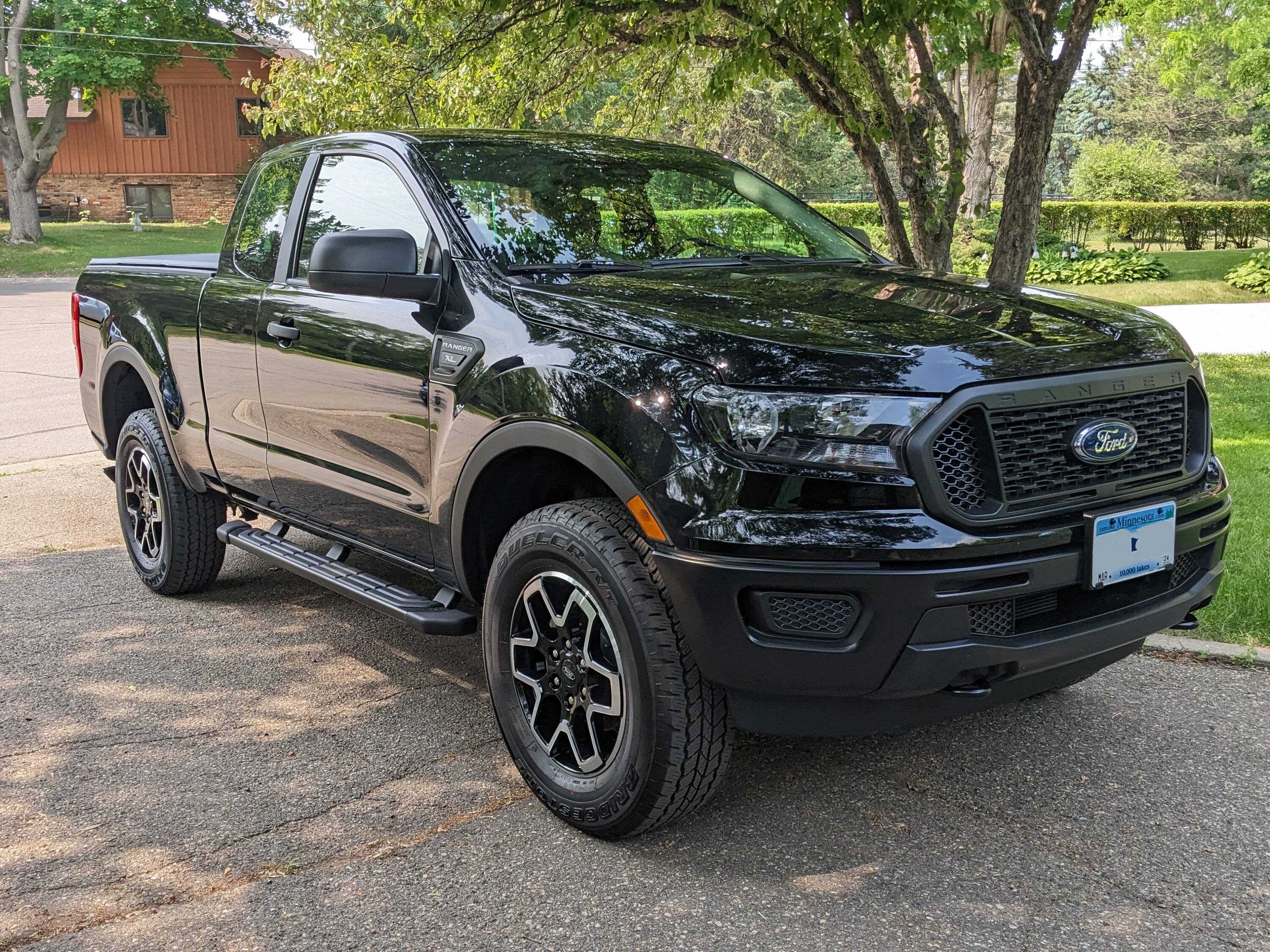

Here's a picture of before and after with the wheels.
Before:
After:
The TPMS sensors were never an issue coming from a Bronco to a Ranger. Nothing ever showed up on the dash. I thought I might see something for the first few miles.
I want to say the speedometer is maybe 1-1.5 MPH off going from a 16" to a 18" wheel. The local police department dropped off one of those radar trailers that post your speed just outside my neighborhood a few days ago. Not only has traffic slowed down, I was able to double check the difference in speeds. Ha! The police radar seemed to be closer to 1 MPH difference compared to 1.5-2 MPH on my GPS. Pretty minimal either way.

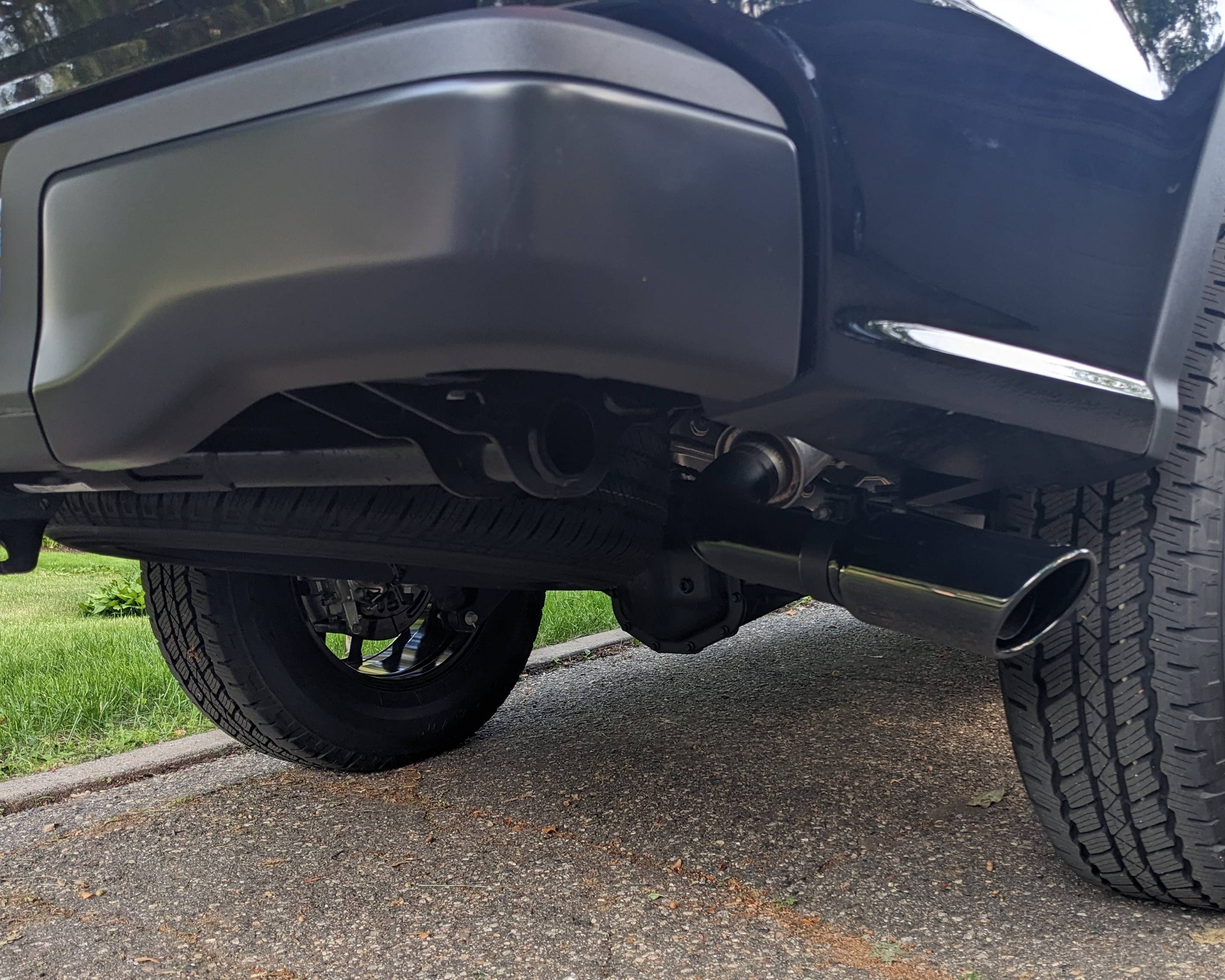

I also remembered my Dad commenting when first picking up the Ranger on how the exhaust looked like cheap pipe conduit. So I hit it with some Krylon high heat paint and added and black chrome exhaust tip. That was a nice visual upgrade.
