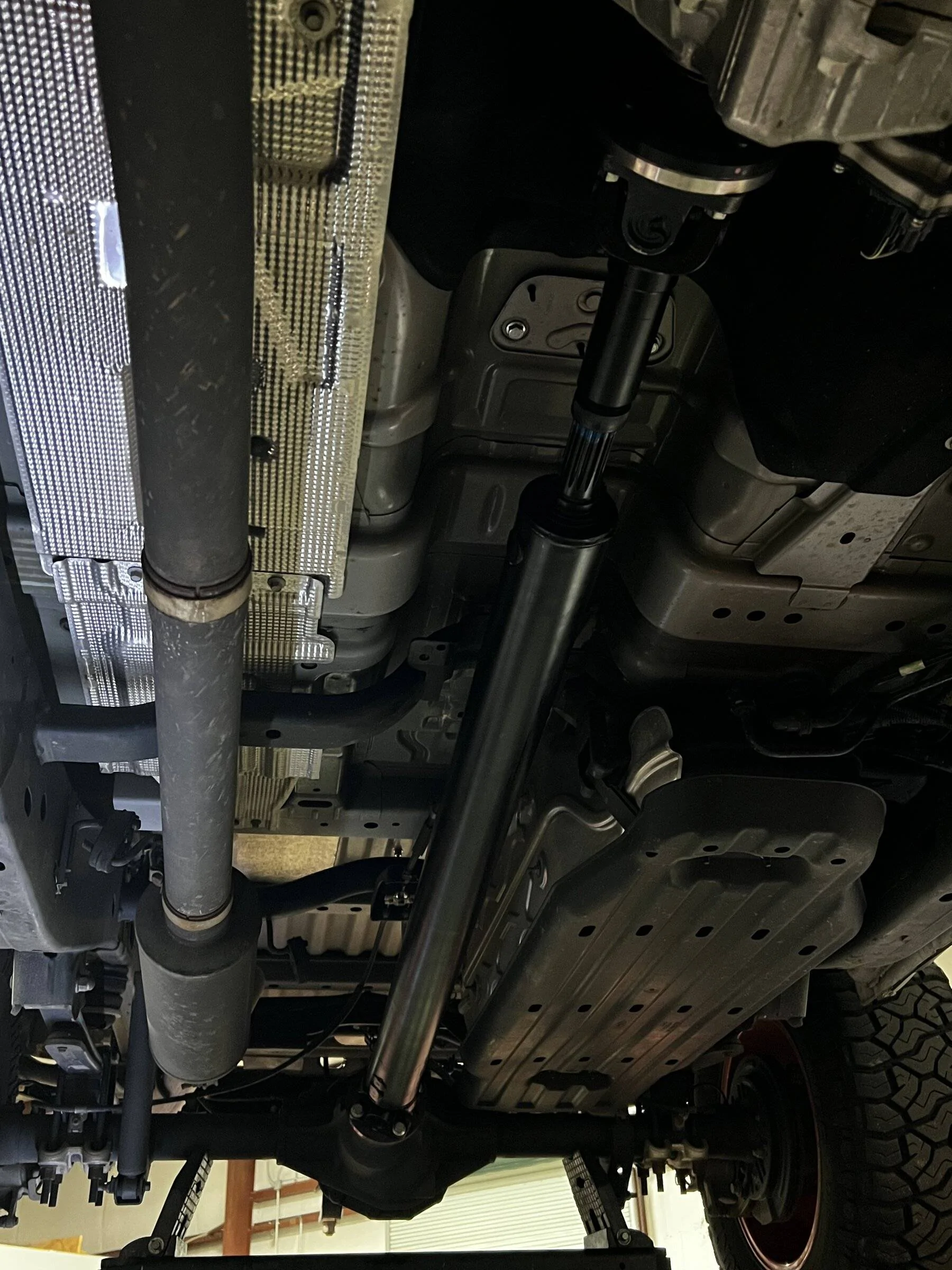

No more slip yoke clunk I take it?
None at all. It drives smoother now then when I first bought the truck. I have a pretty aggressive tune on it so it shifts a little hard, and you could really feel it in the drive shaft. Now it’s as smooth as butter.

I’d say it’s worth every penny. Plus you don’t have that carrier bearing attached to the body anymore so in my case, idk if it’s the same for all rangers, it made the interior much quieter.

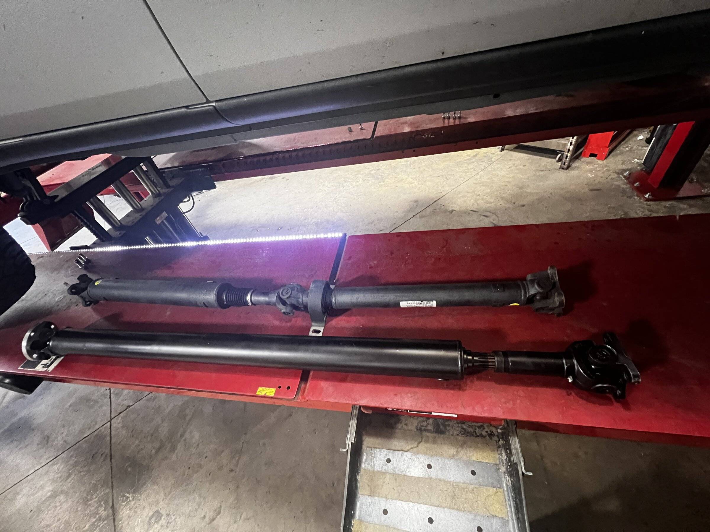

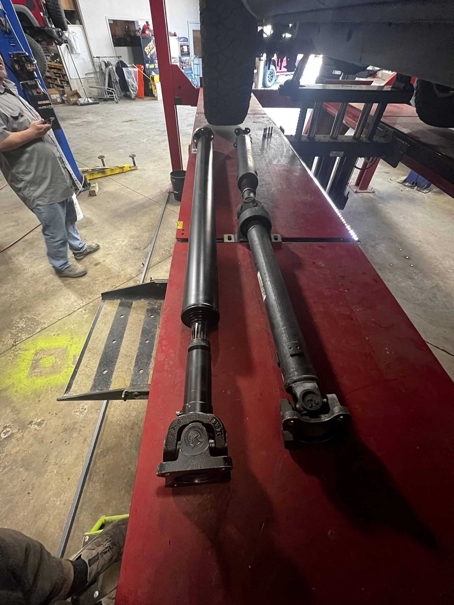

Why does the new one-piece look longer than the original in the pic?

It’s just the camera angle, and I also did not have them perfectly lined up with one another. If you order one from Tom Woods you have to measure for the new one.

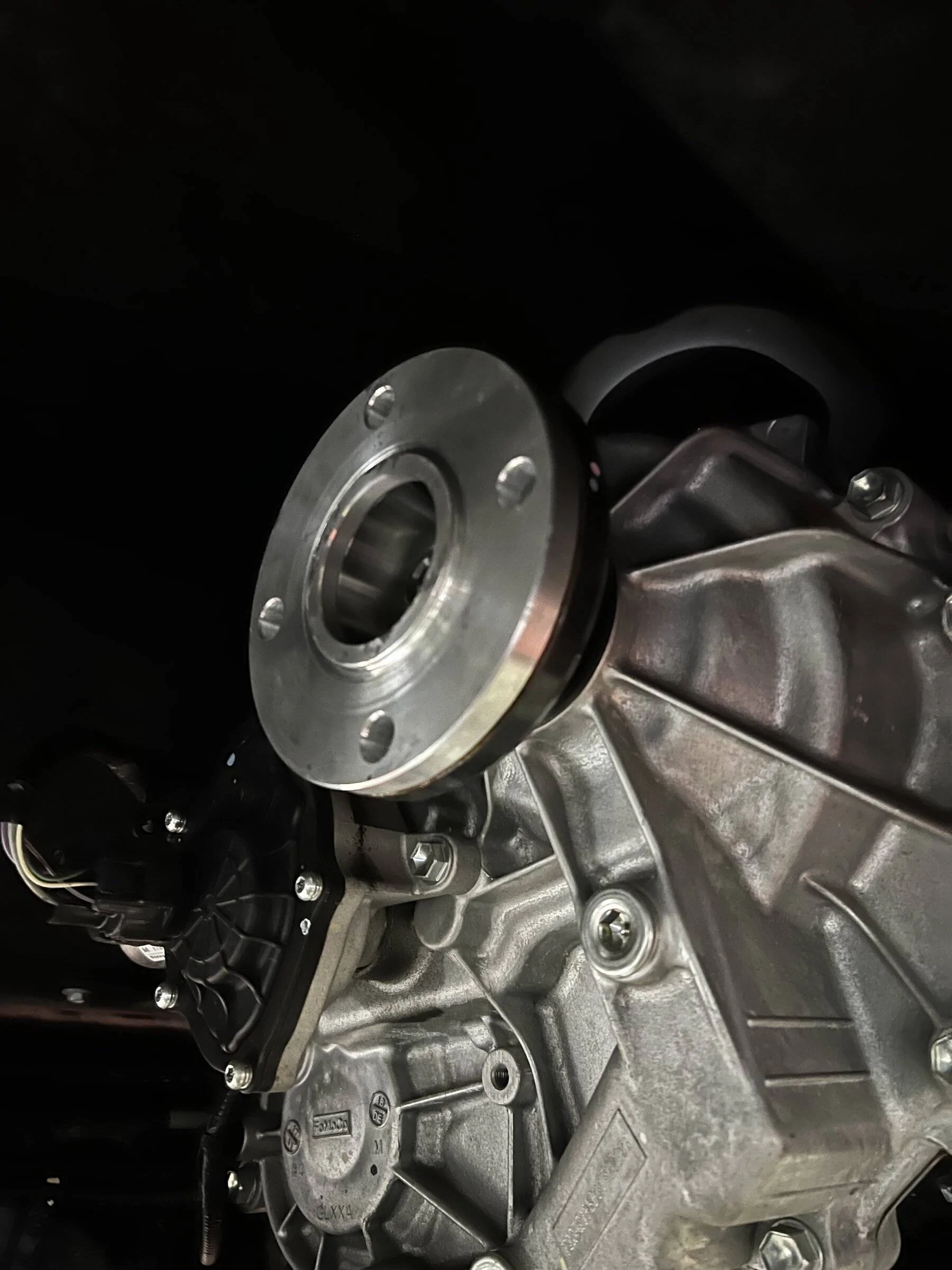

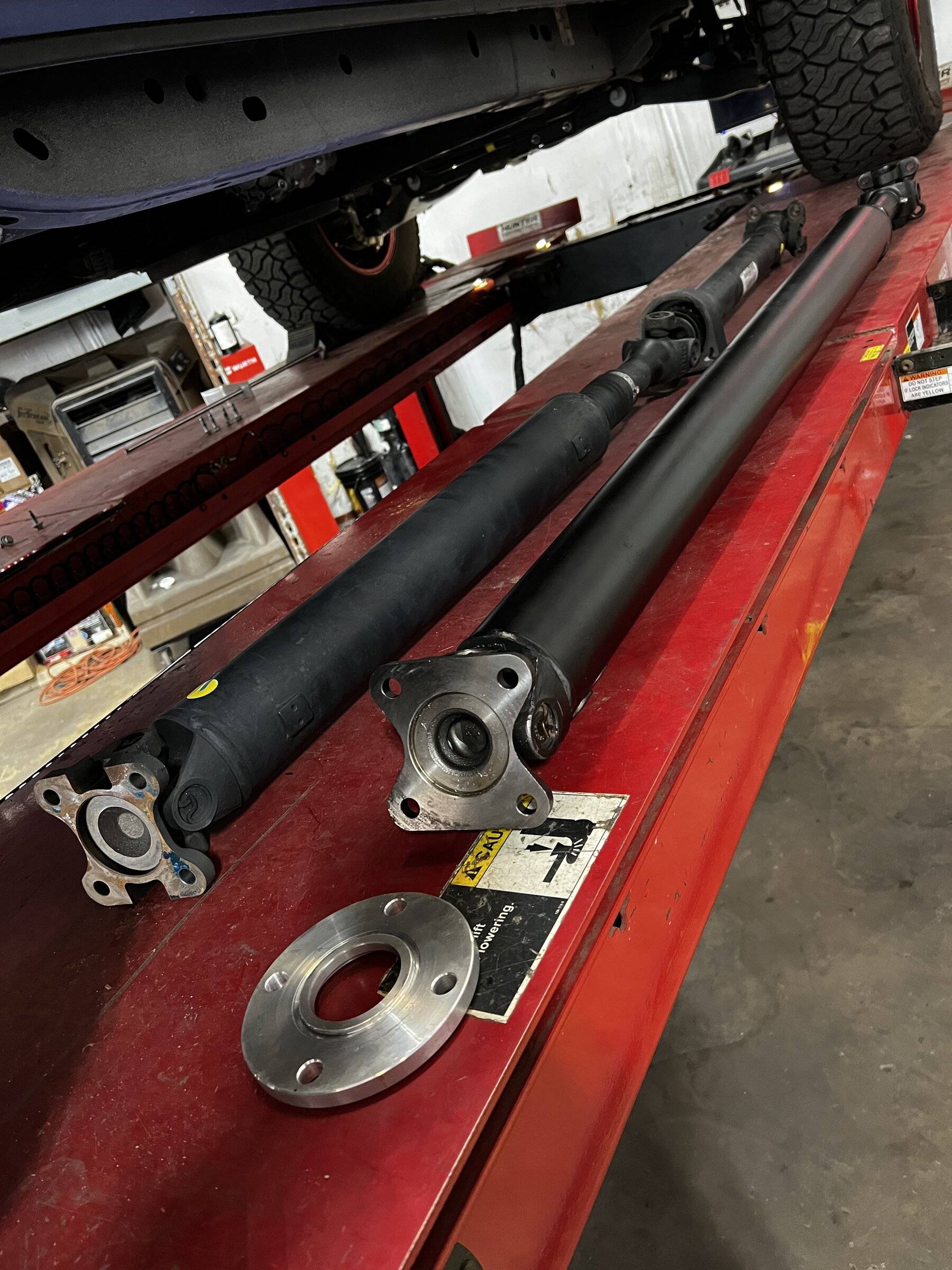

Just installed the Tom Woods one piece drive shaft and man did it make a huge difference. No more vibrations, and it helped tremendously starting from a dead stop. It has 1350 u-joints and a aluminum spacer plate to mate up to the transfer case.
