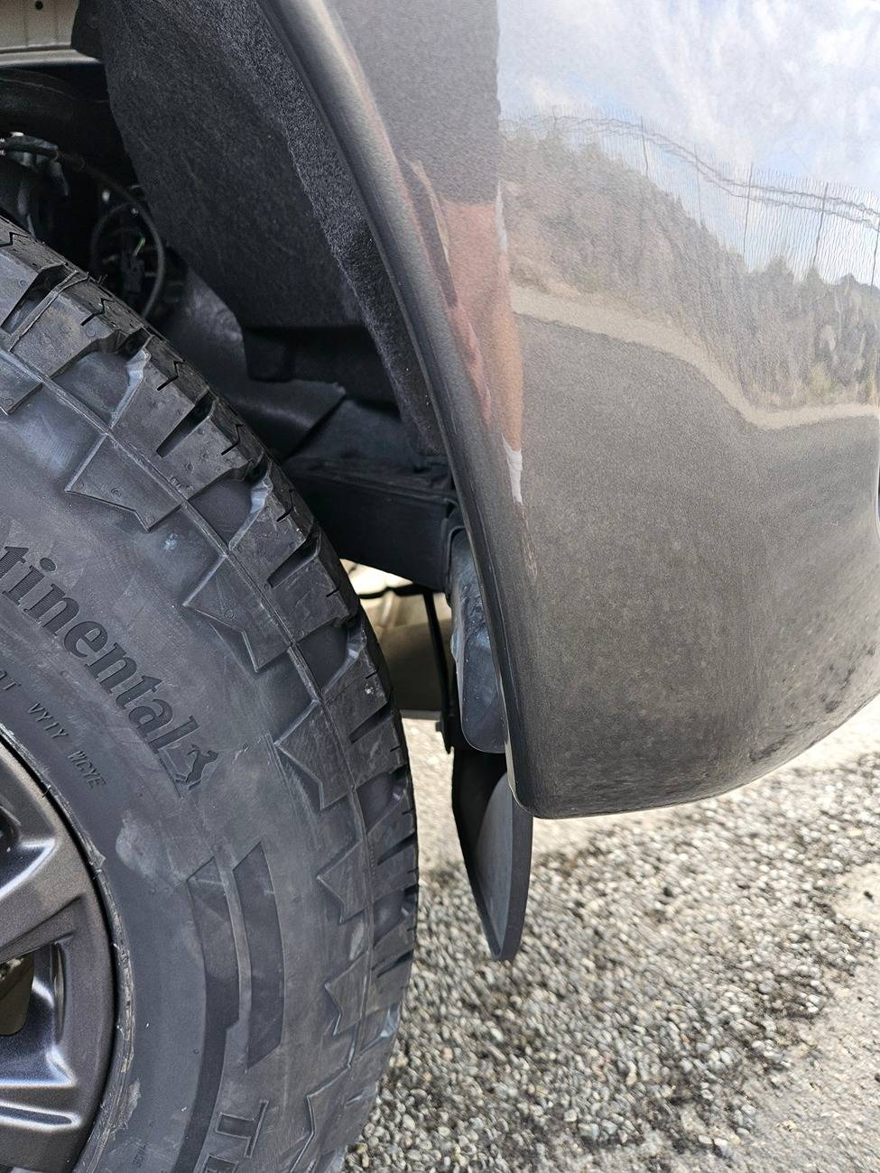

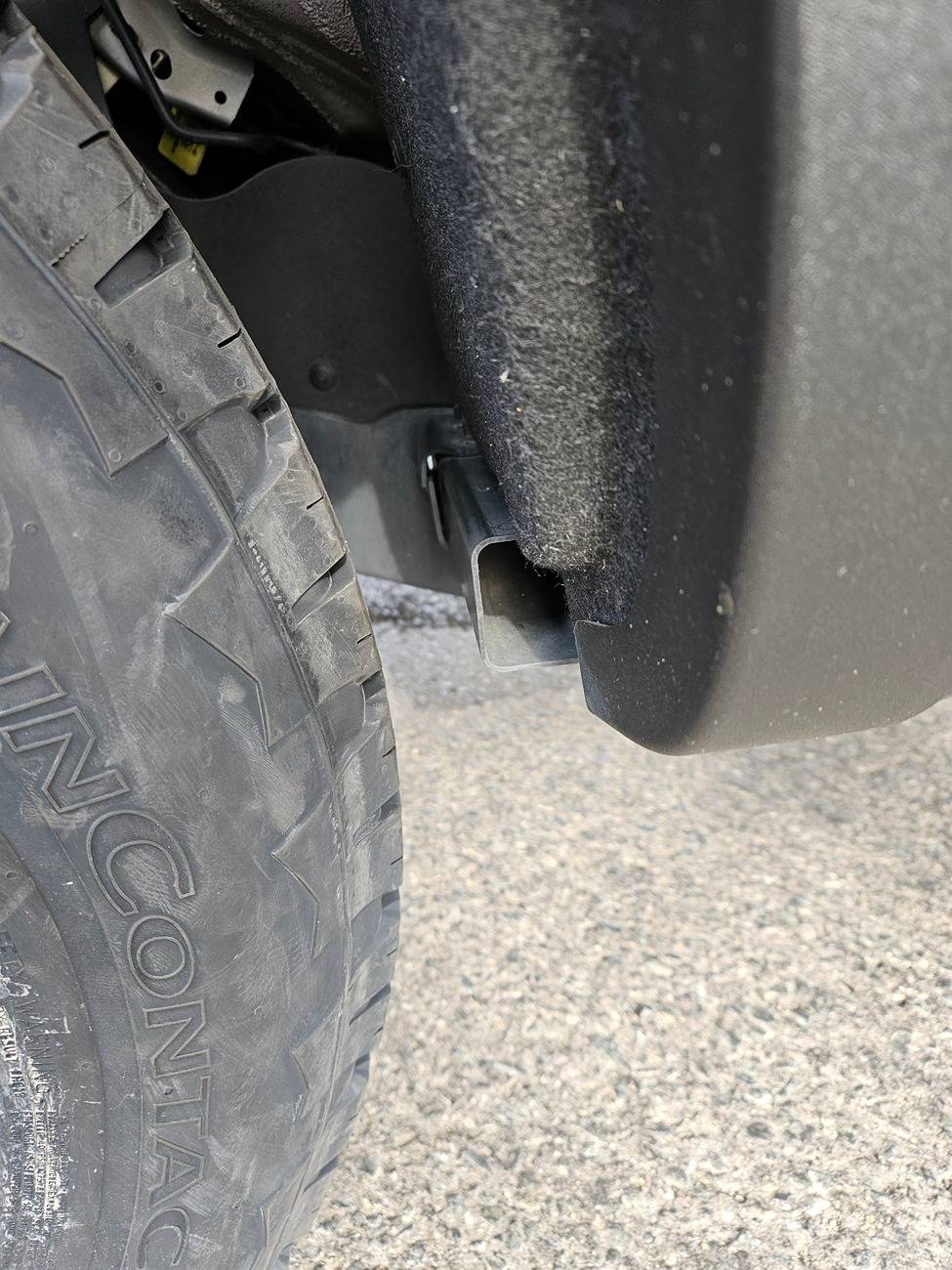

Tires vary by brand a lot. I just went to Continental TerrainContact A/T and they run pretty big. They are 1 inch taller and nearly an inch wider than the stock 265/65R17 Hankook's on my FX4. BFG KO2's run the smallest. I did go up 3/4" in the front but have had no rubbing. These photos may help.

Good thought on the specific tire differences. My first new set of tire purchases will be snow tires, which can be beefy, so I will need to do some more research. At this point I may just get 265/65 tires to be safe but they oddly are more expensive than the 265/70.
Like I said, I was a little surprised as to how much bigger these were. More so the width than height. I run BFG KO2's on my Jeeps and they are noticeably smaller than what they replace. In all my searches, it seems pretty unanimous that 265/70 will fit without rubbing. As snow tires tend to be a little more narrow than other styles to help them dig in, I think you will be good. My local Discount Tire will mount one tire and wheel, throw it on the front and let me check everything for clearance before continuing. They said there was no need with the 265/70. They have done a lot of them. Strange about the price difference.
Thank you for the very specific feedback. I will go ahead with the 265/70 based on what you and others have said. I will also go to Discount Tire so I can ask them to verify like you did as well.
