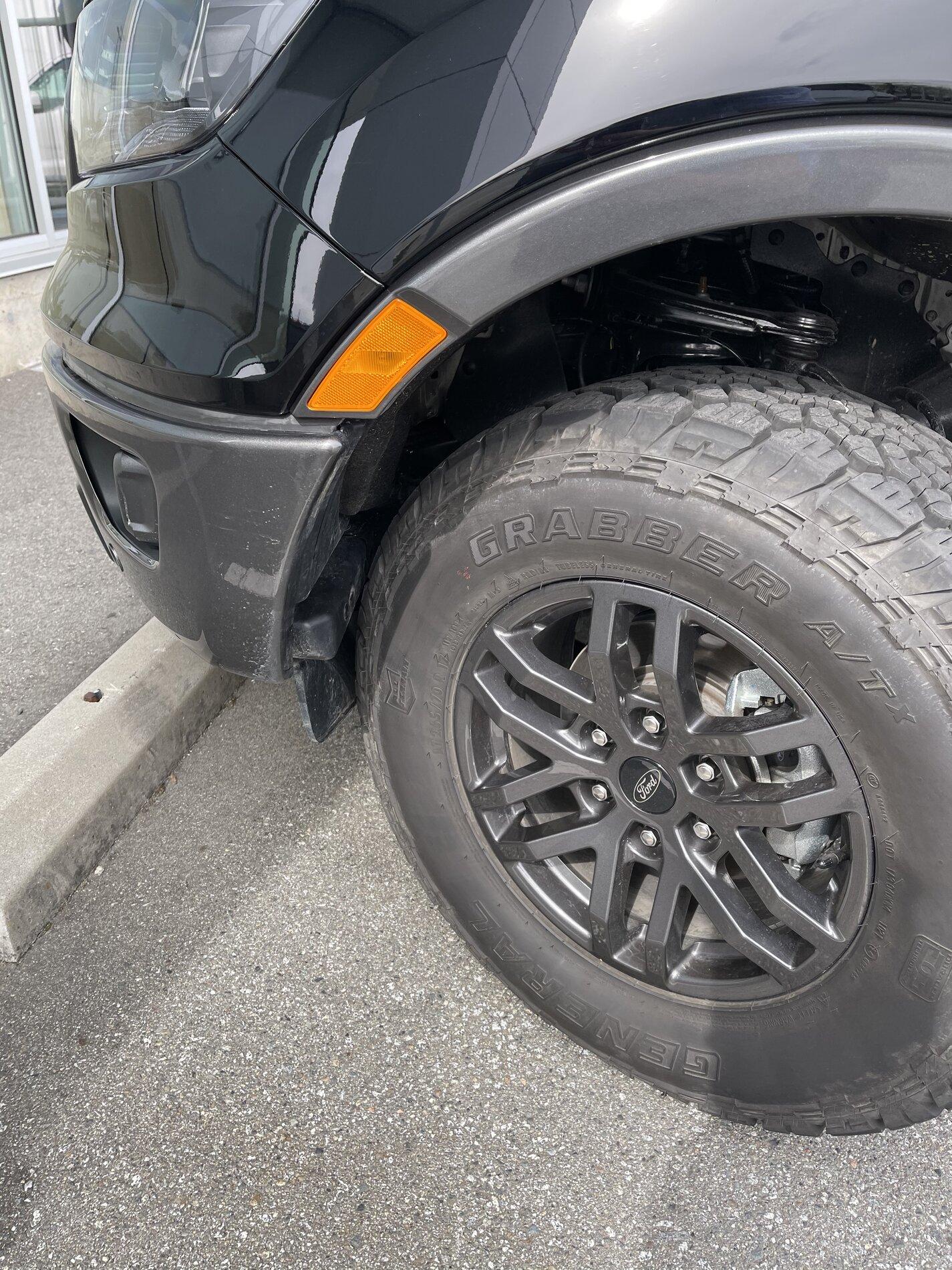

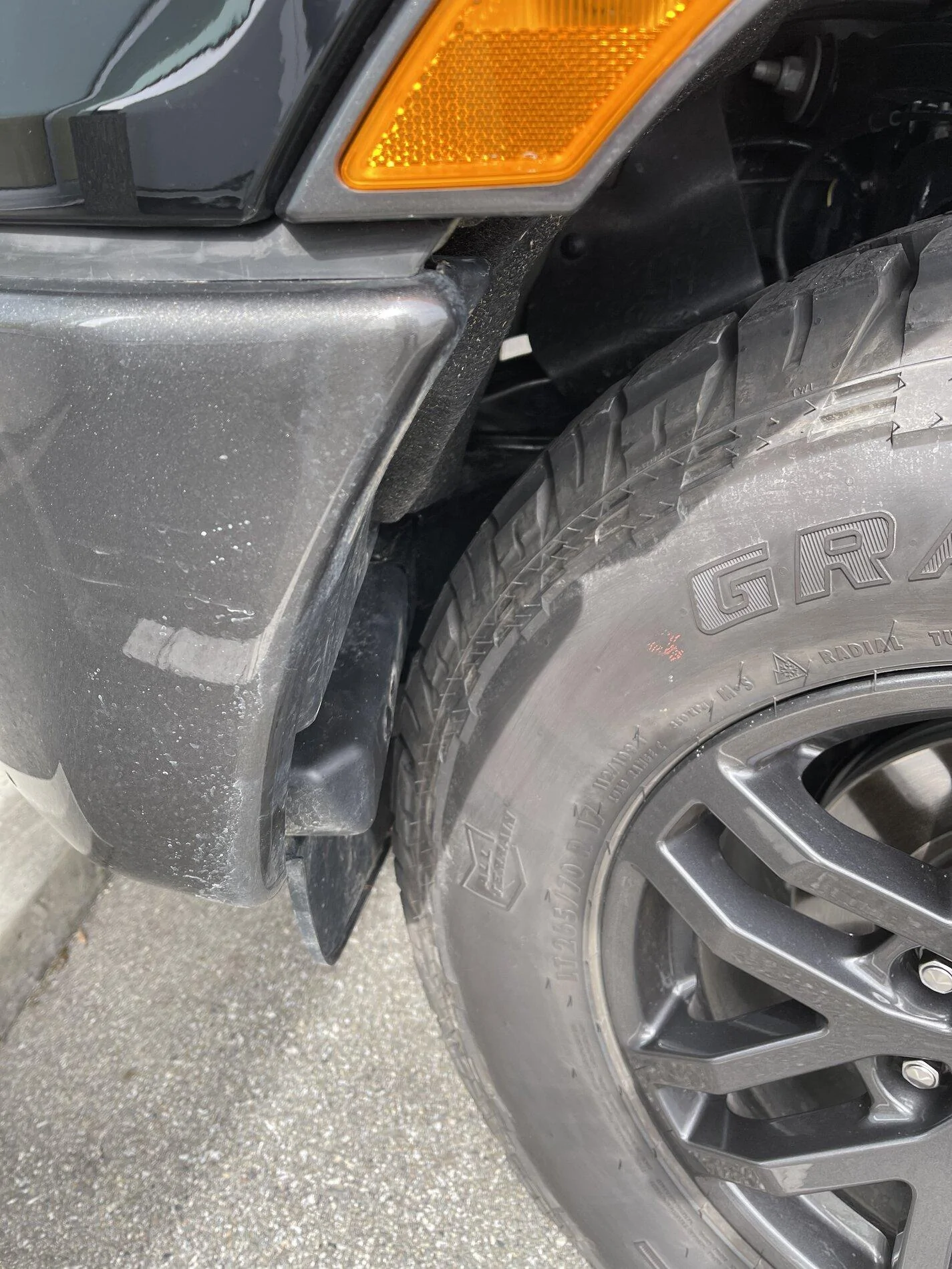

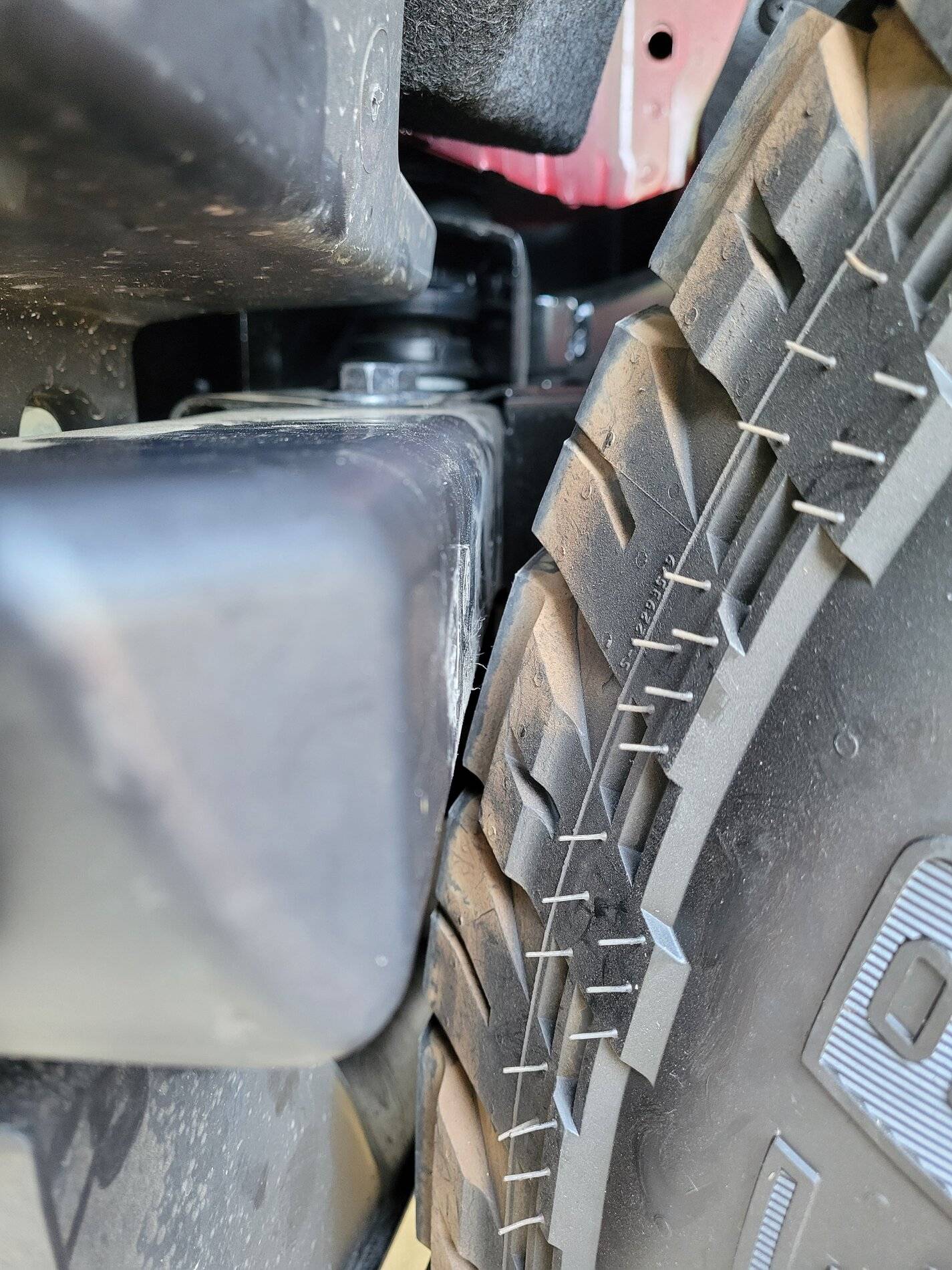

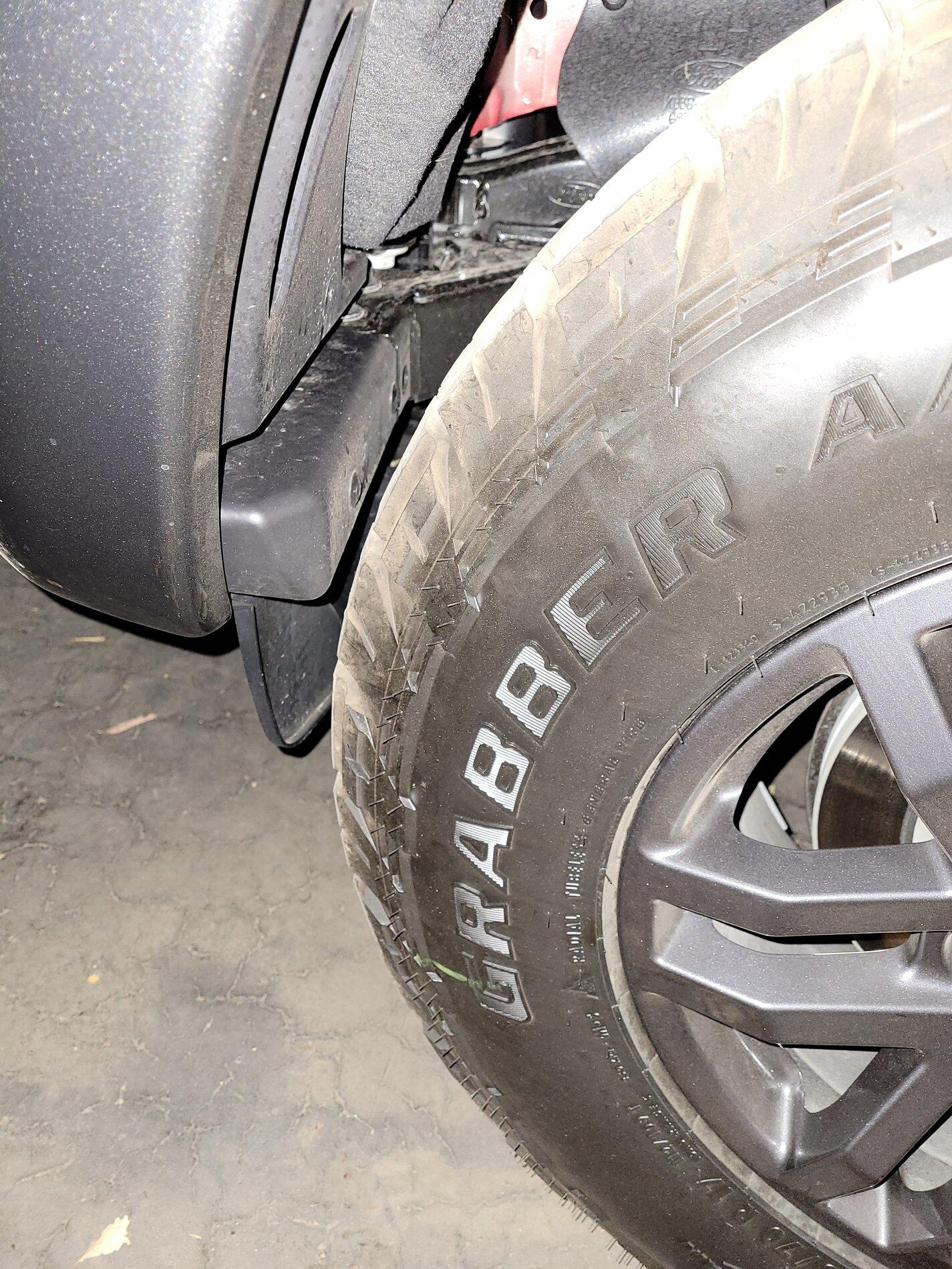

Just picked up my 2021 XLT Tremor last week. Truck is amazing so far, aside from a tire clearance issue on the front drivers side wheel that results in tire rub when turning full lock.
You can see in the attached photo exactly what the problem is. I’ve taken it to the dealer where they took pictures and began investigating. They said this is the first Tremor they have seen so have nothing to compare it to. Can anyone else with a Tremor confirm if their clearance is any better?
How do you even tackle an issue like this? What could be adjusted to fix this so it doesn’t rub? Is this just the way all Tremors were built?
Any thoughts are appreciated! Otherwise love the truck and relative to my 2020 XLT Sport it rides and handles like a completely different vehicle.
Was this issue ever resolved by the Ford dealership you purchased from??
