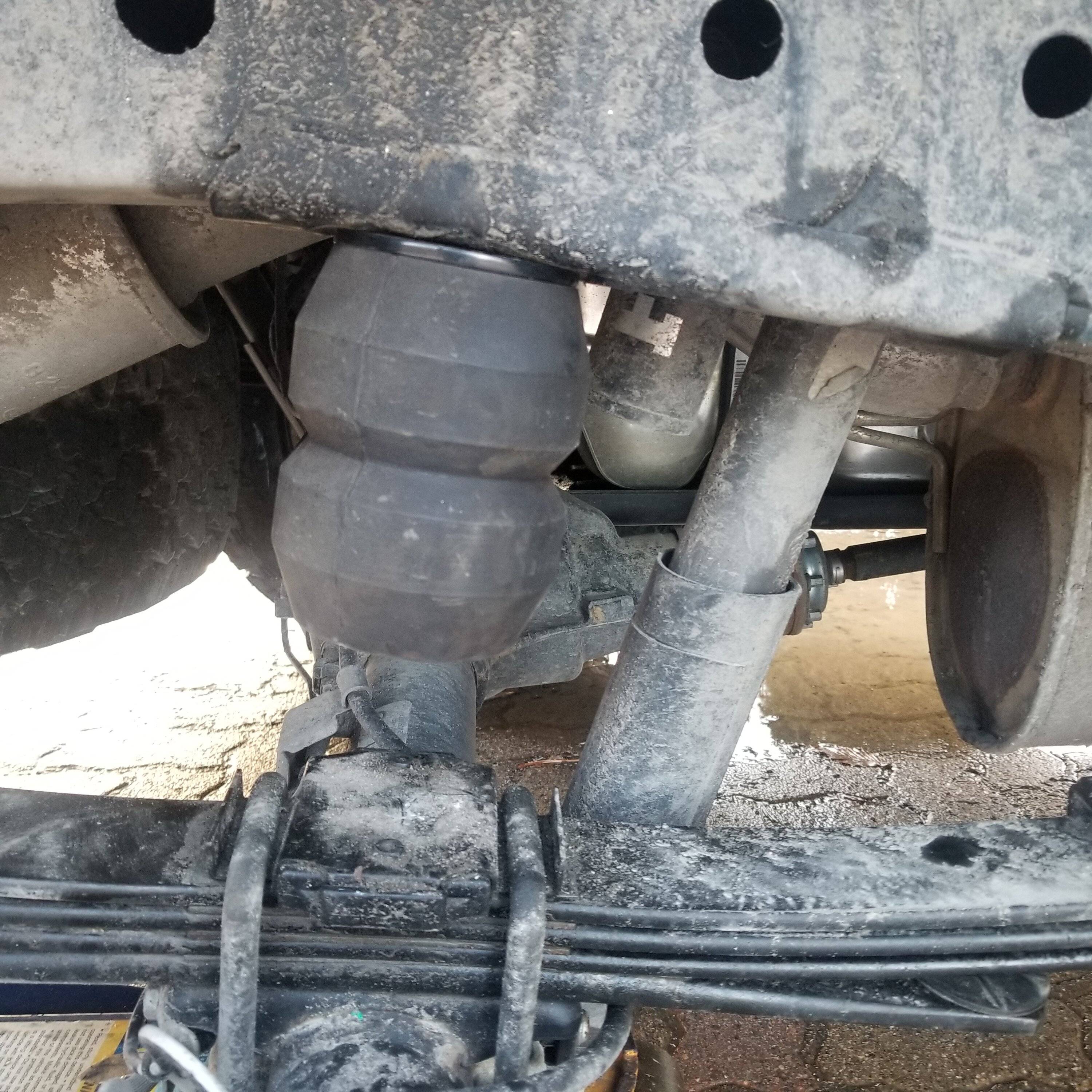

Back in '21 I ordered a ranger tremor. Only included the minimum options nessesary to be able to add tremor pkg.
I just picked up set of timbren ses and will be install myself.
I had a quick look around this forum.
I put this to anyone who added timbrens on a otherwise stock ranger with tremor.
Any comments?
Tremor has a bit higher clearance than standard rangers. Does that reduce or negate the effectiveness of the timbrens?
I haven't installed the timbrens yet, just got them yesterday.

Don't know if this will help you. I've got them on my fx4. Unloaded there's about 3/4 -1" clearance between the spring and the timbren. Maybe you could use a spacer on top to adjust the space. They are great for towing or a heavy load.

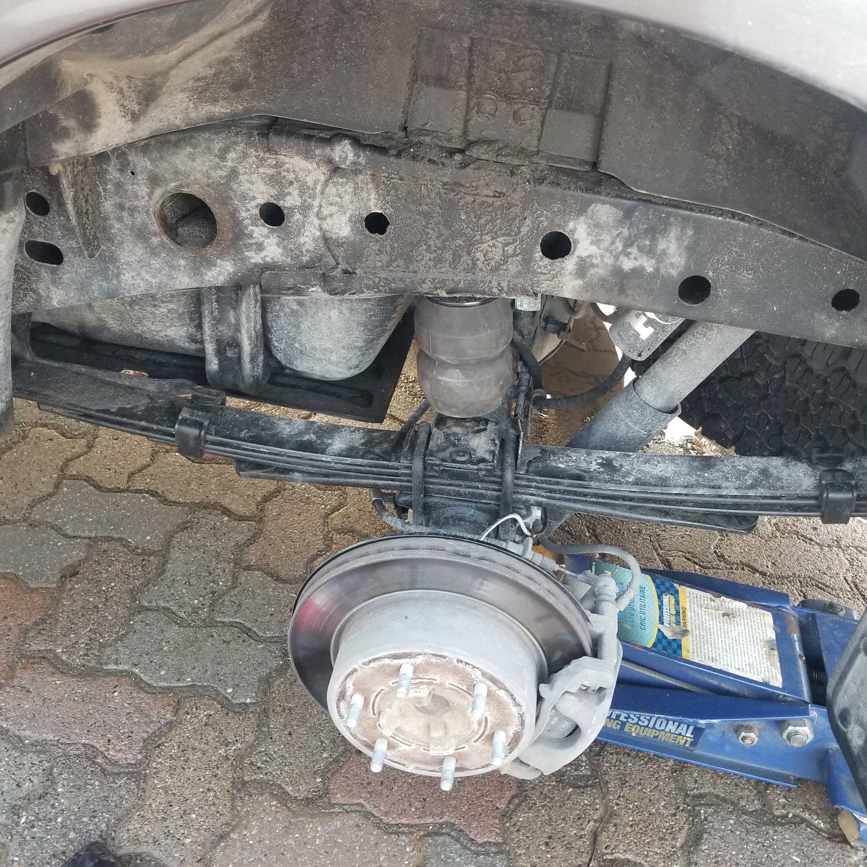

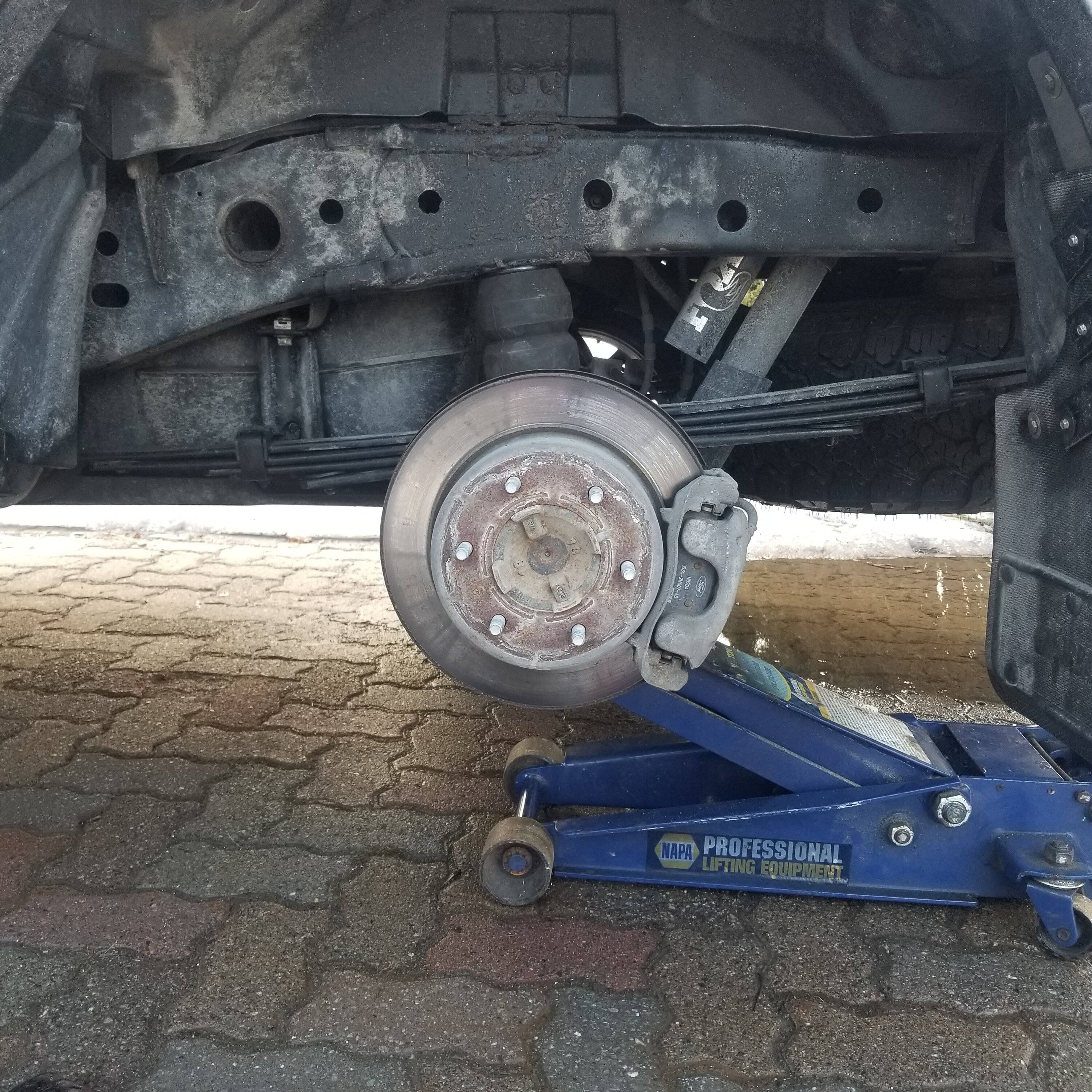

I went ahead and installed the timbrens.
Every year on fishing and hunting trips, the poor truck is heavily loaded so I thought it could use some help.
The rest of the time, as a daily driver, it is only loaded with snot nose, bank draining, poop factories. ?
Later this year, I will try to remember to post an update after doing the fun stuff off the pavement.
A 75+ mile trip on dirt roads. And climbs up a hill on a lumber trail loaded with venison bait and trailing an ATV.
Daily driving, with timbrens installed, has changed the way I drive the truck.
On parts of paved roads that are in good shape, you can't tell the difference.
Until I drove on bad sections of pavement or over speed bumps, pot holes and the like.
Which in my city, is practically everywhere. ?
It's a bit of a tradeoff.
Harsher ride on the bad stuff, however the back is much tighter, sportier. And I have more confidence because the truck is improved in directional control around corners.

Took the truck on a fishing trip last week. I did a good 100 miles of unpaved roads. No issues and the timbrens appear to have soften up a bit. Could be the heat. Hope they are not too stiff this winter.

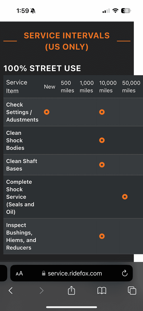

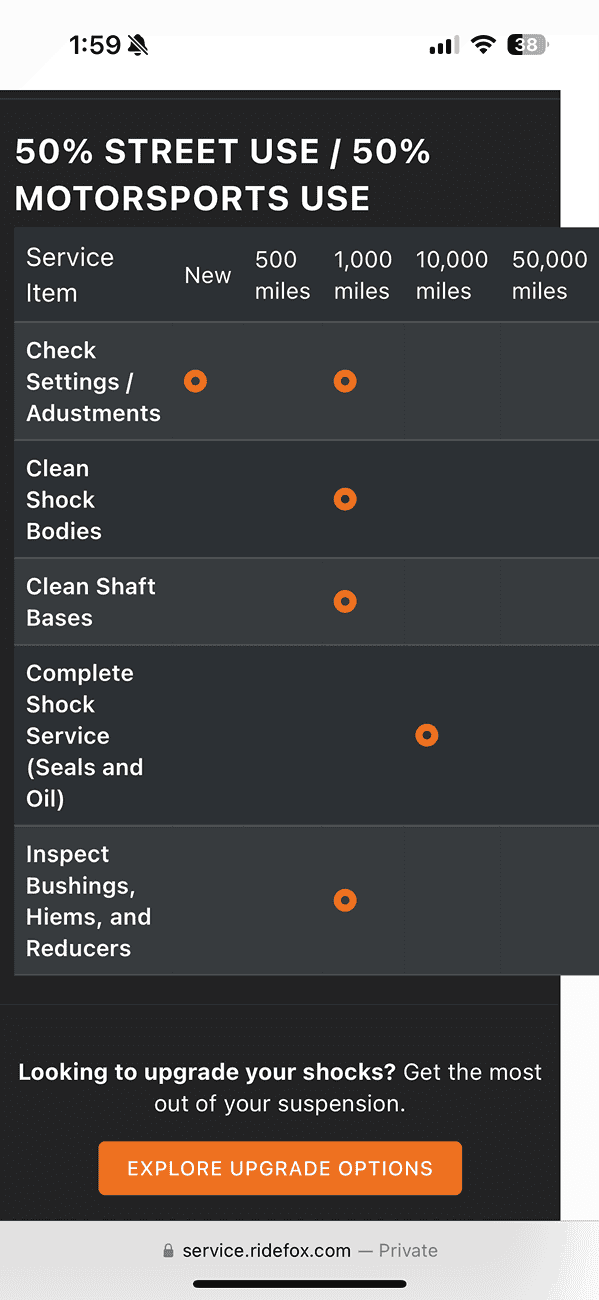

How many miles are on those Fox's? There was a thread recently that indicated the Fox's need rebuilt every few thousand miles or so.

The shocks have 25k miles. I started looking into replacing. I want to try a set of digressive, like Icons.
I also debated between timbrens and sumo and was originally going for the sumos but got a great deal on the timbrens.
The truck is either really lightly loaded or heavily ( overloaded in fact) so the timbrens really help reduce stress on the leafs during off road trips.
