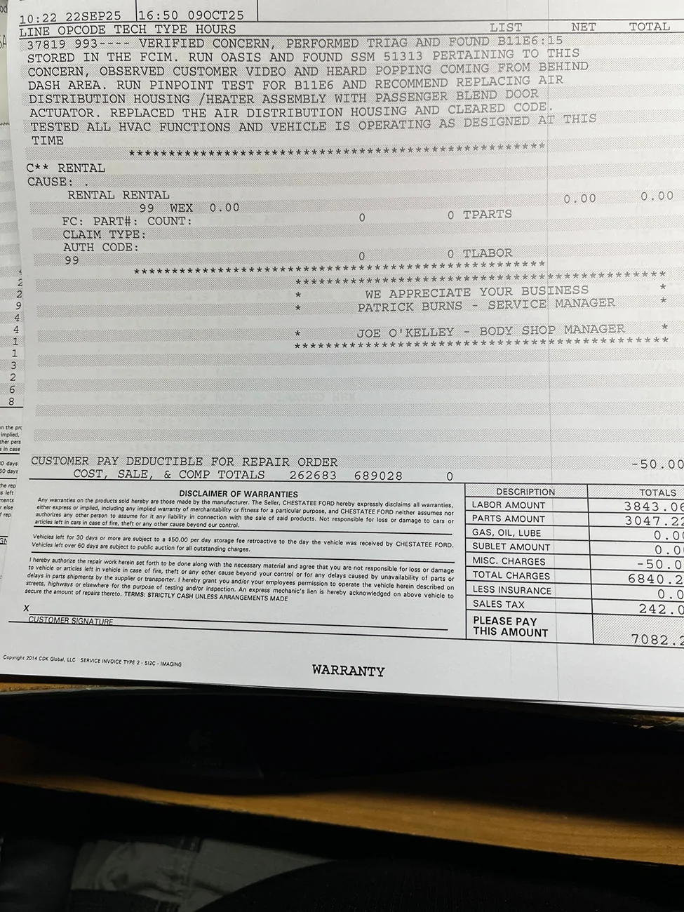

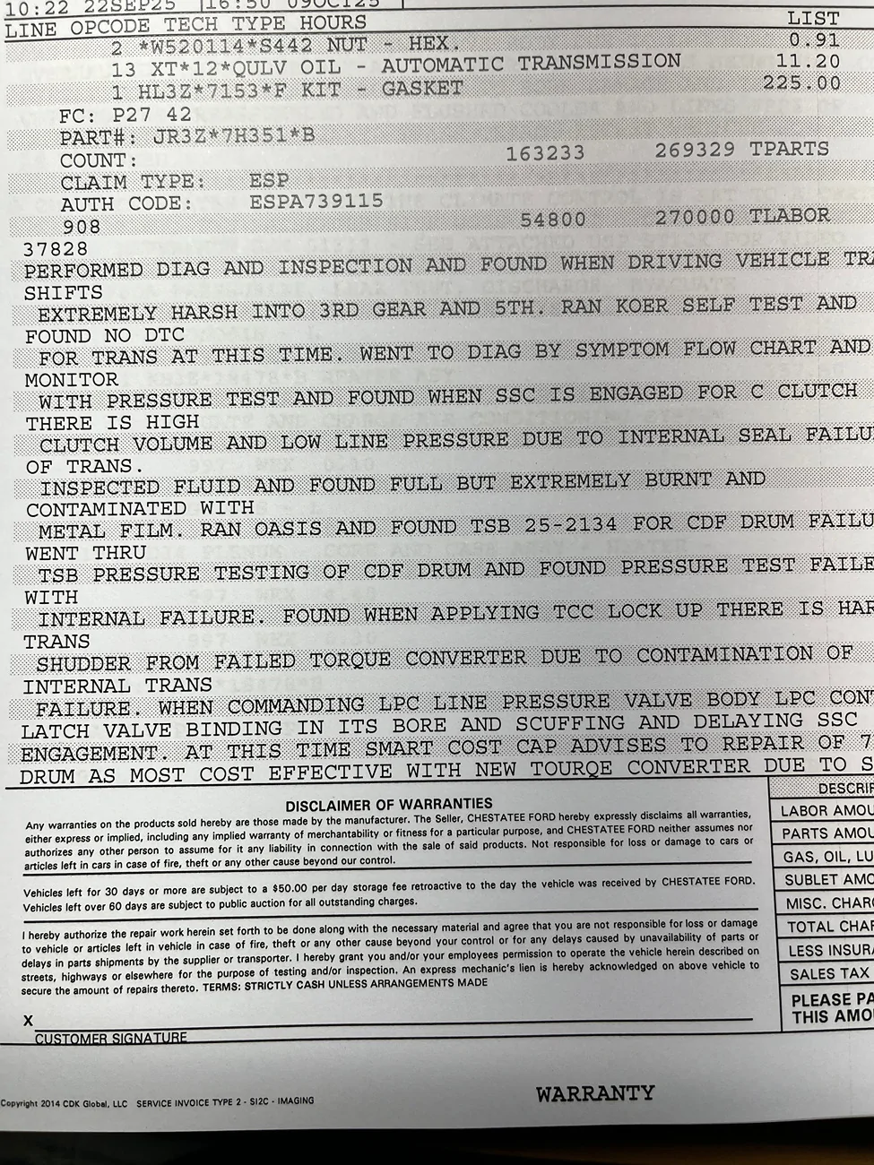

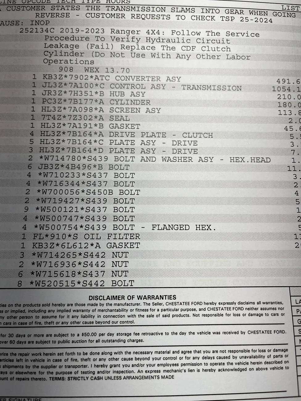

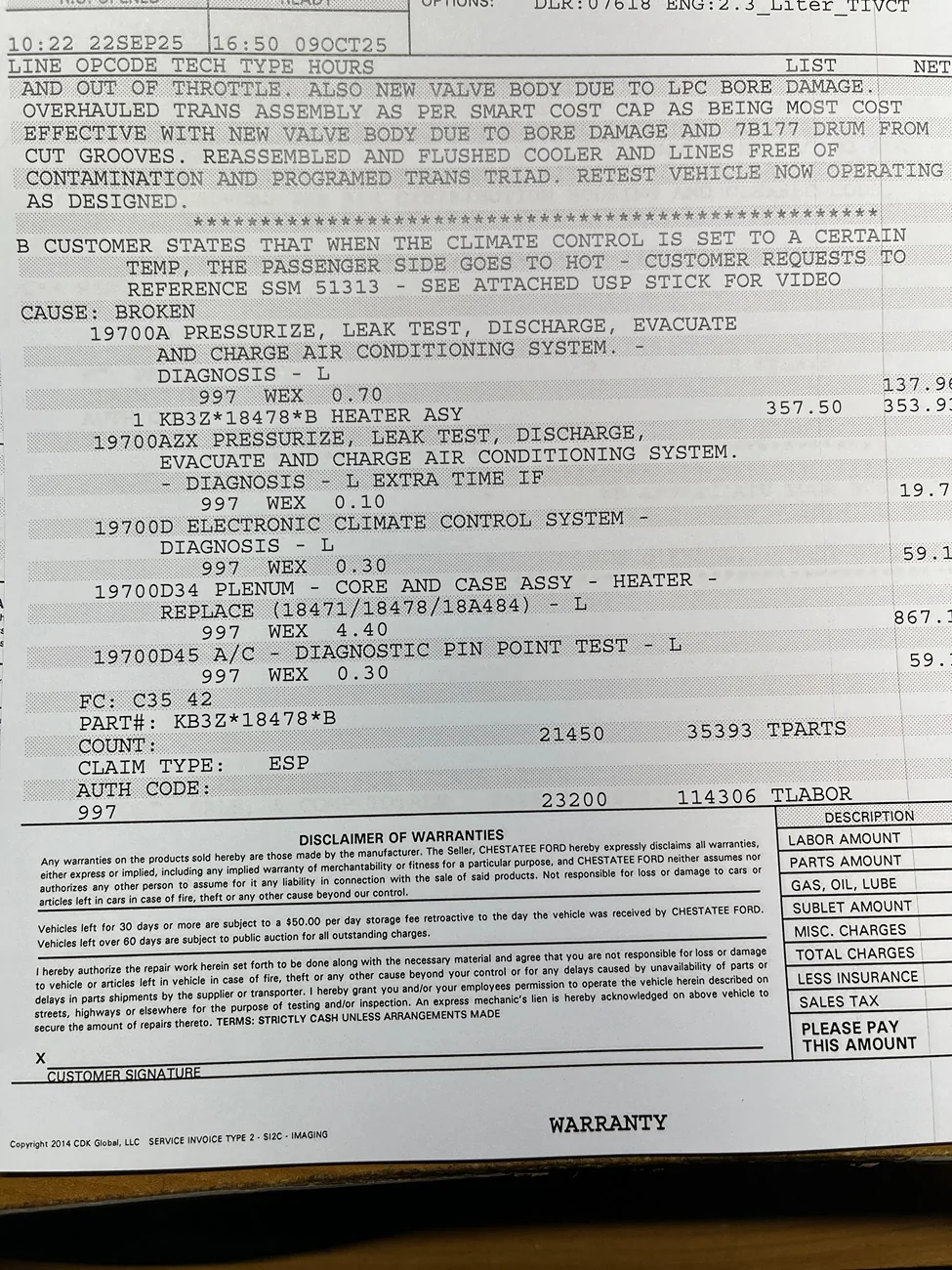

It came back home today.
A bit over $7k repair bill covered by the ESP.
Almost 3 weeks but it seems to have gotten the whole bucket of updated parts.
New CDF, new torque converter, and new valve body.
Plus the new heater box.
I talked to one of the service guys who worked on it and he said the 10R80 is good after all the updated parts are installed.
Great to have it back, though the transmission is a bit clunky. Vastly improved from before though.
I expected that for the first bit as it sorts itself out.
Here's my repair order.
