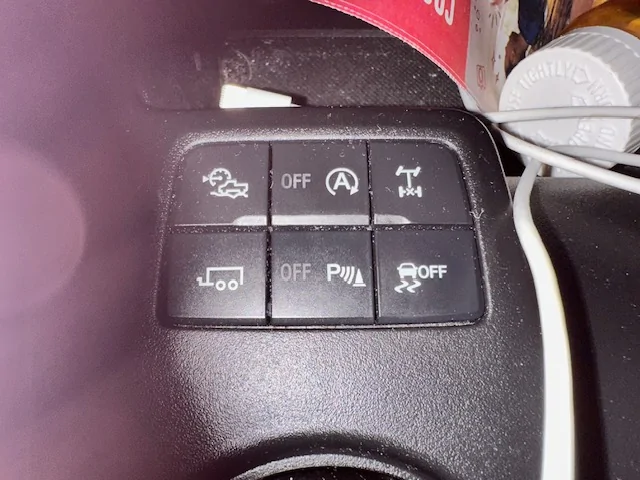

The button in the bottom center with the P turns off the sensors.
I do have that button, so I'll have to try it out next time I'm in cold enough weather for ice to be an issue. Right now, it's too warm here. I'm not sure if it'll be any different than me going through the Lariat menu cluster (aside from faster, obviously), which seems to disable the functionality but not the high-pitched "blocked sensor" alarm.
On my truck it disables them and stops the alarm sound.

Like George said it will disable all the sensors front and back. If you want to try it out press the P and you'll see that the front sensors and rear ones are now silent. But be careful you don't hit anything or we'll see a new thread called "Damn you AZScorpion, I dented my bumper". :oops: 😅

I often find myself reaching for that button when driving into the touchfree wash. Also after leaving the car wash in the winter.

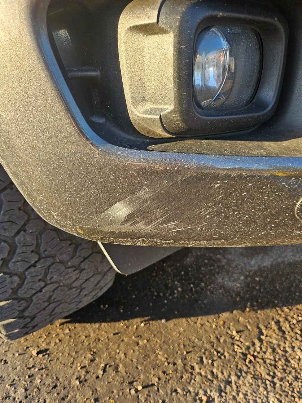

I just had to make a massive swerve to avoid some moron who ran a red light and almost destroyed me. I really need to get that Train Horn installed. My options were swerve and eat a construction barrel or let that idiot crunch me.
The barrel crumpled like a beer can. I was certain that I had jacked up the front end but all I got was a tiny plastic rub that will buff out.
I was Driving along in my '19 Ranger about 25-30mph. This guy is in front in a little shoe box much like they drive in Sicily, packed with 6 people, slams and stands on his brakes. On his right, there is a golf cart waiting to cross.
Thank God and Ford for collision alert and abs brakes. Nothing happened except my pulse rate was through the roof. and a few choice expletives.
Moral of the story, there are mentally challenged (idiots) everywhere that should not get behind the wheel. In closing those scratches should buff out. Look at it this way, you Ranger is not a virgin anymore. ;-)
