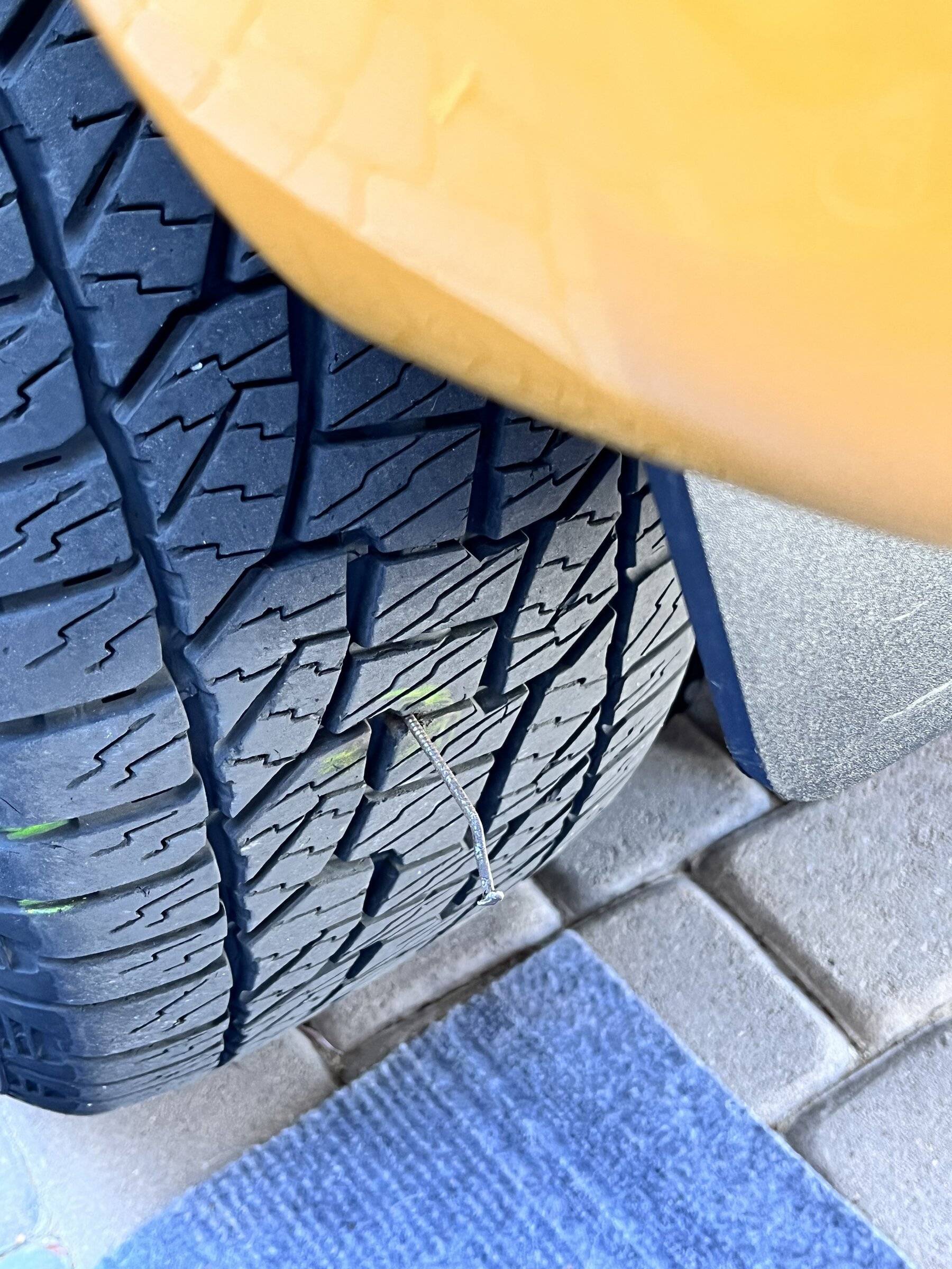

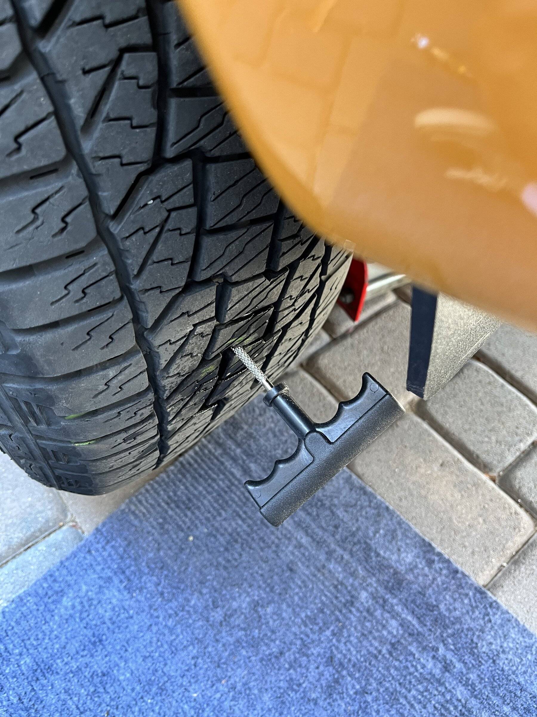

Most tire shops wont patch your tire. It is outside of the narrow "can patch area" dicktated by gov. I would try the plug for a while. If it still leaks go around to some small independent shops and find someone that will patch it on the inside with a combination patch plug.

I've always put a plug kit in all our vehicles trunks for emergency use . While out of state the wife's Mercedes had a puncture in the rear tire in about the same spot as the OP here and the tire shop said they could not fix it that close to the sidewall . They wanted $340 for a new tire so I plugged it right there and put air in it with the 12v compressor that Mercedes puts in the trunk . 40k miles later and she about needs new tires now so it held up fine . I have a plug in my old '91 ranger that is 2 years old and will last until I put new tires on later next year .
For a while my wife's GLA had three tires with plugs, was a dry wall screw magnet. Got new tires after a while, had to save up for $400 Michelin run flat tires.
Used plugs on my Harley and FZ1 Yammy rear tires (not front!) when needed.
All about risk comfort. Some are still wearing masks while in their car...
Be safe!

Remember to check the cement is still good periodically!
Thanks. I'm use to doing that here where everything dries up so fast because of the heat. I'm about to move all my detailing products into the front closet because the garage will be well over 110 through mid September. The tire plugs should be nice and easy to use all warmed up in my truck. lol
