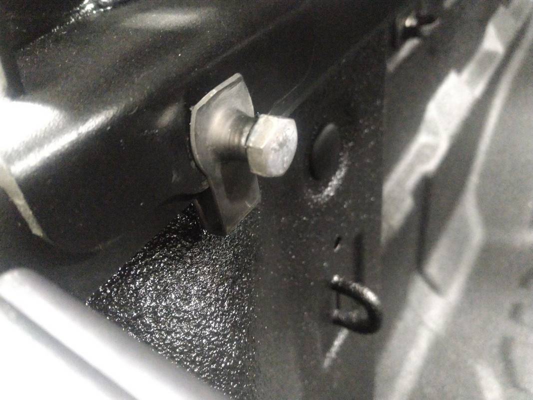

For starters I had to address an issue I was putting off, the rear and front rack attachment points to the bed. My rack is designed for a 6 foot bed even though I originally purchased it when my Ranger had a 5 foot bed. I personally disliked the gap from the rear of the truck that the shorter rack designs left.
The design of the bed walls / rail cap area was problematic on the Colorado. There is literally zero room to slip a decent sized nut on the back side for a bolt and it also gives next to zero purchase for a traditional C-Clamp to even work. I mulled over a few ideas, but what I ended up doing was reversing a thick retainer clip. I drilled not only through the rail cap edge, but also into the inside wall right behind the headlight housing area. I made the hole just a tiny bit smaller than the bolt, so as the bolt goes in it would self-tap the metal slightly. A liberal helping of blue locktite and a bolt long enough to pass through the retainer threading and into the wall of the bed. I am confident it will hold fine in conjunction with the other bolts in place for the rack (6 in total).
It ain't pretty, but it works. I plan to get some bed liner and press it on using a small sponge brush to prevent against rust as well as semi-blend with the rest of the bed.

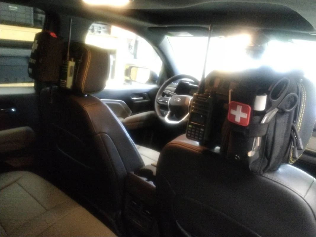

Next up I finally tossed some of my move-over interior stuff in. Nothing complicated. Rigid molle headrest panels with a couple of GMRS radios and a trauma kit and first aid kit.

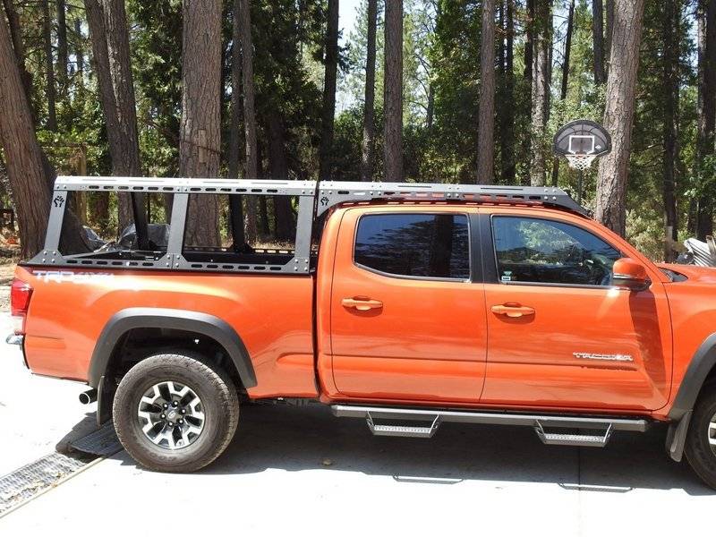

I decided to completely revamp my plans for the over the cab floating rack. I trimmed it back and now I am going to source roof rack mounting feet (prinsu, sherpa, etc etc) and then build my own roof rack with extruded aluminum with a matching height of my rear rack platform. I'll leave a small gap to account for flexing between the bed and cab, but the idea is at a distance it will appear as one uniform monolithic 10 foot contraption. Also with this design, I ditched the 2" riser brackets I had between the rack and top platform and dropped everything down right together to lower the center of gravity a bit.
An example of a similar idea;

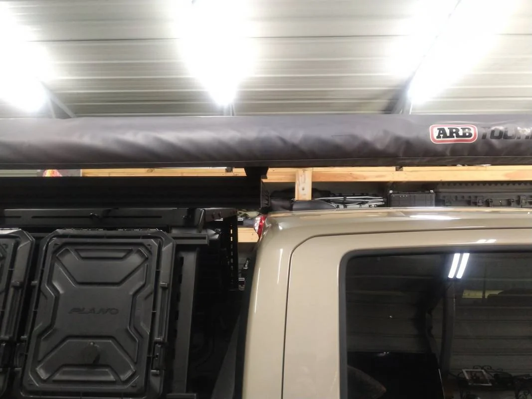

And I got my ARB awning installed. The gray pvc bag is driving my OCD nuts with the tan/black combo of the truck, so I have a universal style black awning bag coming in Tuesday.

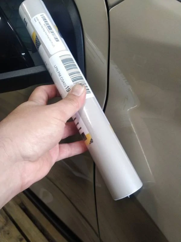

Lastly I ordered some vinyl. This will be for the mirror caps, some DIY door sill protection, and a few other misc things. However color is a bit too light for my liking. Sending it back while I source a darker version.

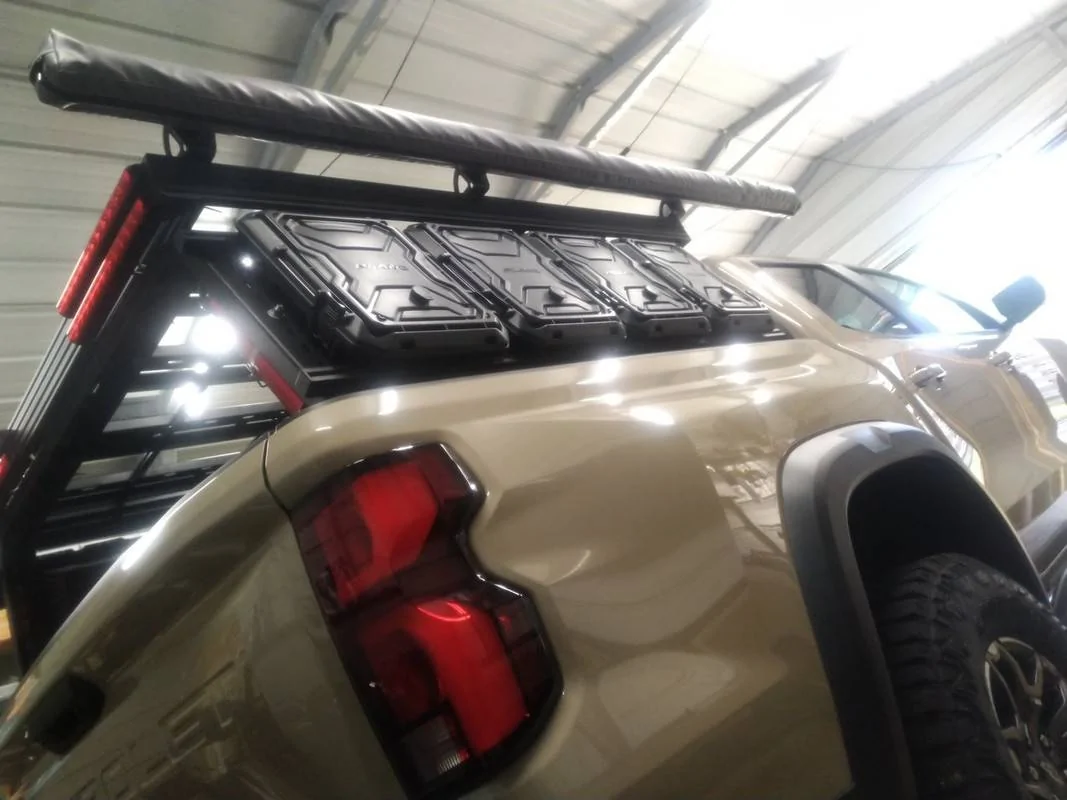

The storage containers are double walled PLANO heavy duty ammo crates. I added cabinet gas struts to keep them propped open and also added camlocks with weather caps. All stuff that you can get via Amazon. All 8 as seen ran me about $300 total if I recall, price might be a little higher now as I set these up something like 3 years ago, so economy and all that.
The two side latches on the ammo crates can be popped off and reinstalled upside down so they release at the top near the lid instead of lower down on the sides.
