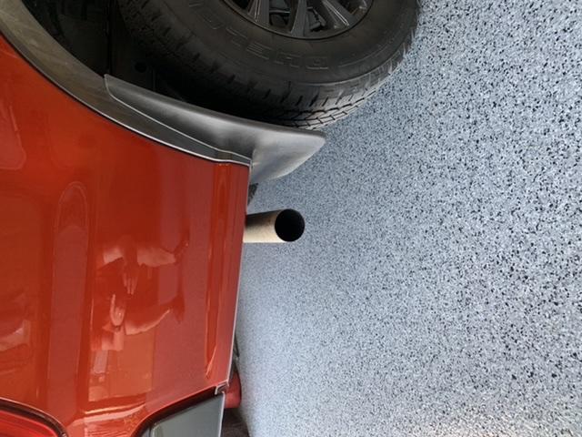

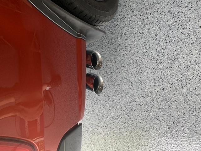

So install is complete. Took a little over an hour. Some things for buyers to be aware of. One there is a pretty substantial shipping charge when purchasing from AWE mine was $62.43 to ship from Pennsylvania to Vermont. Secondly I received a text from FedEx the day it was scheduled for drop off that I would need to sign for it which was an issue since I was at work, lucky my daughter was able to be there.
I did remove the little heat shield next to the spare tire to facilitate removal of the stock exhaust and for only two bolts I would recommend doing that. Another tip is to use some dish soap to help lubricate the OEM rubber hangers.
Last suggestion is to use an air gun to tighten all clamps. I was unable to properly tighten the tip clamps using a 3/8 ratchet. Very happy with the sound is has a nice tone and is quite in the cab even with the window down and the radio off.
Dave feel free to chime in with any info on my install challenges.
