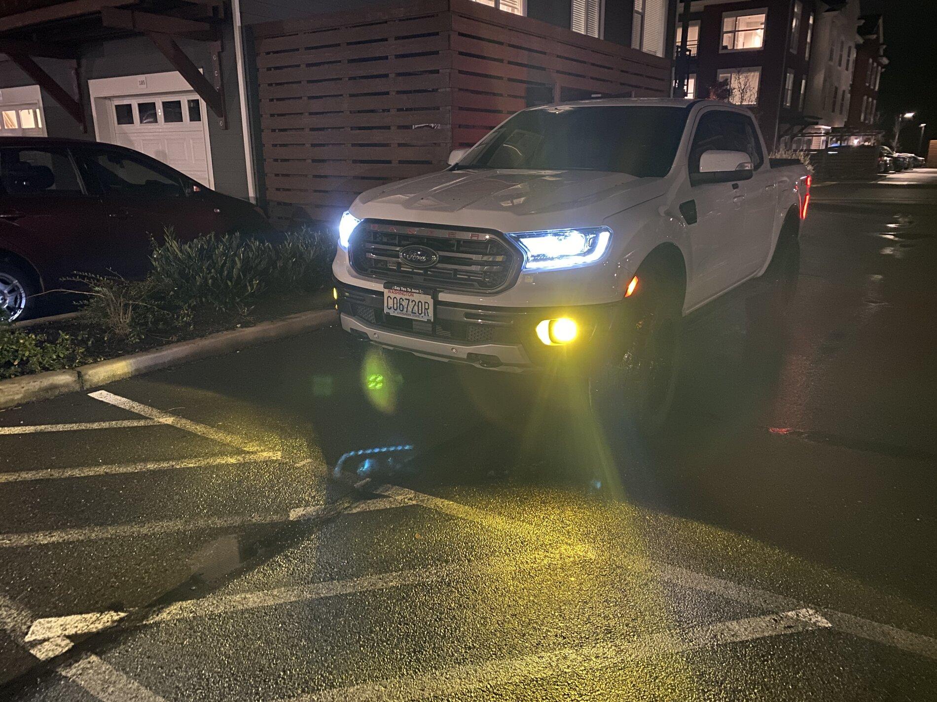

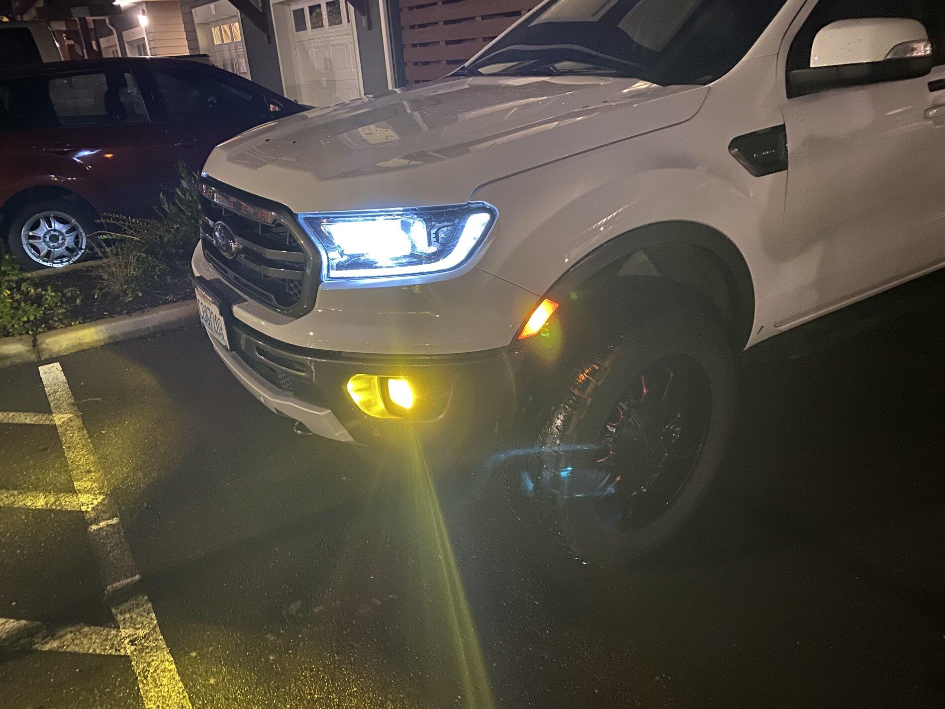

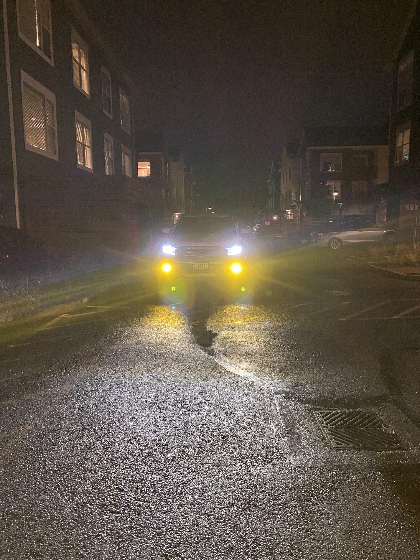

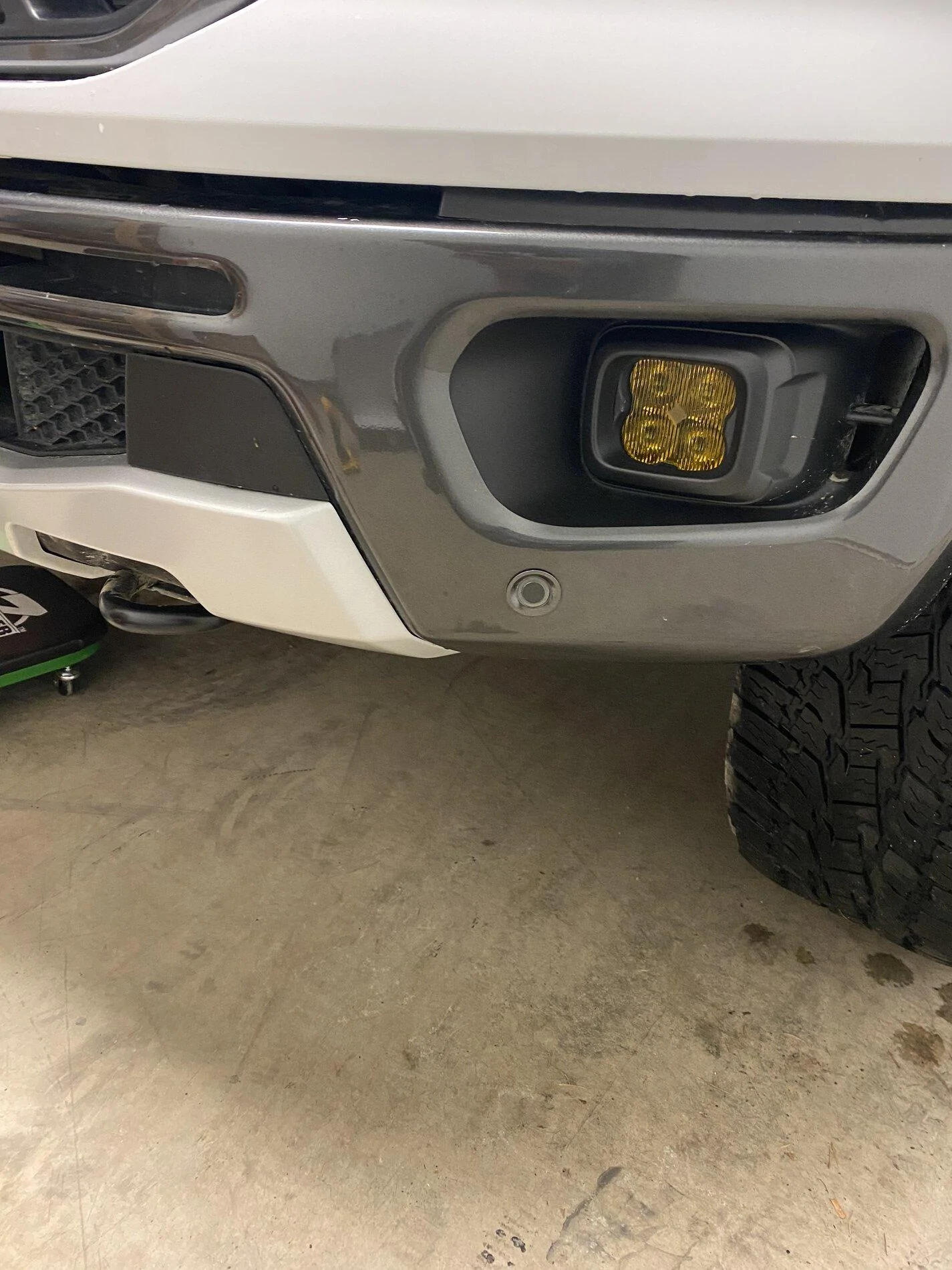

I just installed the DD SS3 Pro Fog lights but I’d like to figure out how I can keep them on when my high beams are both off and on and obviously also while my low beams are on. Has anyone figured this out?
