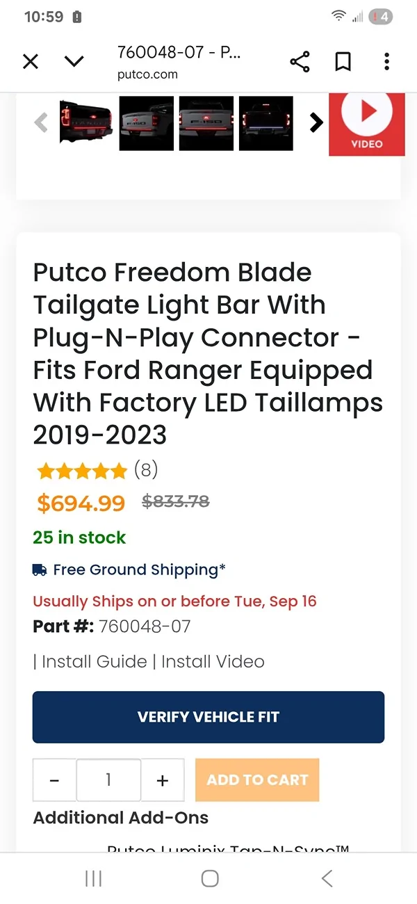

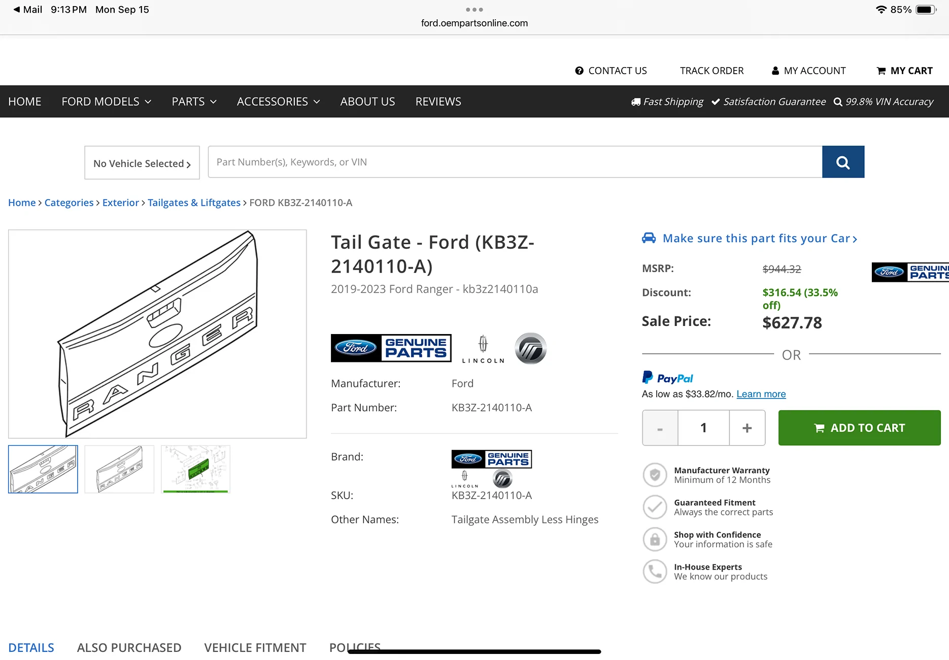

How on earth does a tailgate assembly cost less than this thing? :facepalm:
I'm not familiar with the Freedom Blade. The one I've always used is just called the Putco Blade. The red and white one was the only one that worked properly wth late-model Fords when I sold my business back in 2021, but maybe Putco solved that problem since then. In any case, this one (while still expensive) is a lot more affordable than that Freedom Blade and there's one even more expensive than that. Neither of those existed when I was selling these bars.

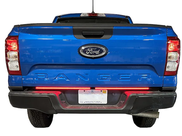

Putco blade only works with halogen taillight.
I'm wondering if that is why some work and the LEDs don't.
OEM LED Taillights is an optional configuration for the Putco Blade. It's P/N 9203048-07.
