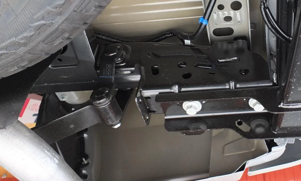

Still, lowering the rear on the new Ranger is going to be a trick.....and expensive.
And on this we agree.
I'm betting though within a few months there will be replacement springs available, that are de-arched.
That’s not necessarily true. We’ll probably see some lowering shackles come out eventually, and they won’t be that pricey.
The “when” is the issue at this point.
Maybe if they are "Jack's Magic Beanstalk Shackles".... There's no room to shorten the shackles enough to make a significant change on our 2019 Rangers.
Supposedly, there's a couple of 1" drop shackles in the works, so while not "significant" they may be a future option for folks to reduce rake a smidge.
