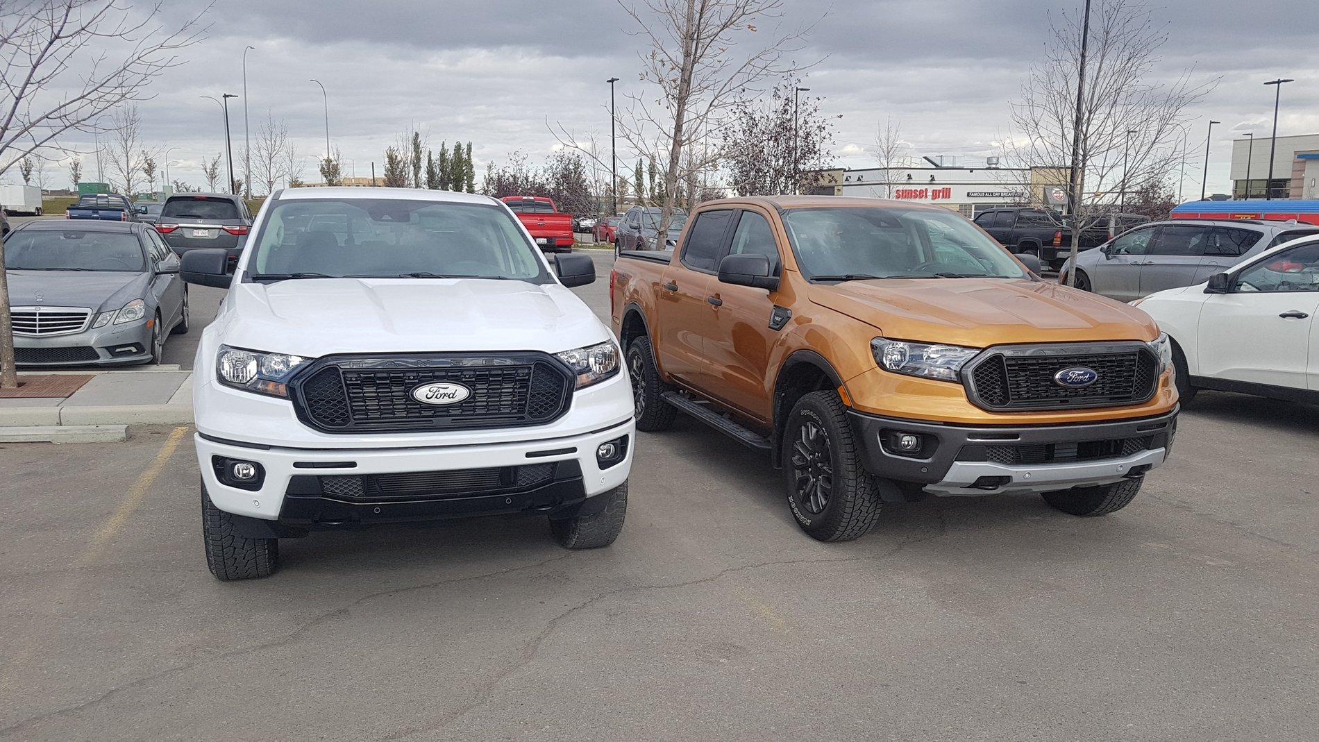

Finally saw another Ranger roaming out in the wild here in Calgary. I've had mine 2 weeks now. Couldnt be happier! The only other I saw was the one with dealer plates being test drove that led me to the dealership about a month ago.

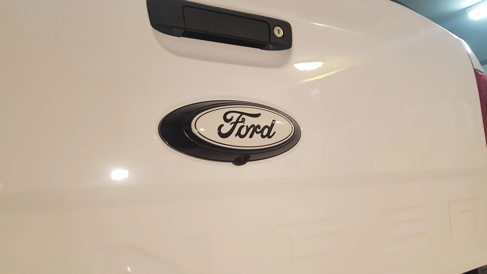

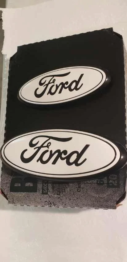

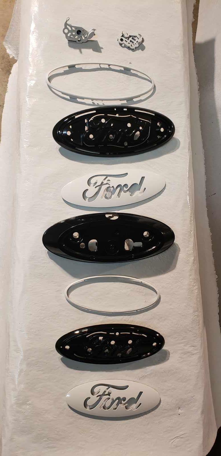

I actually unassembled the existing logo parts and spray painted them.
I did the rear as well.
I was really nervous experimenting with this on the brand new truck, but it turned out pretty amazing. Here is a video of what is involved.

Thanks, it looks great! Was it pretty easy to get them apart?

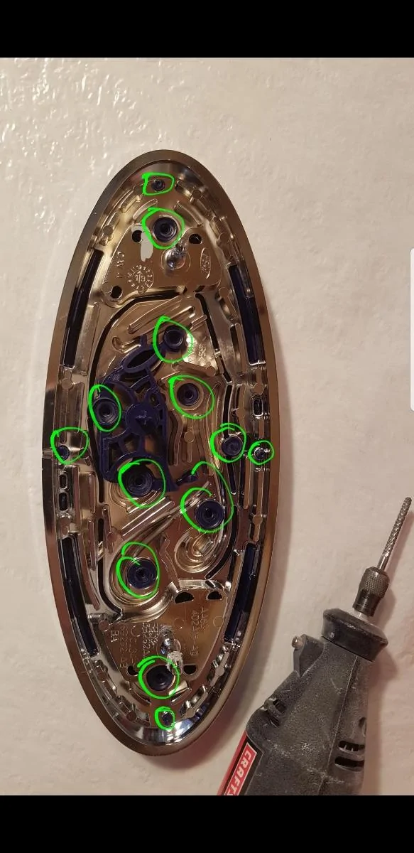

Getting them off the truck was fairly simple. The front one has two bolts(10mm) holding it from behind that you get at from under the hood. The tailgate one just pop off the smaller oval carefully with a couple plastic pry wedges and then under that are two bolts(7mm) that hold the larger oval around the camera. Drilling the plastic rivets like in the video above would make a gut wrenching crack noise. I counted 12 or 13 plastic rivets to drill so I ended up using a small dremmel tool for some of them because I felt like I had a bit more control.
