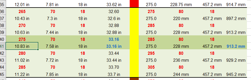

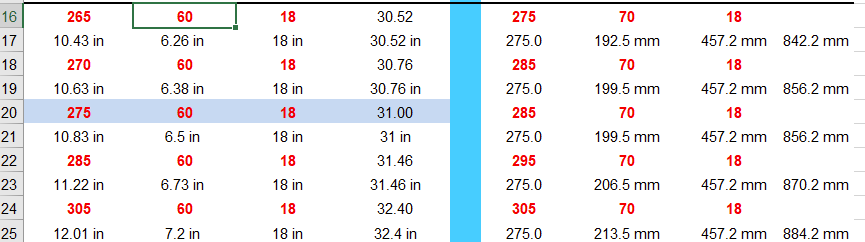

Sillyguy96...
OEM is : 265x60R18 offset 55mm
So only 1/2 taller.
As you did not state the wheels to be used (OEM 18" or after market with no OEM offset), with the OEM 18" wheels, I would guess the 1/2" will not matter. I have 18" OEM wheels with Blizzak winter tires of 275x60R18s no problem...
I went with 275/55R20 offset 25mm Fuel 20x9, no lift (all OEM) but had to do the crash bar mod but still on a hard turn slight rubbing...
