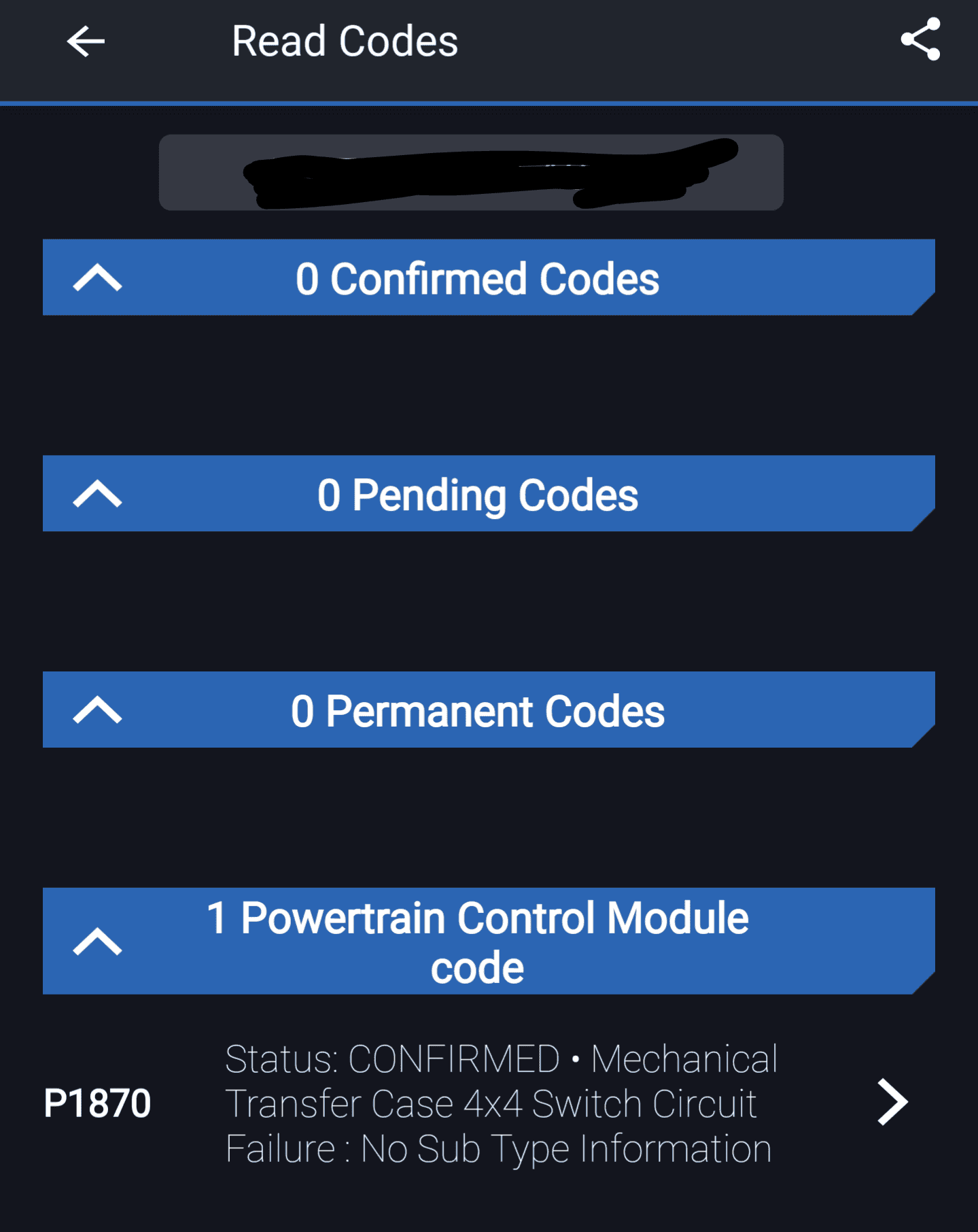

I did search for codes and tested in neutral to determine if the clunk and stutter were related. They appear to be independent issues. Under no load it still stutters at 1,300 to 1,500 RPM.
Also, I did find the below code, wondering now if my clunking is transfer case related.

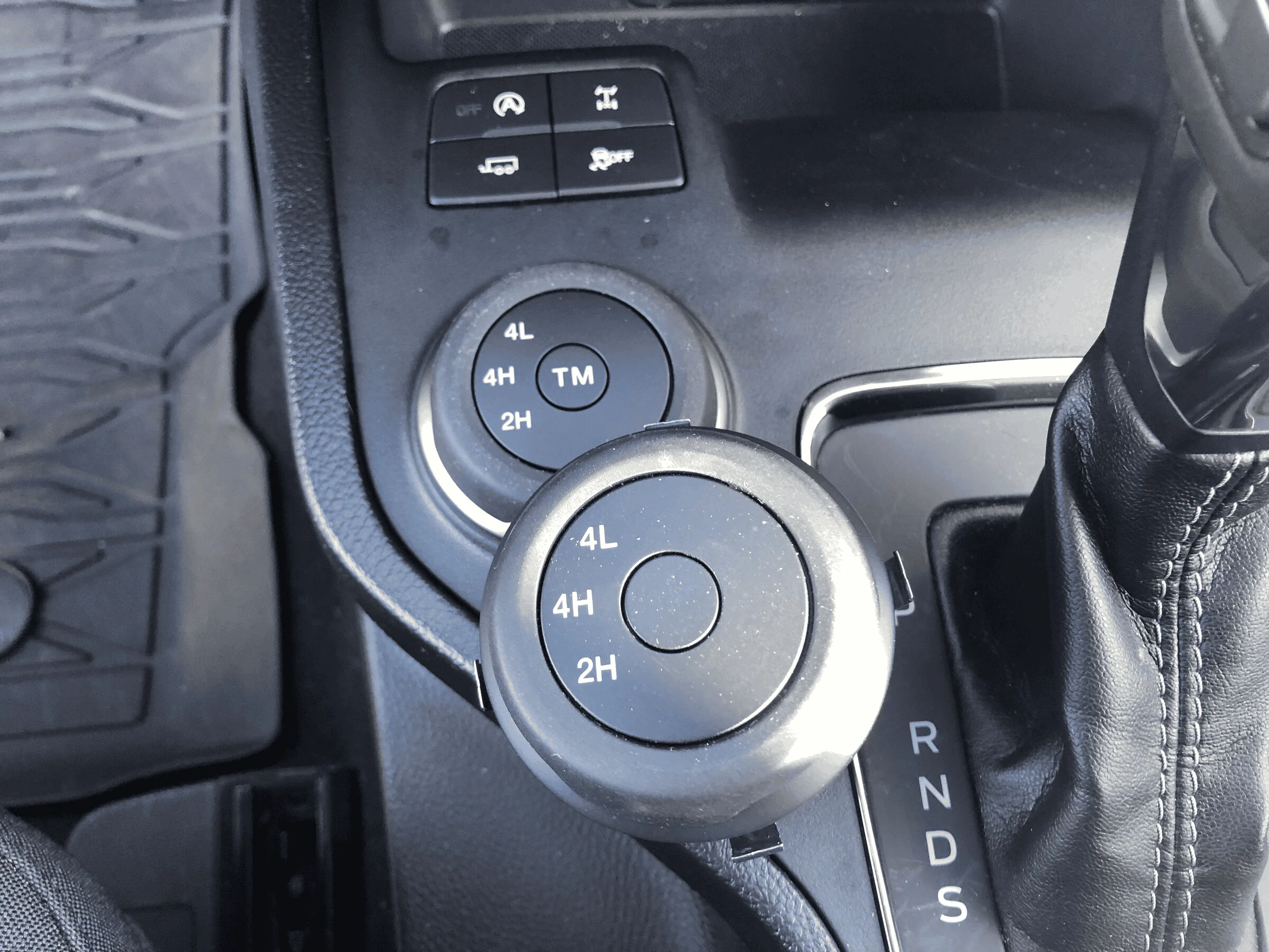

That code is for the Switch and or Circuit Wiring - (Rotary Knob)
Does it switch between 2-HI, 4-Hi and 4 Low?
And if it does how noisy is the transition?
This may be the source of your Clunk; it might be getting lost as to what drive mode it is supposed to be in and self-shifting between 2WD and 4WD (High) if it was 4WD Low, you would definitely know it.
And just curious here, since adding the Terrain Mgmt. is a popular mod, if not part of OEM package
Does the TM switch function, and can you select drive modes (viewed on IPC)?

Thanks @airline tech no other noises outside of what is considered "normal."
Terrain management is OEM and displays properly.
