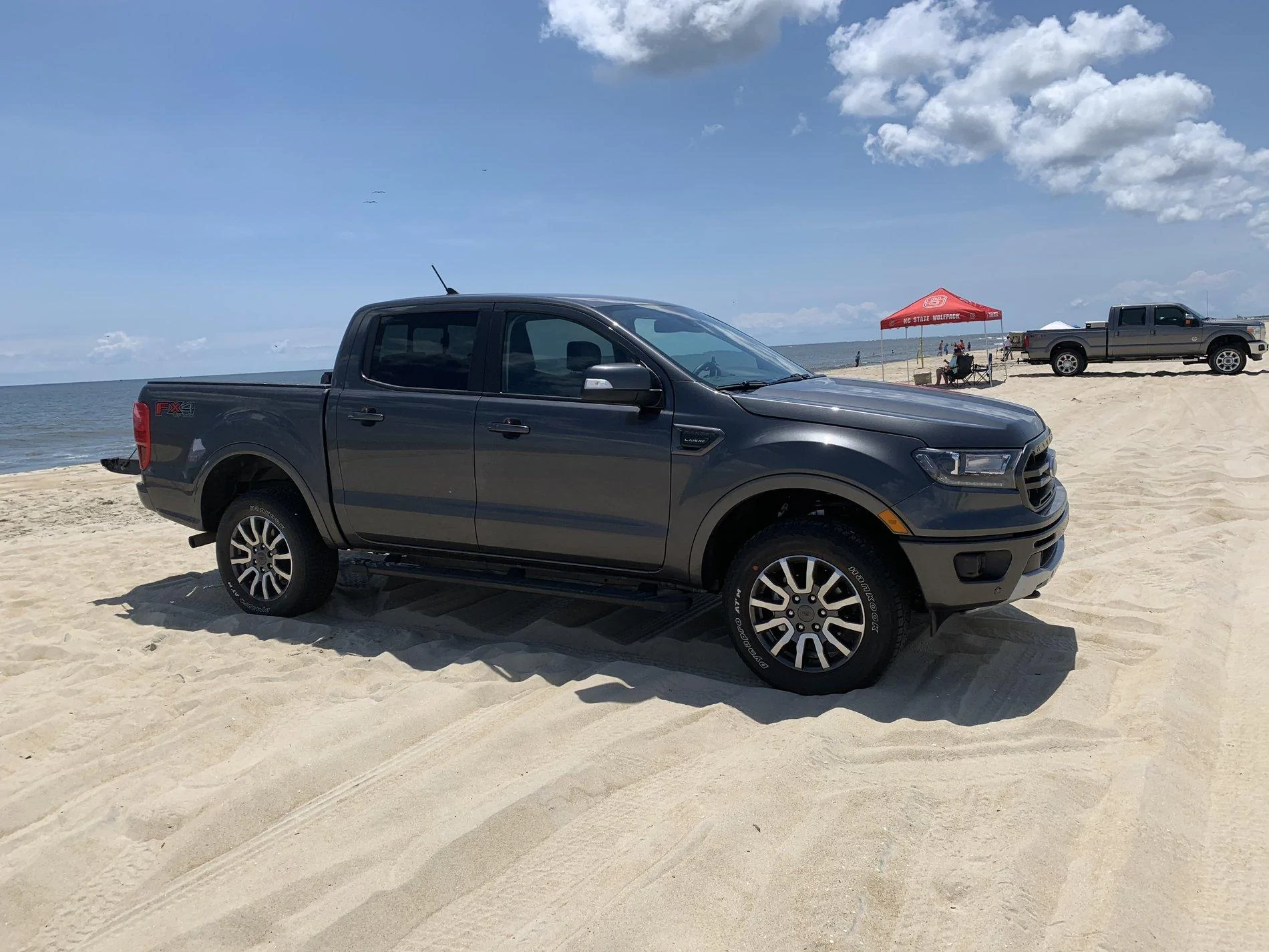

I have had my ranger since 5/11/19 and already put close to 3500 miles on it. I love it and it drives great. I am actually vacationing in the outer banks as we speak. We drove on Corolla Beach and today we are driving on the south side. When i got out to deflate my tired i turned the engine off and when I restarted the truck the check engine light was on. Is there any dignistic tools on Ford Pass or on the dash board instruments. Im just guessing that it maybe something to do with being in the sand. I had a 2012 jeep grand cherokee and those had issues with sand mucking up some of the awd computers and such. Suggestions?
