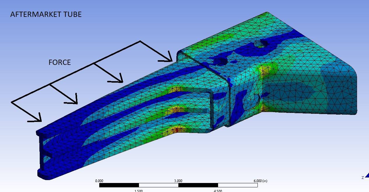

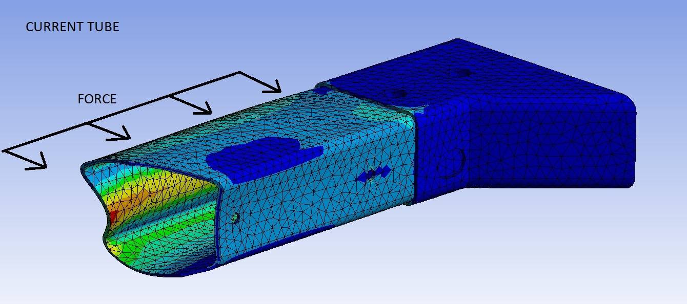

The first test run I did was with the beam that comes on the truck. The tube seamed rather light and is very thin material. Looks to be about 2mm thick wall. I applied loads to the entire back side of the tube that sticks out and kept adjusting the load until it passes a typical static stress analysis. I ended up coming up with a static load of 1150 lbs, which put the beam right on the edge of passing a load test. This is just a static test, not a dynamic test.

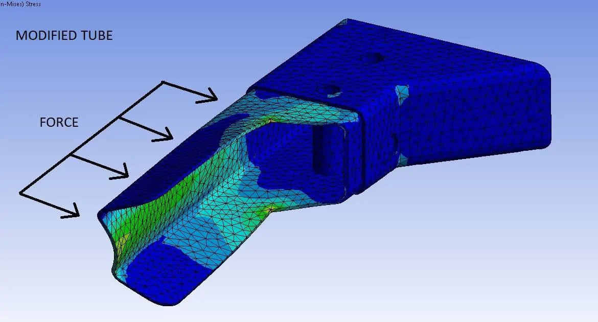

The second test I ran was with a modified crash bar or tube. I've seen a lot of people cut the tube back by about half the tube width. So that is what I did. I results were way worse which I expected. By removing the front side of the tube, you are removing a lot of the tube structural strength.
The results I got were complete failure at 1150lbs. I was only able to get it to pass at around 500ls which is a bit less than half.
The third run I did was with the aftermarket beam (I don't want to say who again for legal reasons). This beam was much narrower and cuts back enough to clear the tires. The beam were ALOT heavier. The wall thickness was almost double that of the OEM beam. There was also a middle rib that really helped add support. The results were pretty surprising. I was worried because the beam was a lot narrower that would be an issue but it wasn't These beams passed the load at 1150lbs by almost double. I was able to increase the load on these beams to 2000 lbs before they started to approach the danger zone. So by simple loading, it seems that the aftermarket beams were better than the other two.
Again, please understand that I do not recommended changing or altering your vehicle in any fashion. But I would say that it is defiantly safer to put an aftermarket beam in over modifying or removing the beams all together. Any engineer would recommend not removing or moding the OEM parts at all.
Take this for what it's worth. I thought the results were pretty interesting. And please don't make decisions based on what I have shown here. Your car or truck is your responsibility, and I take no responsibility for decisions you made from a web forum. I don't want anyone to get hurt or worse because of something I posted on the internet.

I have a few hesitations with your results. At a first basic question, what materials and parameters were you modeling with?
1) Dynamic analysis is what's really important here though, since deformation includes other effects that aren't well-behaving in the classical sense: buckling, heat dissipation during impact that affects strength, etc. This is quite complex and can't be captured with simple CAD FEA...so it's unclear if your results mean anything in the real world.
2) This isn't super surprising: strength is related to the area cross-section moment, even removal of a slight bit of material far from the bend axis/plane will make a large difference, since that material's moment contribution goes as radius squared.
Similarly, even a slight increase in thickness will yield large improvements -- or slightly increasing size.

Just want to clarify.
This was not actually tested, just a computer model?
While it's good to know we all would have guessed that by simply looking at them.
Some actual destructive testing would be more helpful. Albeit more expensive.

HI Brian,
Having lead a Chassis Design Analysis area in Light Truck Engineering for quite a few years, I have to say Kudos for your analysis, but they mean very little in the world of Crash Analysis which in non liner, non static. Radious was the software at the time to do crash analysis. It took many hours on a Cray C90 super computer of which Ford had two of these water cooled super computers. I am afraid your effort, which are laudable, might misled folks on the affect on the crash pulse into the interior of the Ranger cab.
I am uncertain in the affect on the crash pulse into the cab from non OEM bars... I fear it may actually result in a non optimal result..
So this is not misinformation but does not present the conclusive data that is necessary.
What meshing program did you use? Where are your spc's? Where are your spring elements? The frame is not an SPC. Any fatal errors in your first Mesh?

OK folks, I do state several times that this was just a simple static load test to show the strength difference between the three beams. This does not represent a real world crash test and that a full dynamic analysis with all the real world data and a full working model would be needed to supply that. I don't have any of this info or models to do so. With that said this was just meant to be a fun little experiment.
So please understand that the info supplied above should be taken with a big grain of salt. And yes, this was a computer simulation only.
