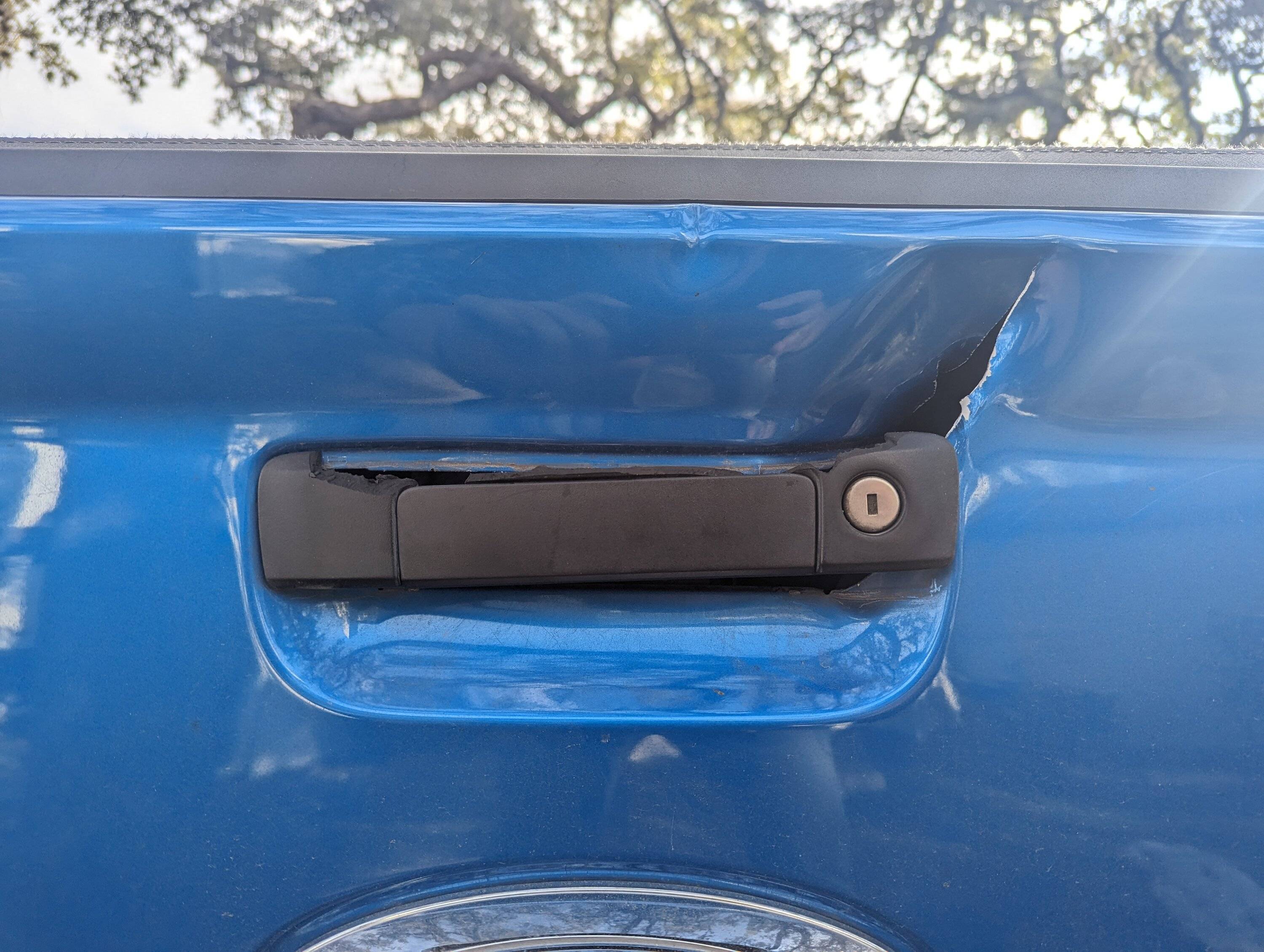

So last night/this morning, i became a victim of stolen tail lights. It appears they used a screwdriver to punch thru the aluminum skin under the tailgate latch to open the tailgate. Already have insurance involved and the truck is at the dealer for a quote.
Who else has joined the party ?
They got me last night too. 2021 model, the front lights are not LED on my XLT model that year or they'd probably want those too.
I looked them up and new ones are $300-500, but there are many on ebay for only $150 each. I would have let them have them and I'd just buy old ones off ebay, but F@#$%ing up my tailgate? that makes me mad!
Now insurance is involved, deductible, etc, and all just for crackhead money!!!!

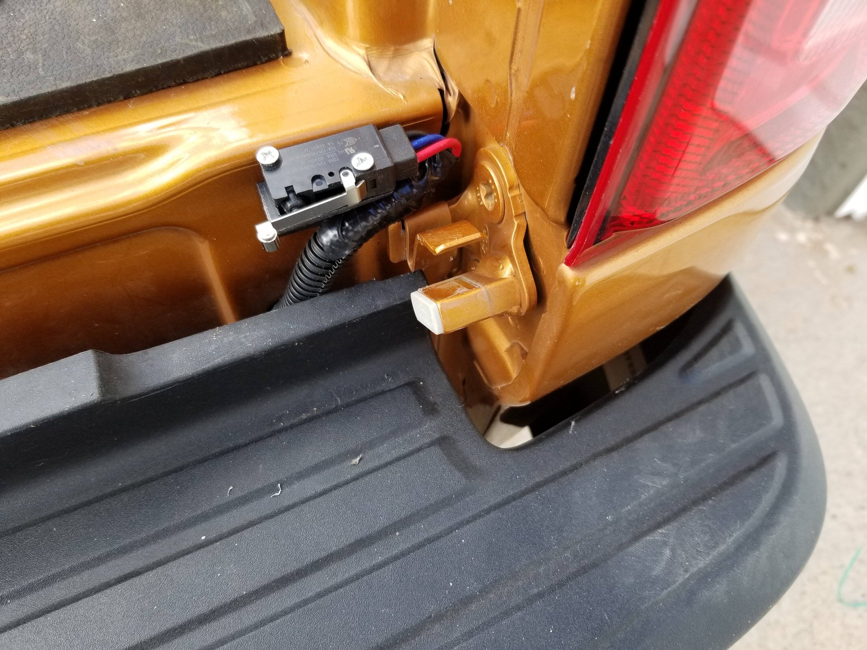

I wired in series with the hood sensor that notifies that the hood is not latched and also sets off the Ford alarm system, and notifies through the app. Installed a weatherproof micro switch on the tailgate. Also did the security screws.
Nicely done...
