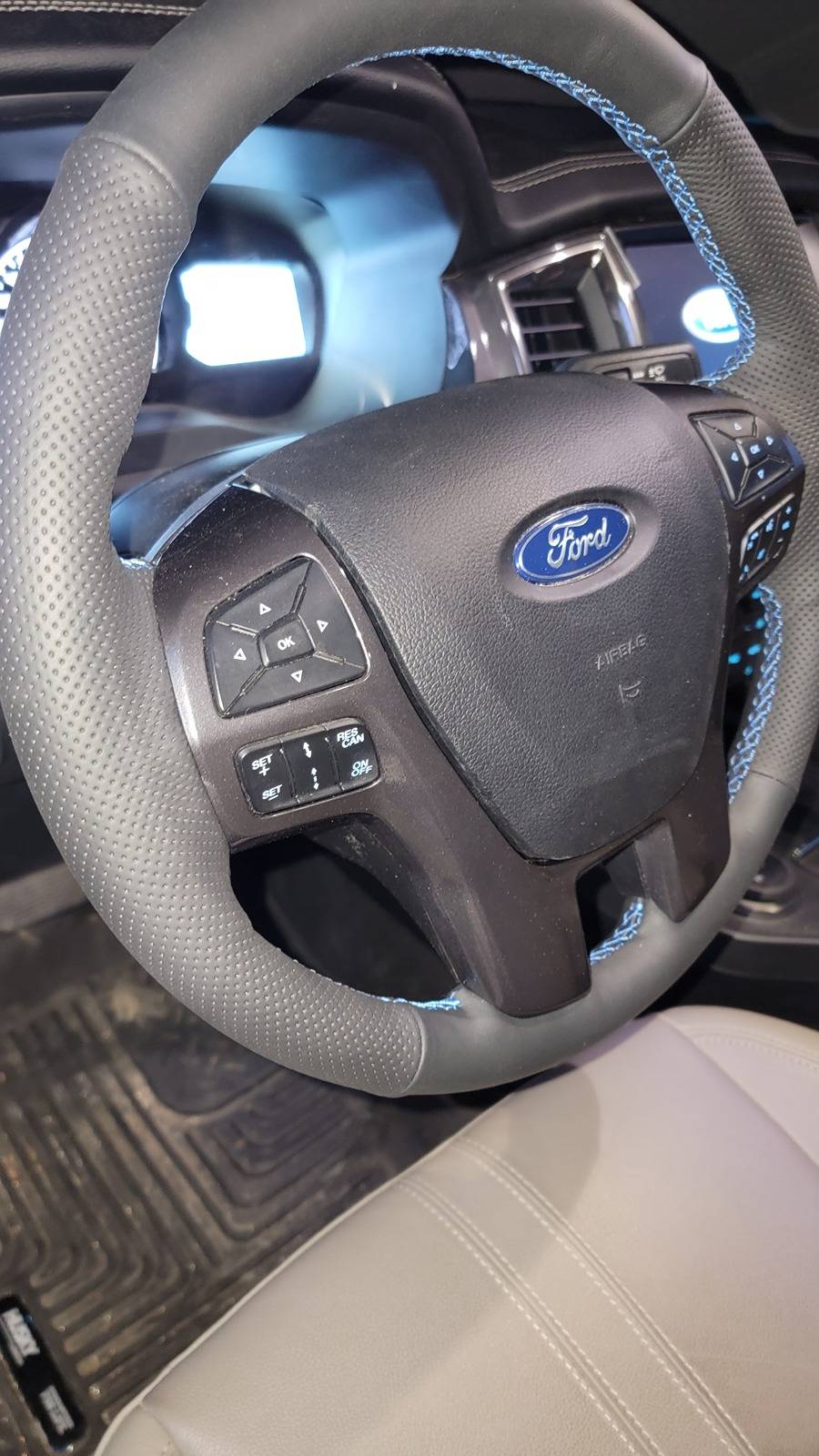

98% sure the naked wheel is the same. The plastic "trim & controls" you will want to swap as the connections for the AMIP, etc. won't have the corresponding connections through the clock-spring.
I have a 2019 Lariat and the "leather wrapped" wheel had a terrible feel to it. Got a second wheel, sent it off to have it properly leather wrapped... a world of difference... notice it every time I drive the truck.

I like that steering wheel. Can they do that to a plastic steering wheel? Who did the work?

What did this cost if you don’t mind?
