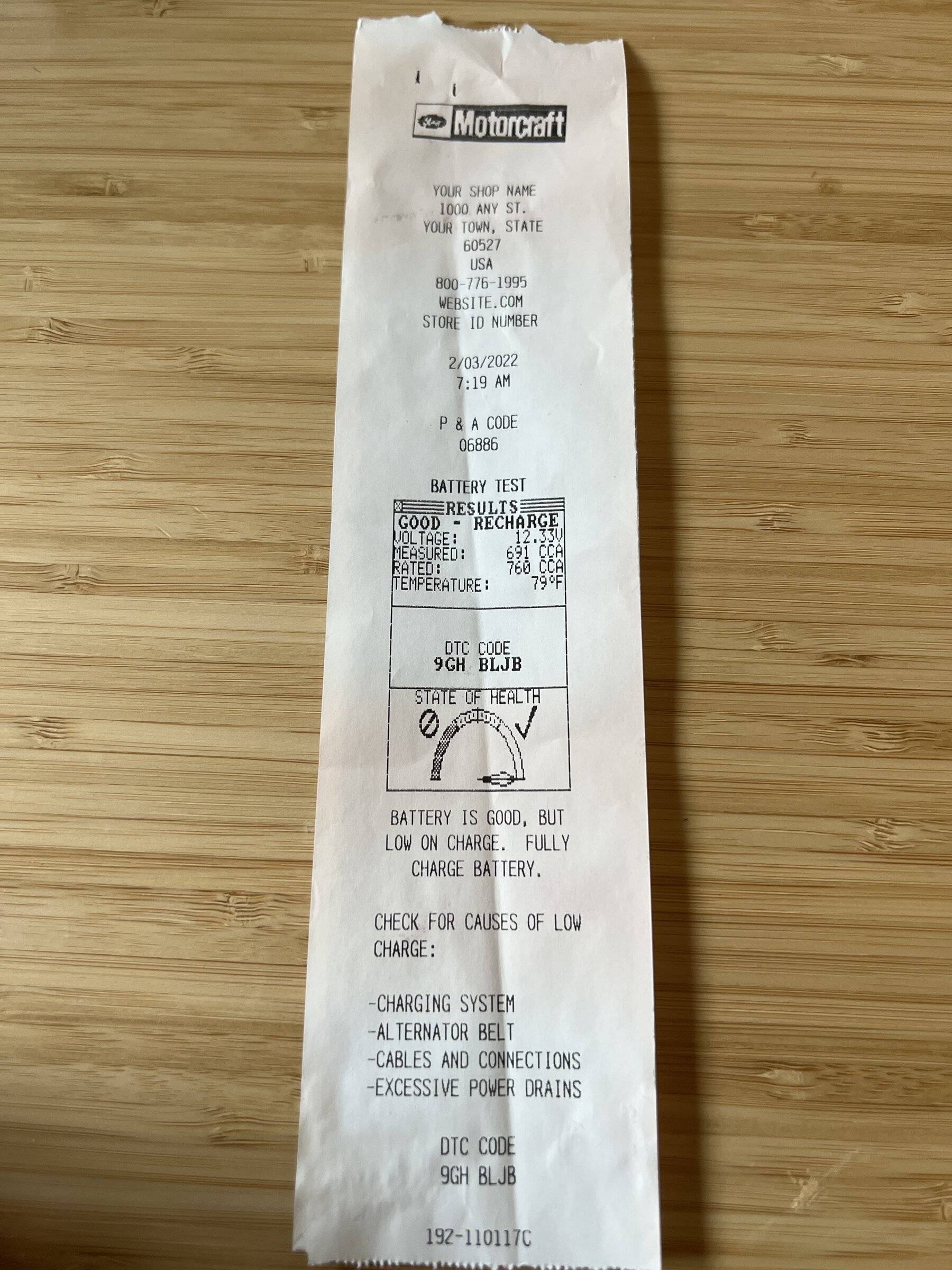

Took it to the dealership yesterday and they said everything looks fine. They tried to duplicate the issue with remote start but couldn’t. That’s what the service paperwork also said. However I did find a battery health printout in my cup holders that they didn’t mention to me or mentioned in the paperwork.
You guys think a low voltage would prevent the electronic steering from working? Also what does a steering wheel with no power feel like? Would it feel like the steering wheel is locked up? Or would it still turn but just really difficult? Maybe that’s why it self-resolved after like 20 minutes? Because the battery had charged up
