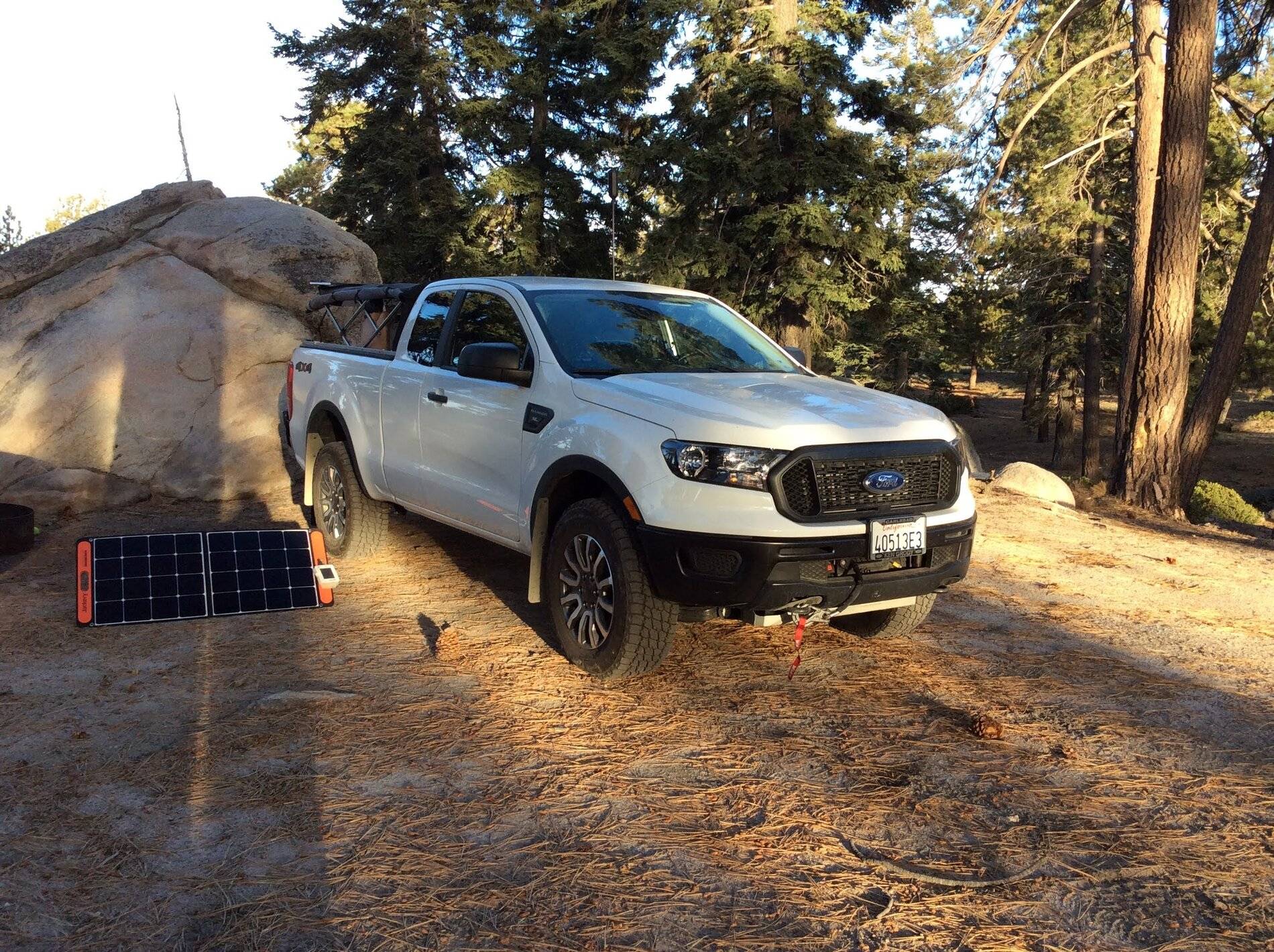

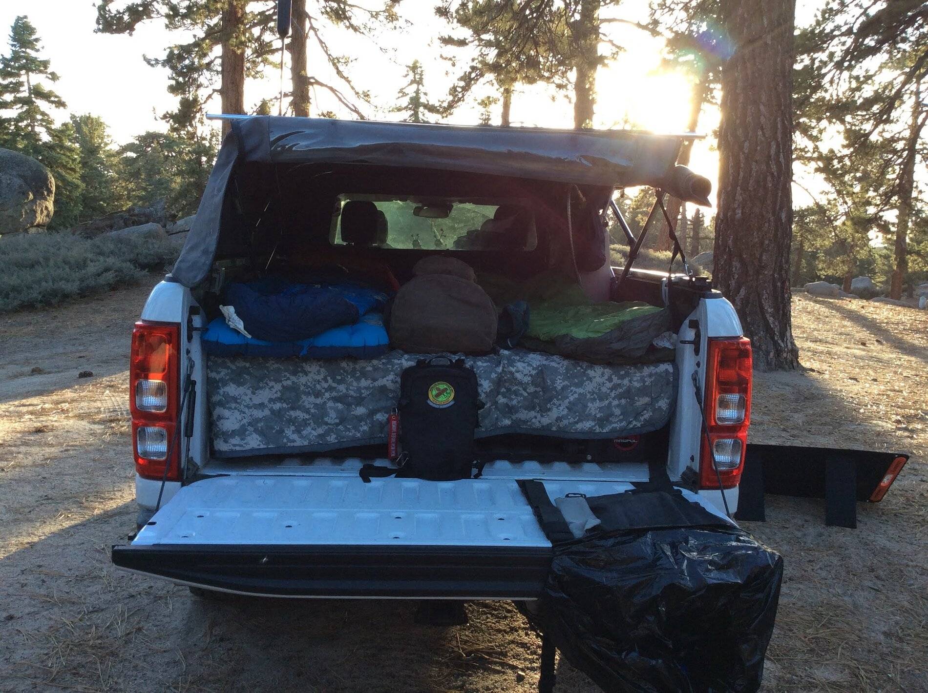

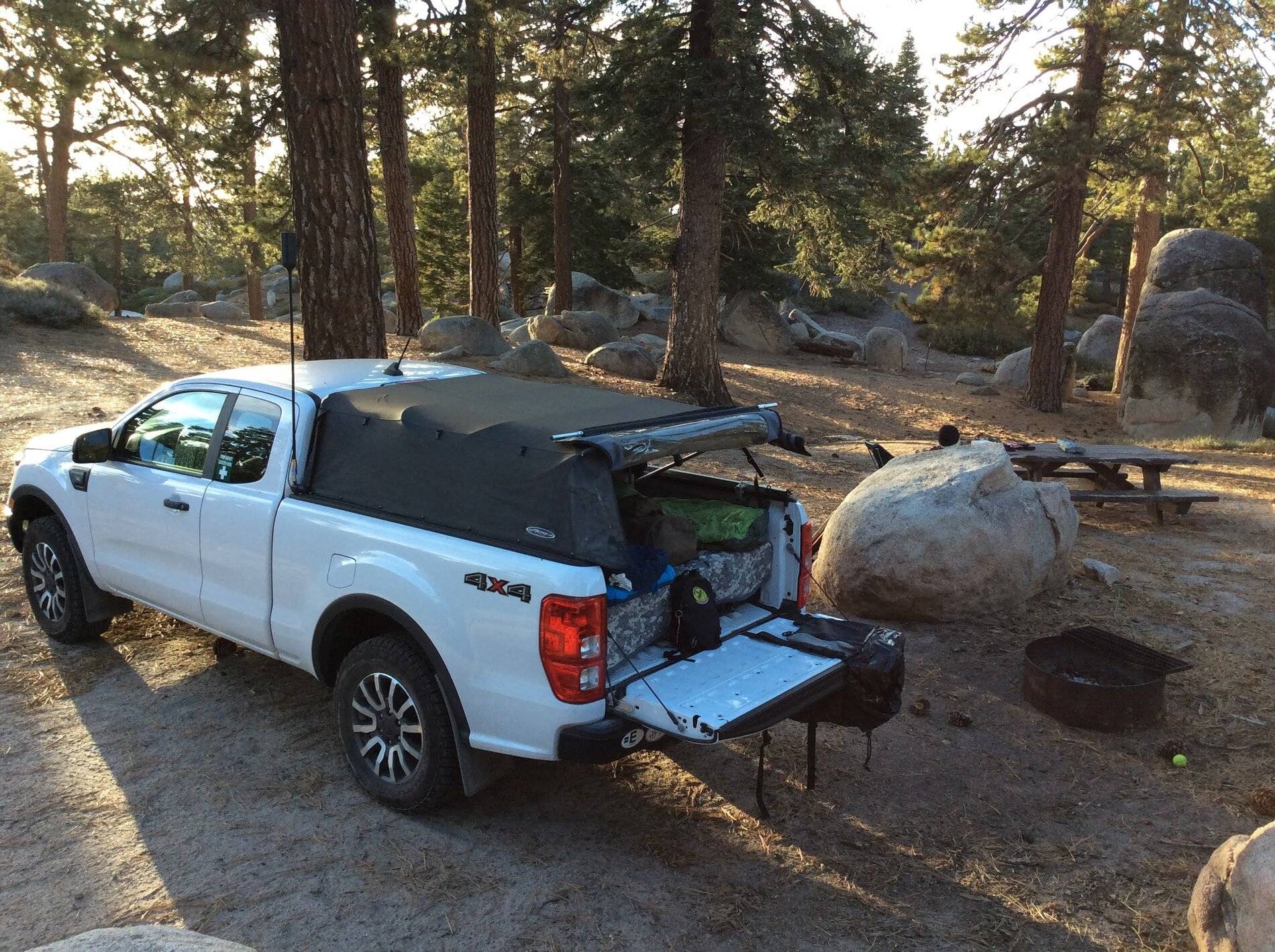

Here are some pics of a recent winter outing with the Ranger!
Spent some time out in South Shore of Big Bear Lake in CA.
Great time to go right before the first seasonal snow-fall

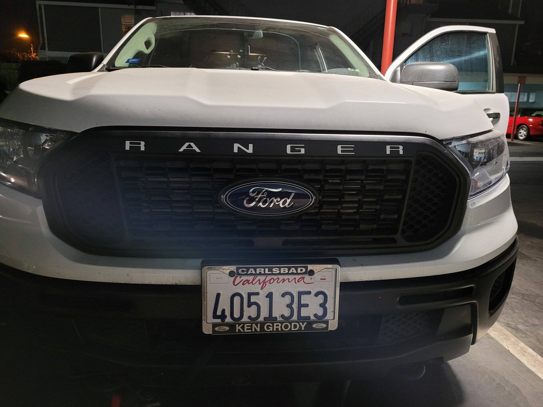

The end state of this build was originally to go for a 4Wheel Camper Fleet model, but the cost and trying to make the weight work with occupants and fluids; I've pivoted to a more obtainable option: the Go Fast Camper. There are a few guys on the forum who have them on the supercab's; they look rad!
End of 2021 mods are LED swaps for the bulbs and white Ranger lettering for the grill.
After that it's honestly dialed in which is a far cry from my classic rover ownership.

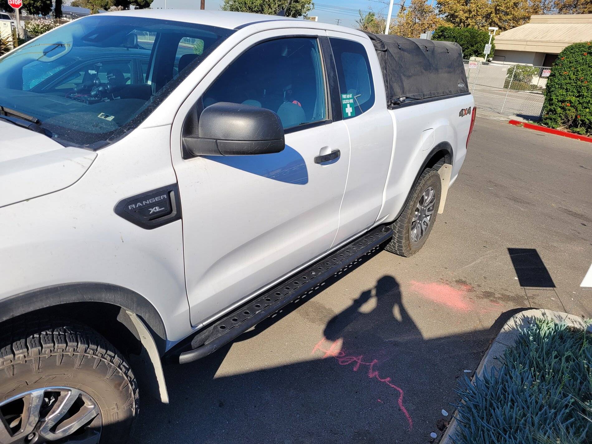

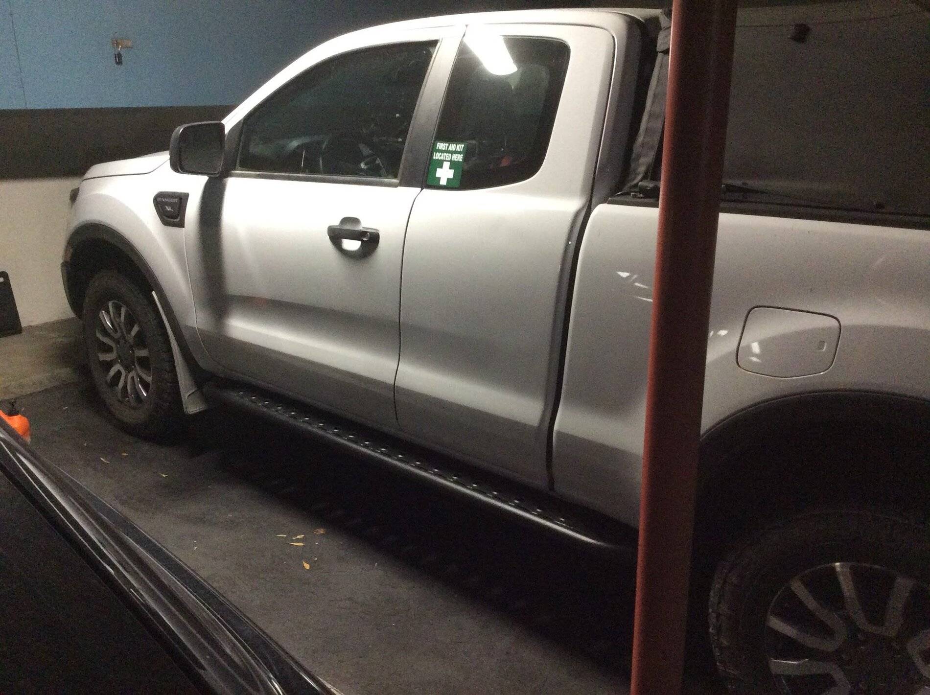

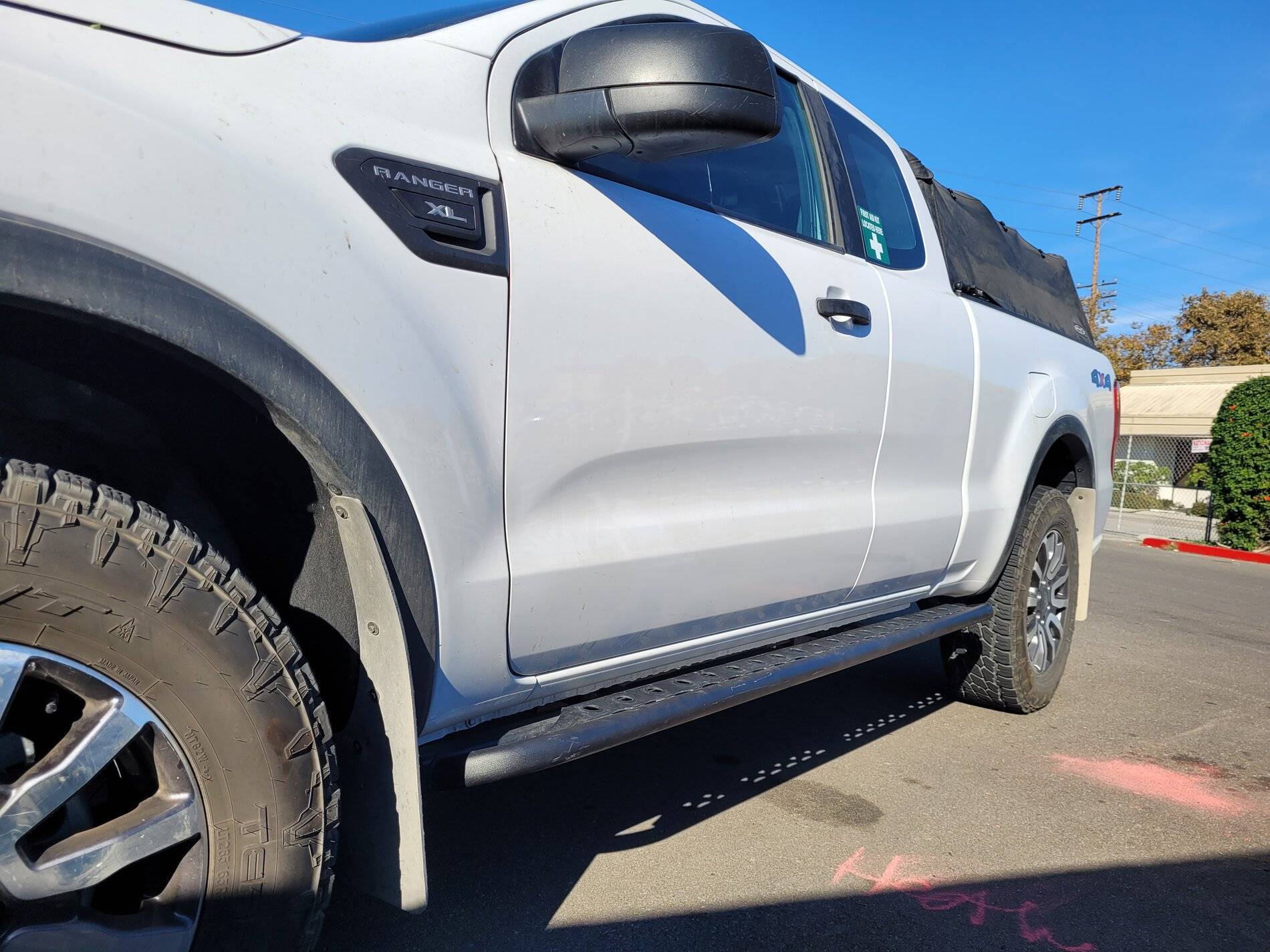

As promised, here are some daylight pics of the rock sliders:
Looking forward to getting these bad boys scratched up! Feel more confident taking Steelie Dan on aggressive trails with the undercarriage and frame protected now ??

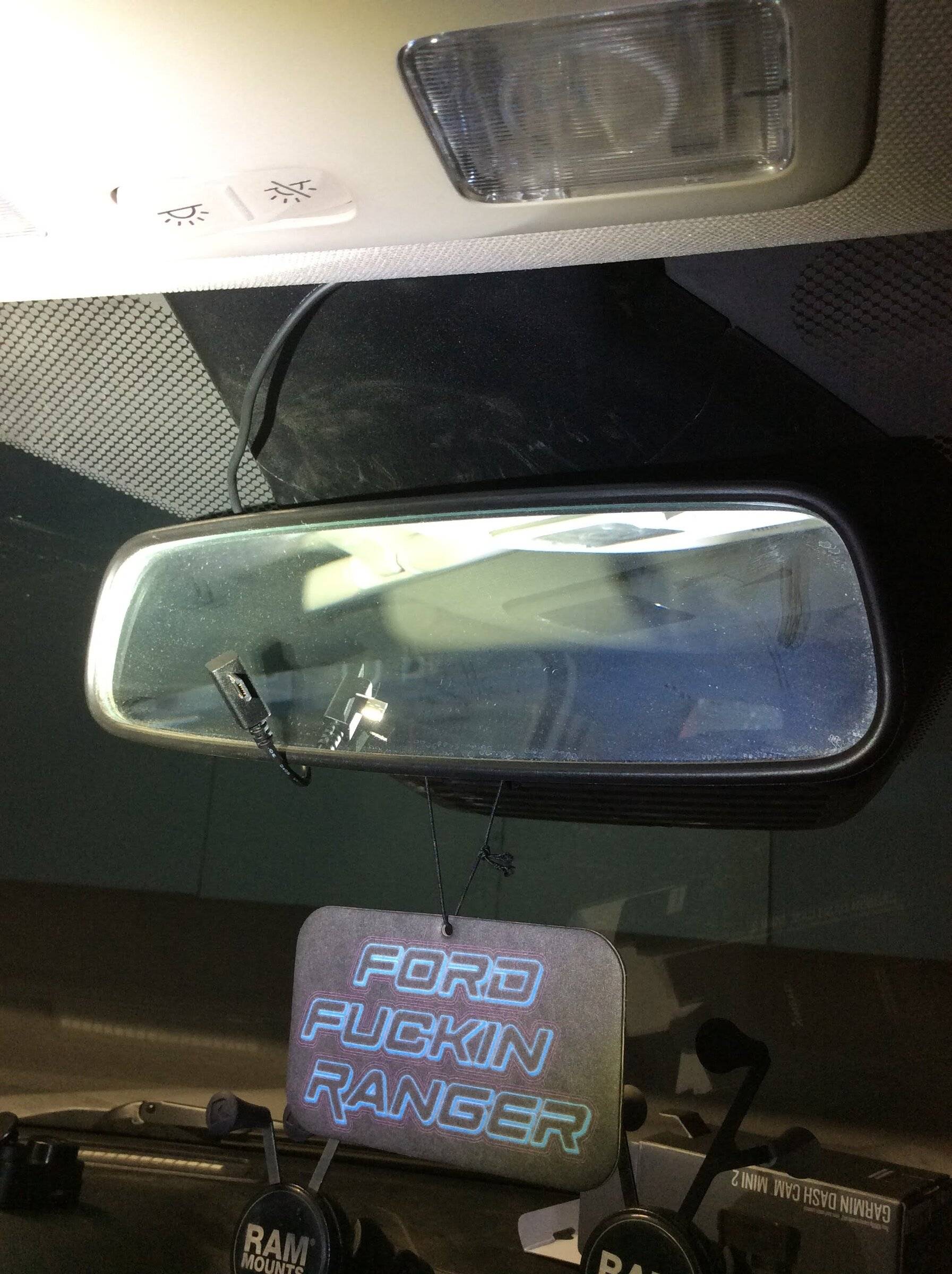

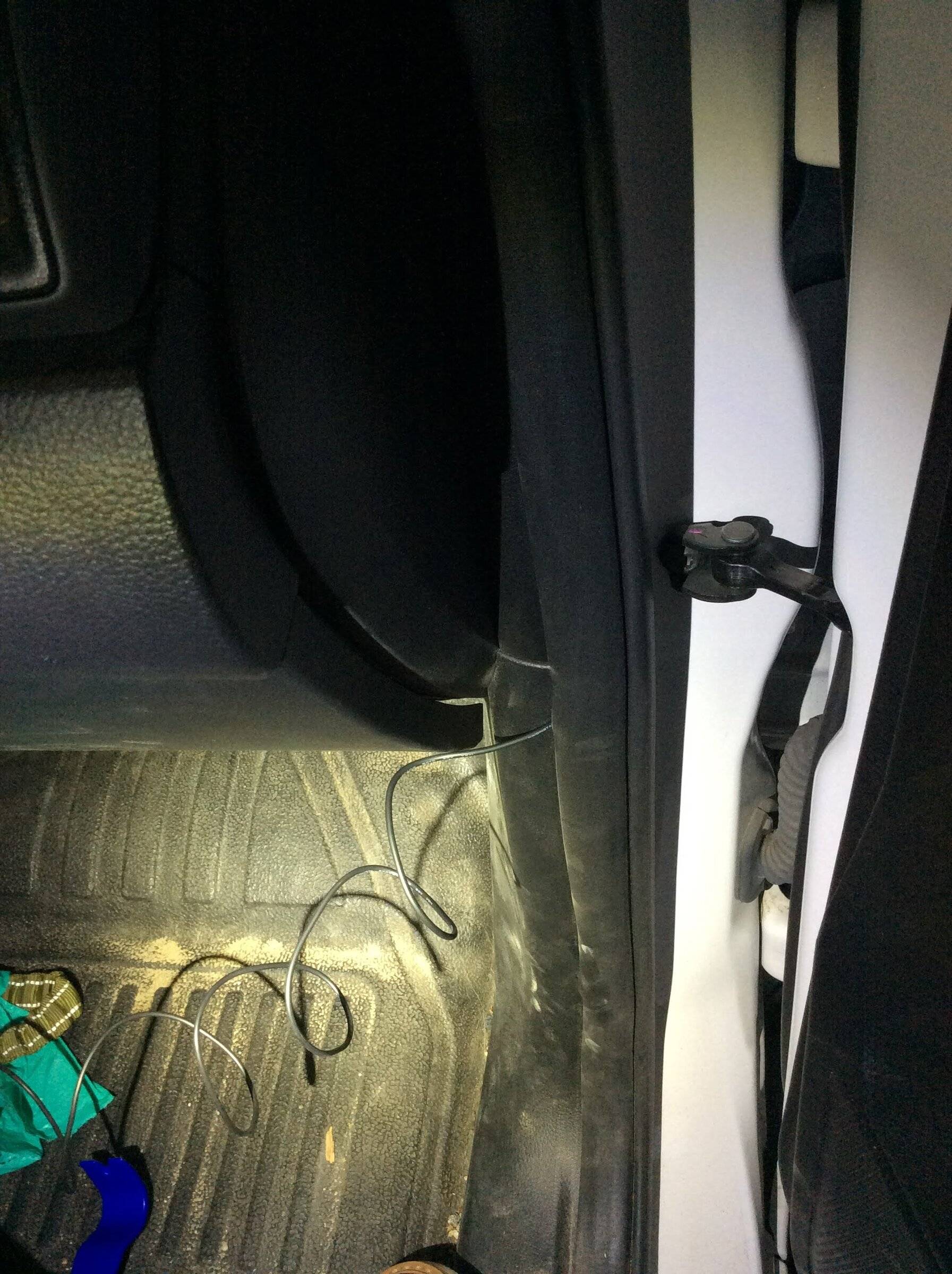

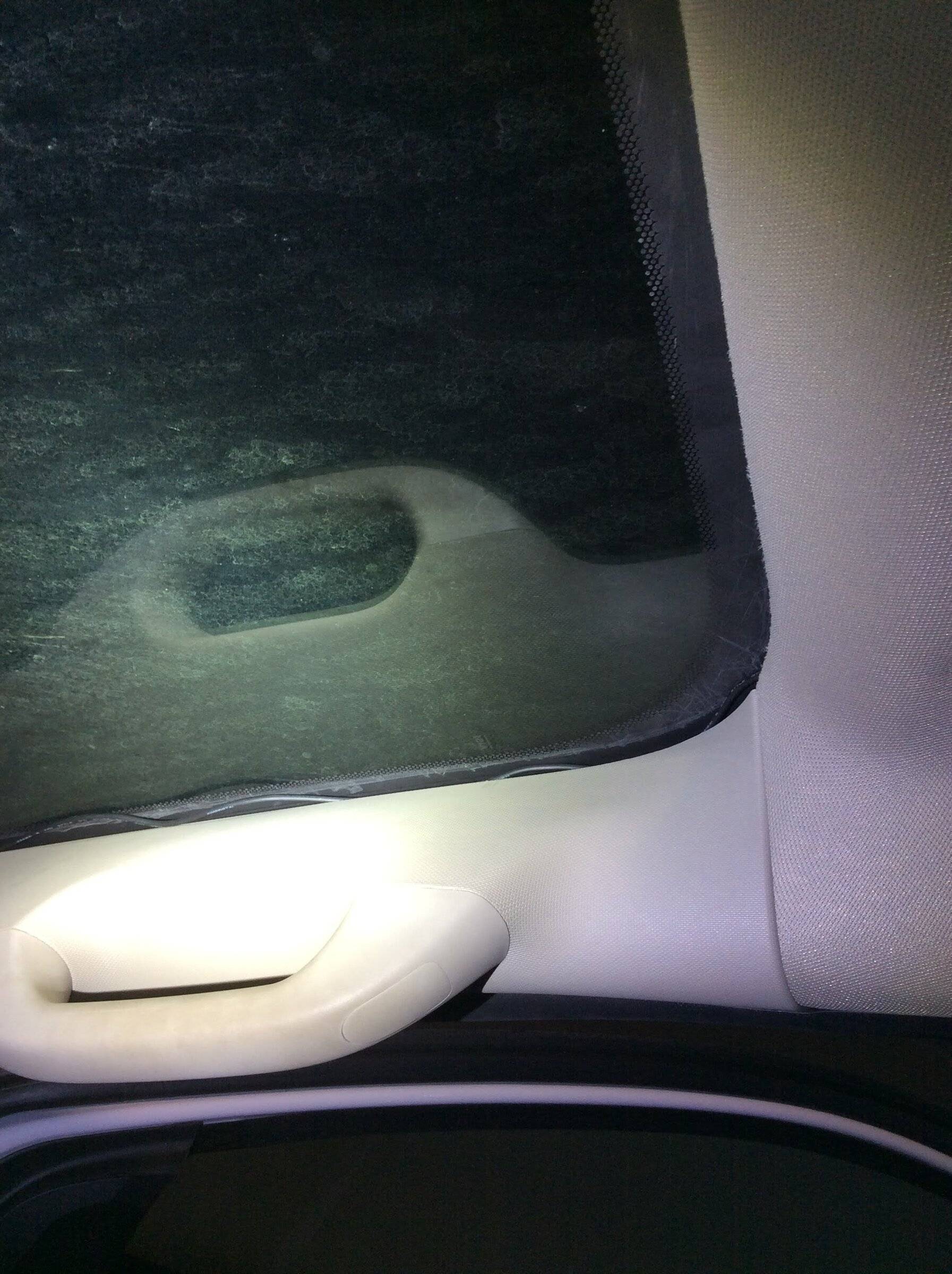

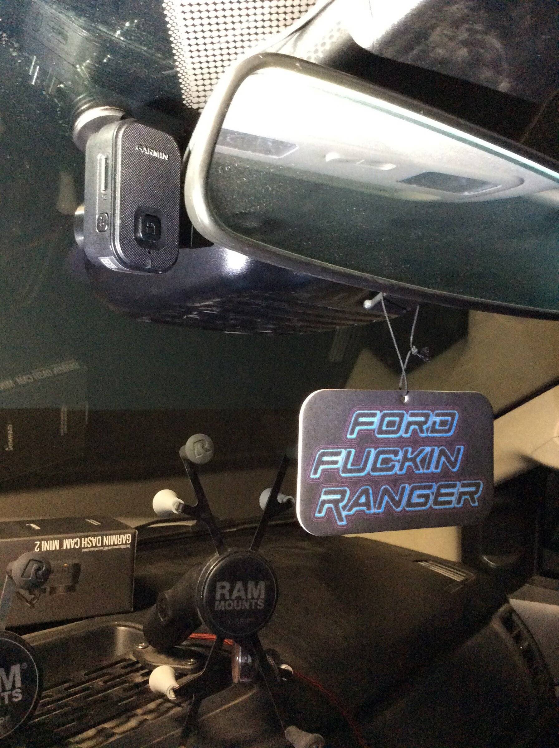

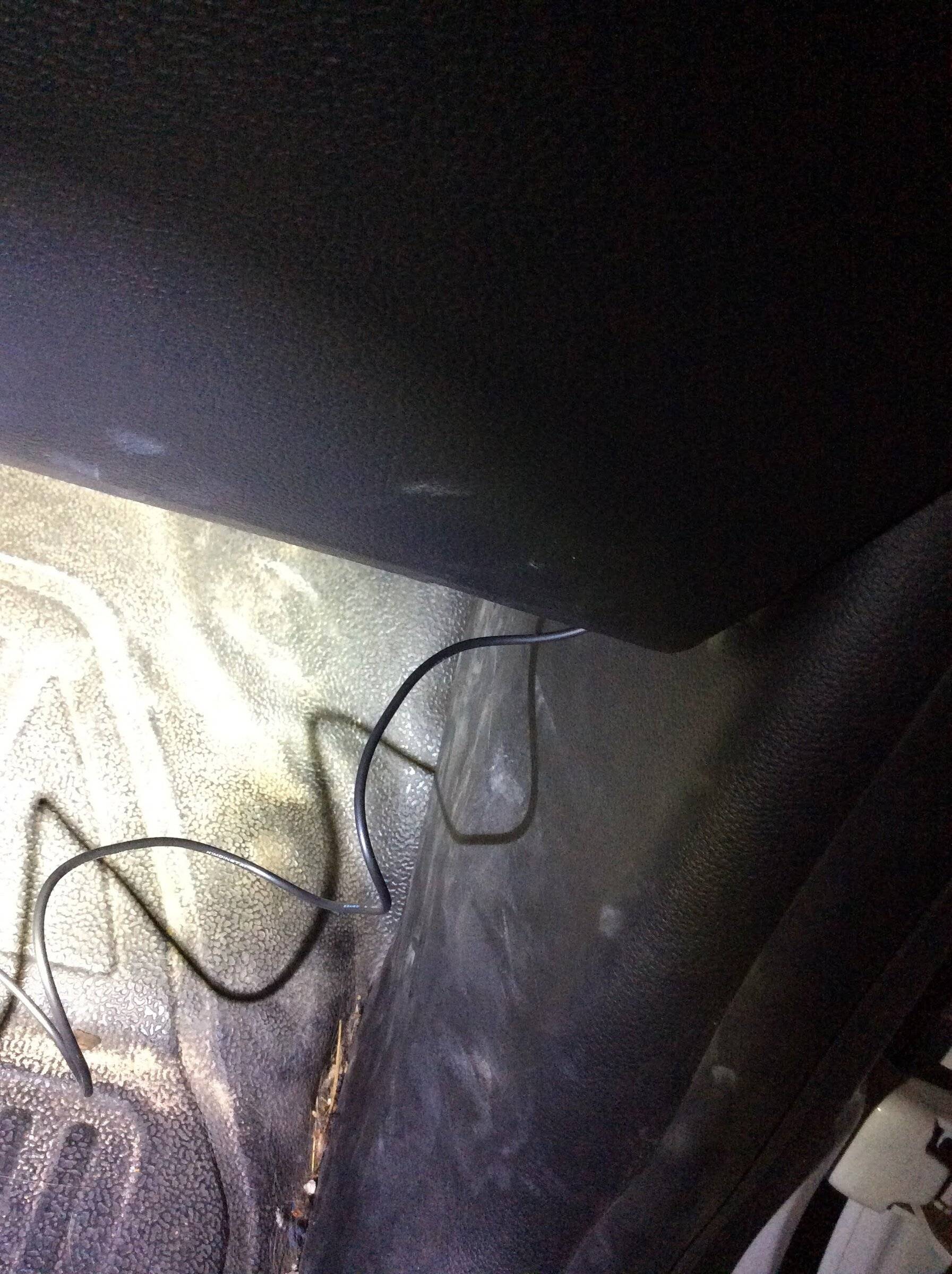

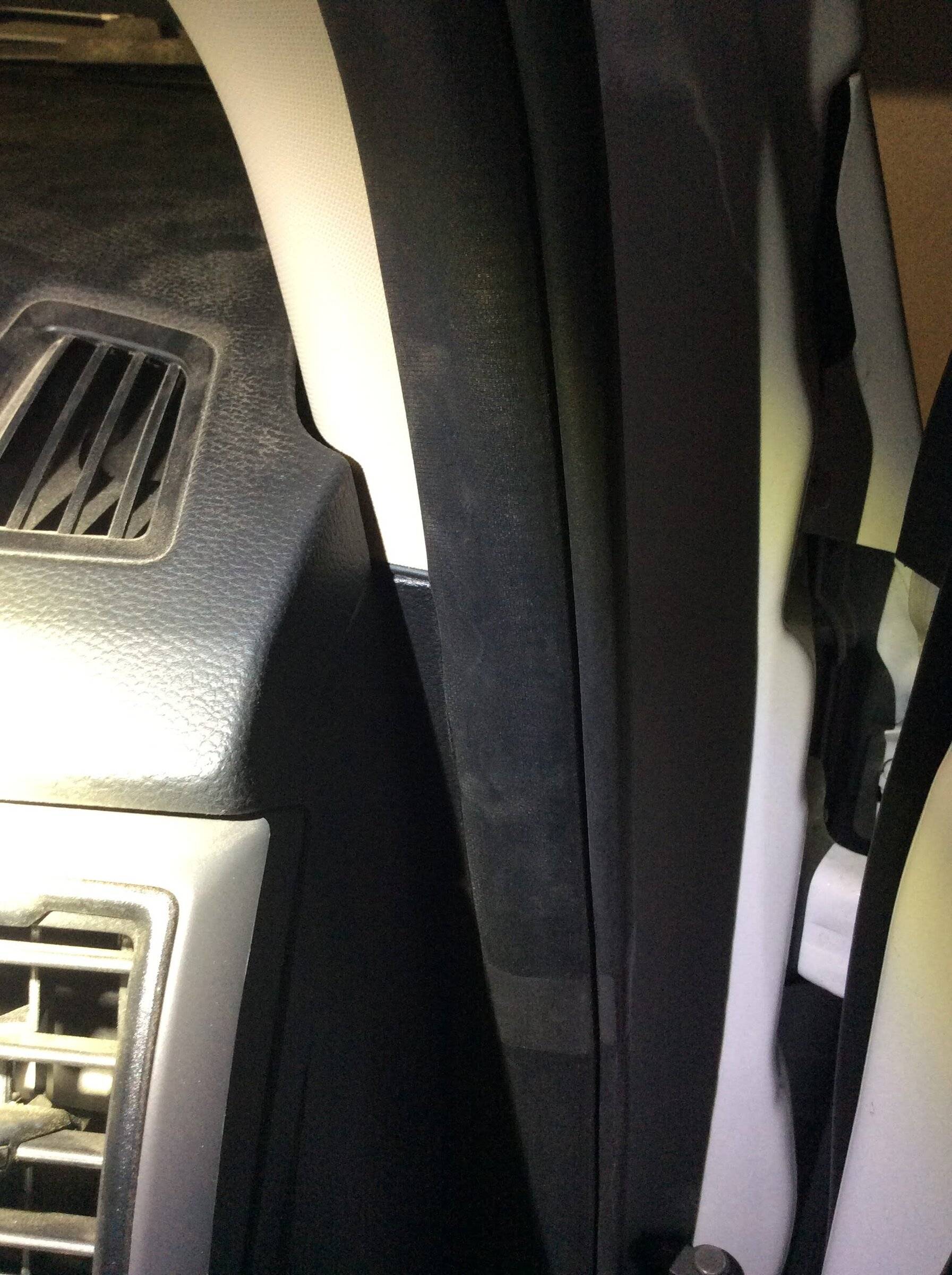

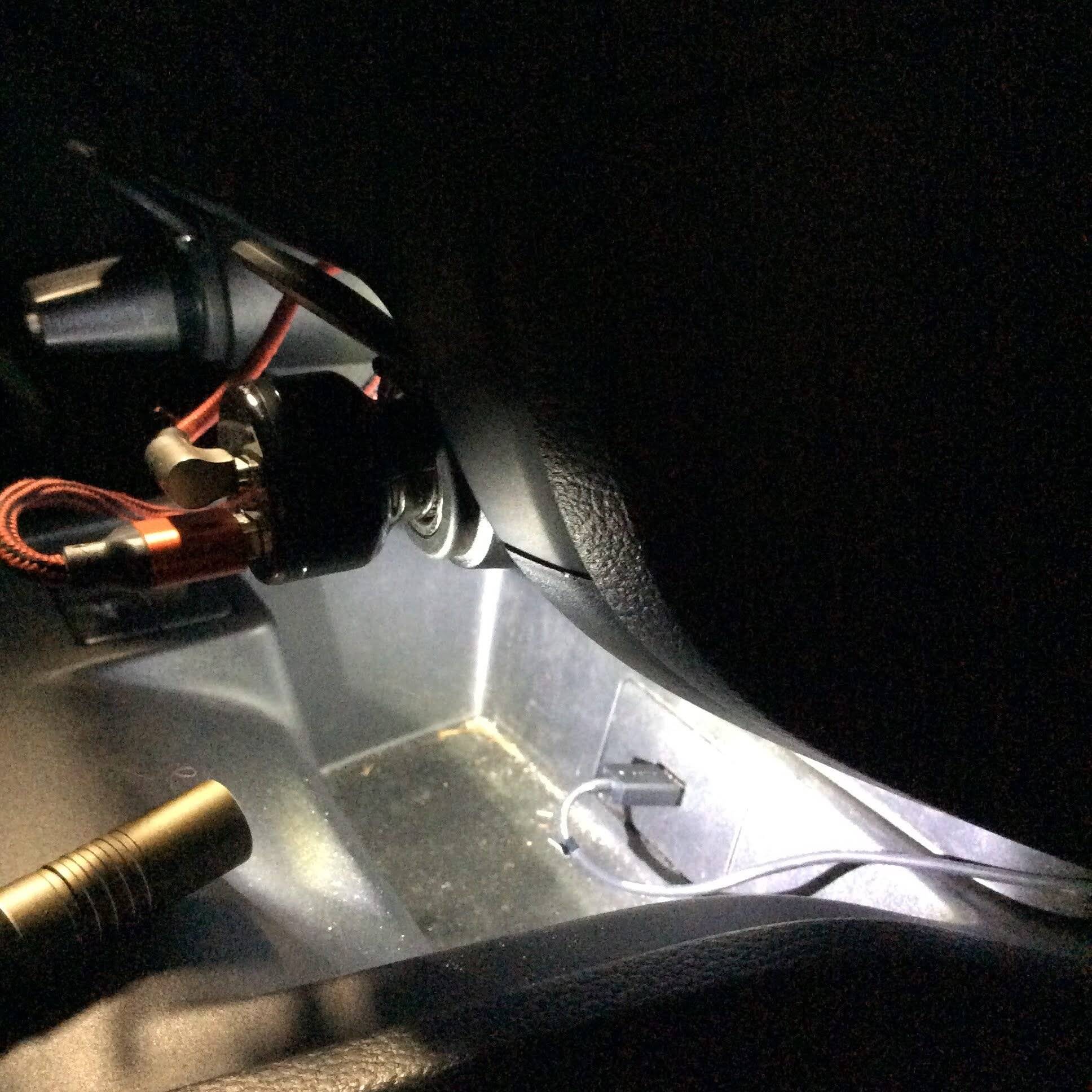

Last mod of the year (hopefully)! Installed a Garmin Dash Mini 2 camera on Steelie Dan. Wanted to get something on the incognito side that would provide insurance in the event of an accident.
Routed it from the left side of the rear-view mirror, tucking the cable under the ceiling trim.
Routed the cable down the A-Pillar to the edge of the dash panel on the right side. Interior removal tools were very handy to wedge the cable in between the plastic trim pieces.
Tucked the cable in behind the door seal (easy trick I learned from the We-Boost install a few months prior).
After the door seal I decided to route the cable behind the bottom of the glove box, by wedging it behind the trim piece in between to create a clean look.

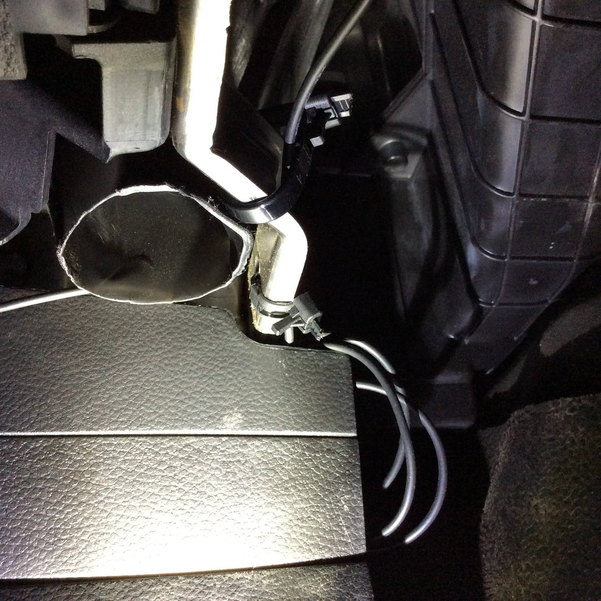

Below is the zip-tie wiring for the excess cable being stuffed behind the center console next to the heater exhaust vent.
Since I have an XL model, my center console only comes with one USB port, figured this would be a great spot for it until I can get the wiring harness to have the Garmin linked to the battery for better power management.
The last pic is the finished product with the installed dash cam!

Thanks for posting, I might do the same. How long was the USB cable?
