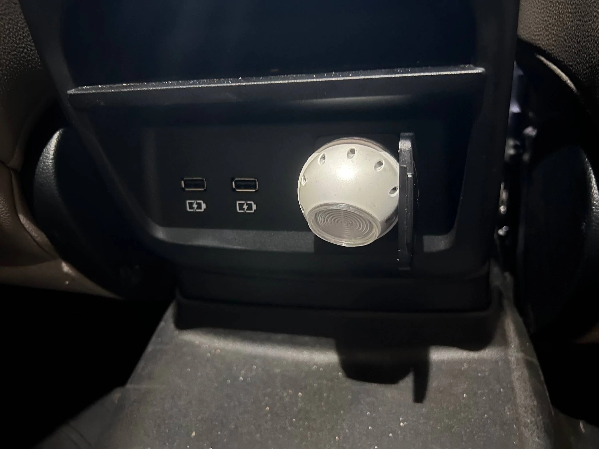

Here’s my A.S.S. eliminator. $5 at Walmart
