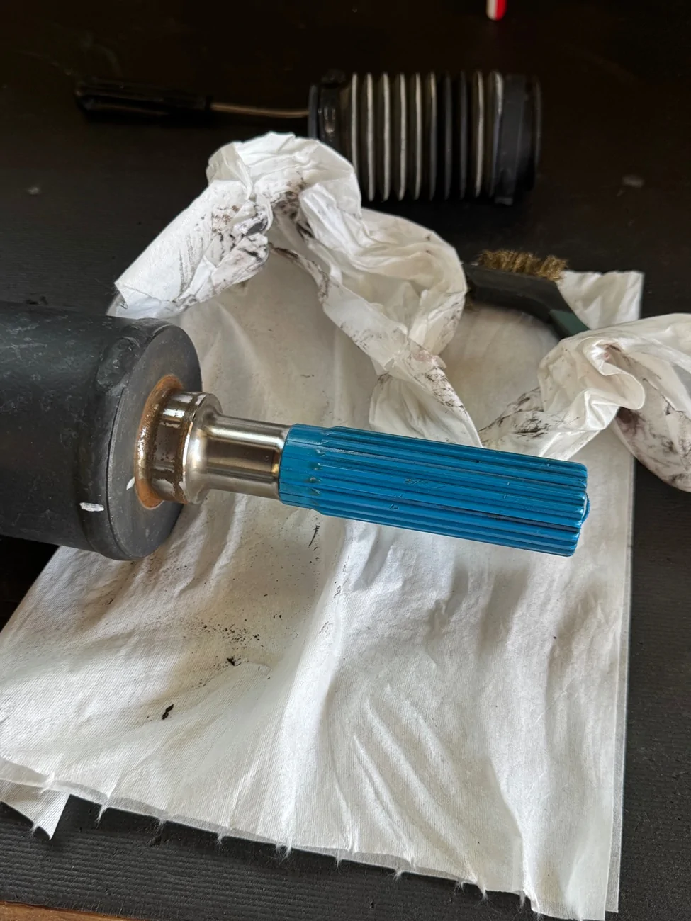

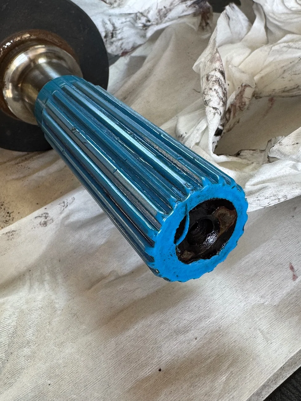

Yup lube the shaft. Don’t forget to properly clean it. And be very liberal with the new blue goo. Buy the real ford stuff its more expensive but its worth it. Wear gloves its pretty gross.

Just a heads up, you can do this without releasing either of the u-joints. Take note of the position of the yoke support in relation to the two bolts that all did to the frame. Remove those two bolts, release the clamps on the boot, take the drive shaft down and work it around, and it will release. Could be because I have the tremmor shaft and a lift that it works like this, YMMV. Lube it and put it back into position and torque those bolts in the same position. I just threw threw pipe clamps on each end of the original boot, no vibes
