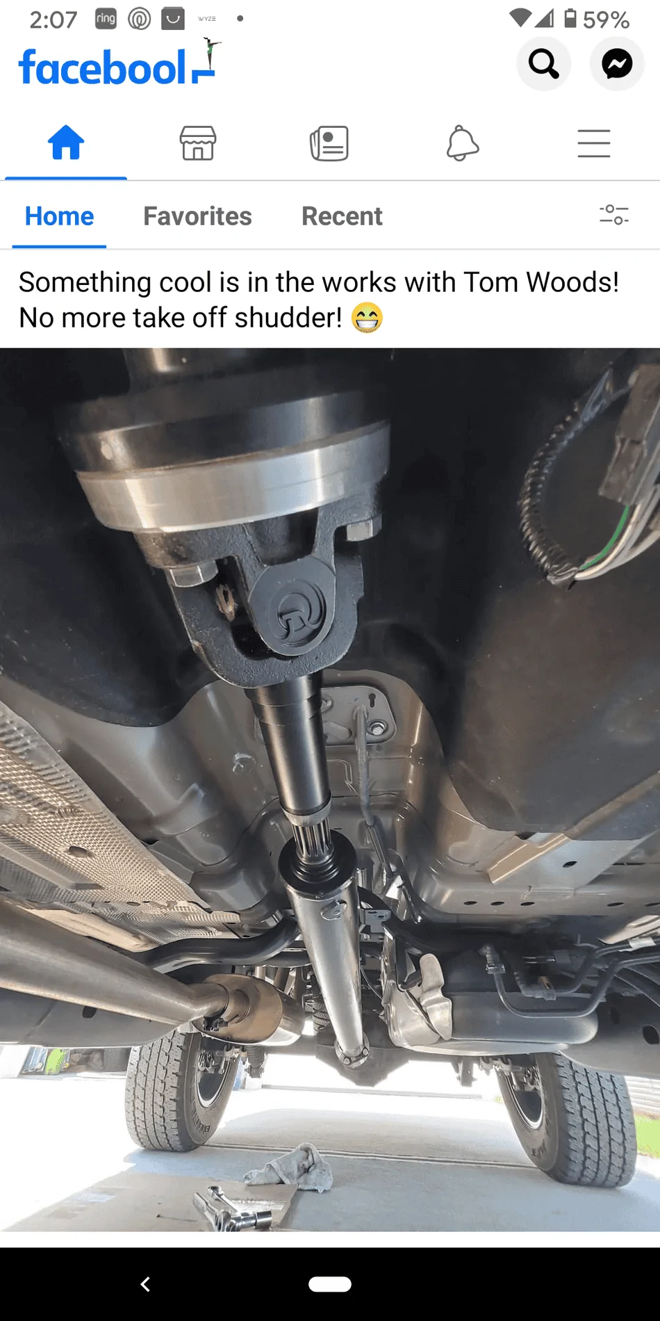

Well this looks interesting
Curious how much this will run. Also not sure about having that much of the splines exposed, but they do seem to know what they are doing.
I may go by a local driveshaft specialist shop here and see what they would quote to make one similar to this.

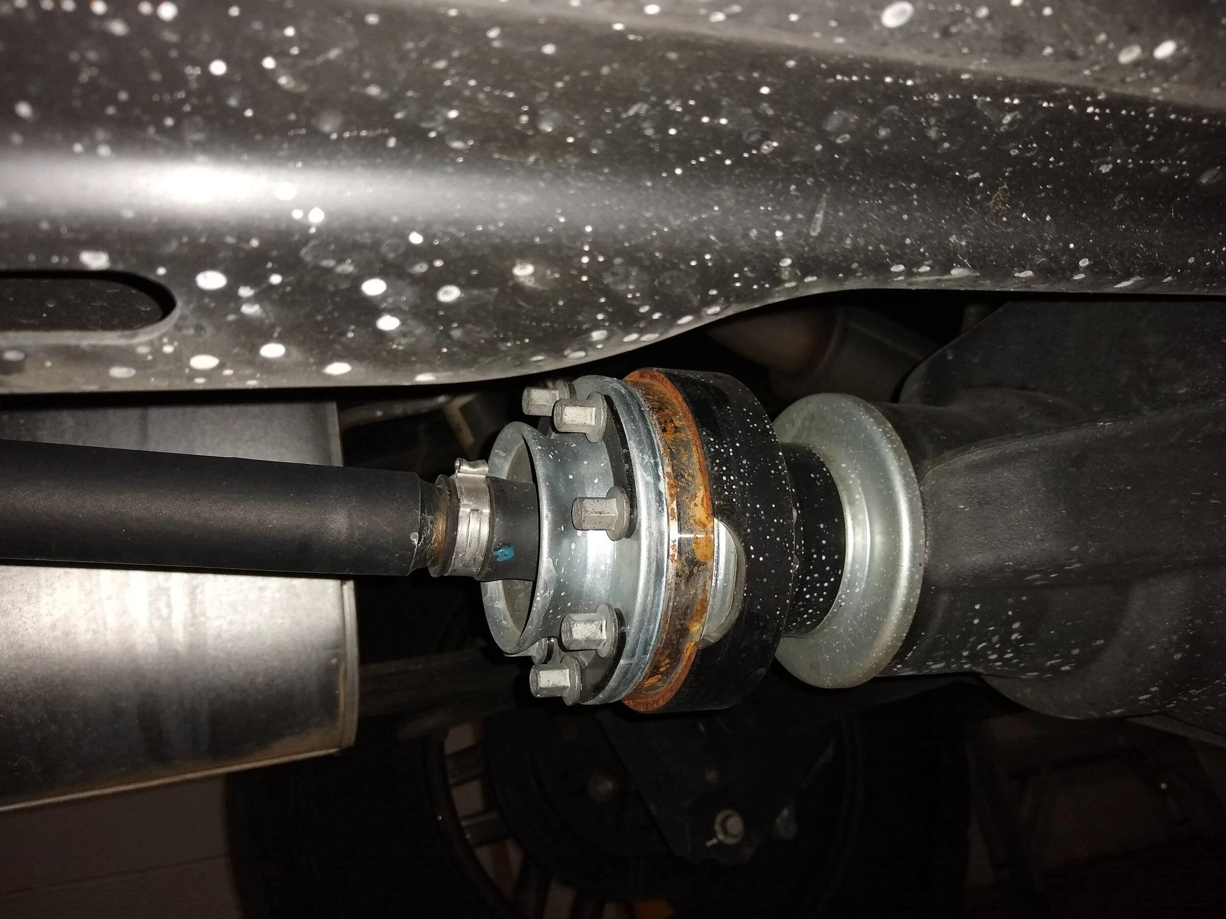

Looks like this thread got resurrected from a long nap, but was interesting. I looked and my 21 Ranger Tremor has a cv joint instead of a u-joint at the rear axle pinion connection, so that must have been a design change.

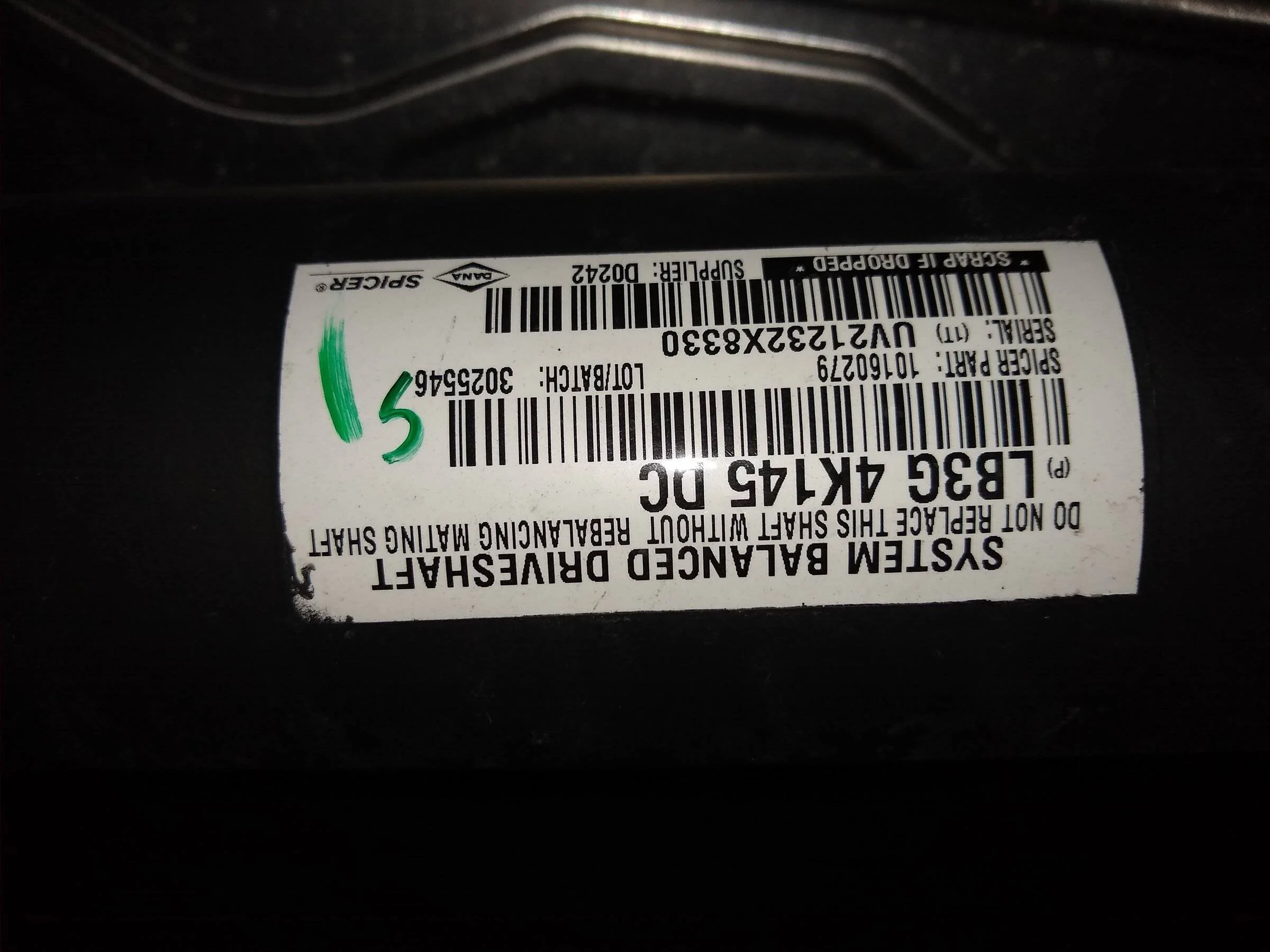

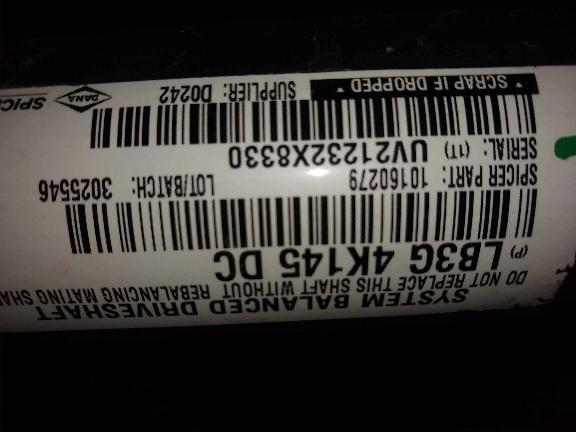

You would have to change the pinion yoke flange in addition to adding the Tremor driveshaft. Otherwise, should be bolt in. Attached are pictures of the labels on the front and rear driveshaft sections.
JasonTremor
Feb 1, 2022
869
1,917
2021 Ranger Tremor XLT
Here is a picture for reference of the different pinion flange.
