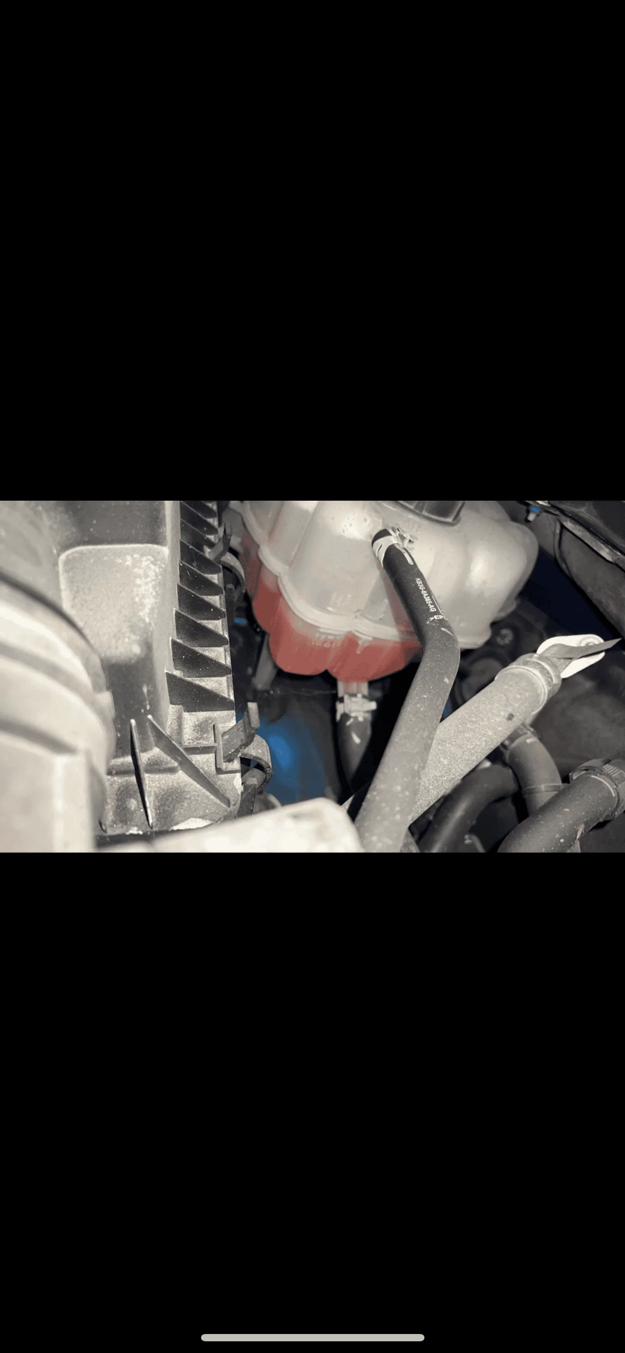

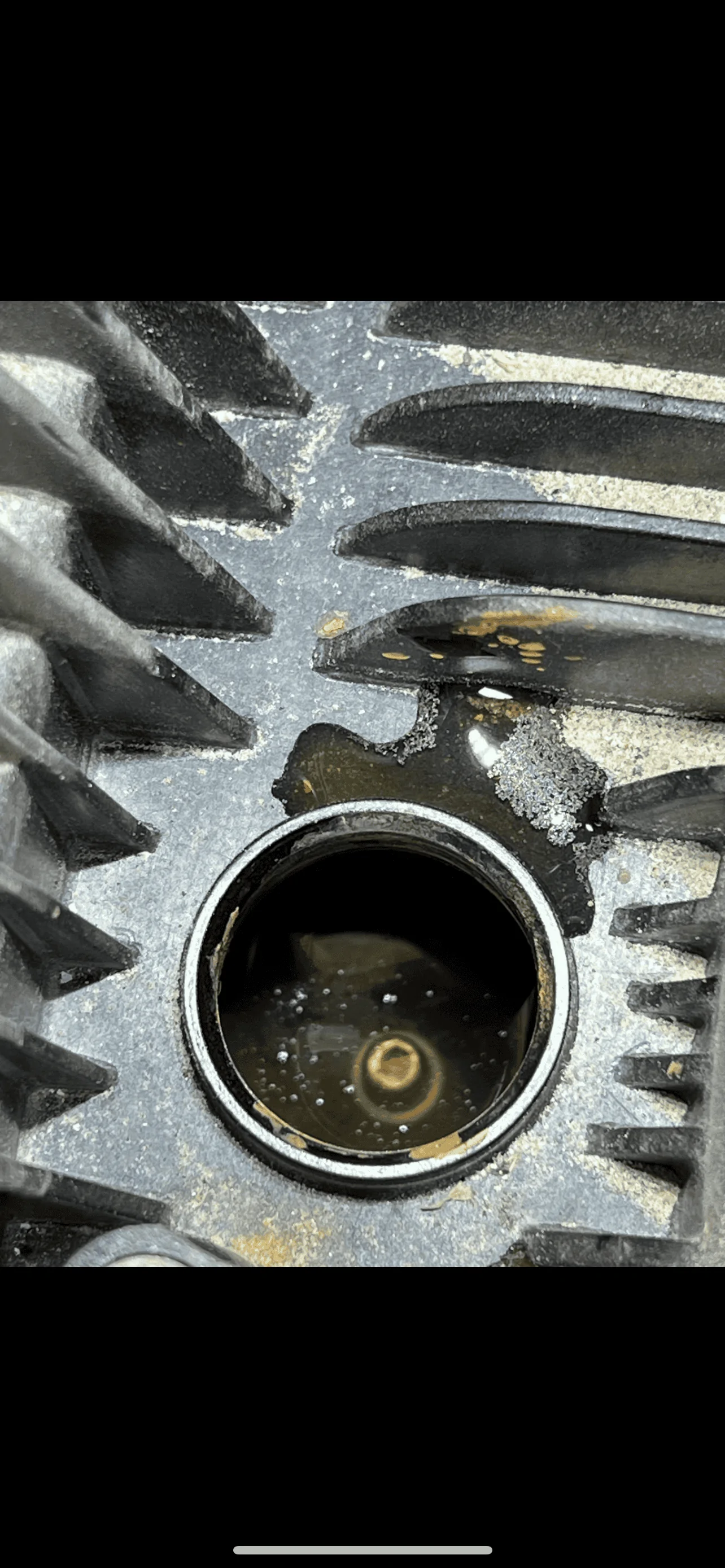

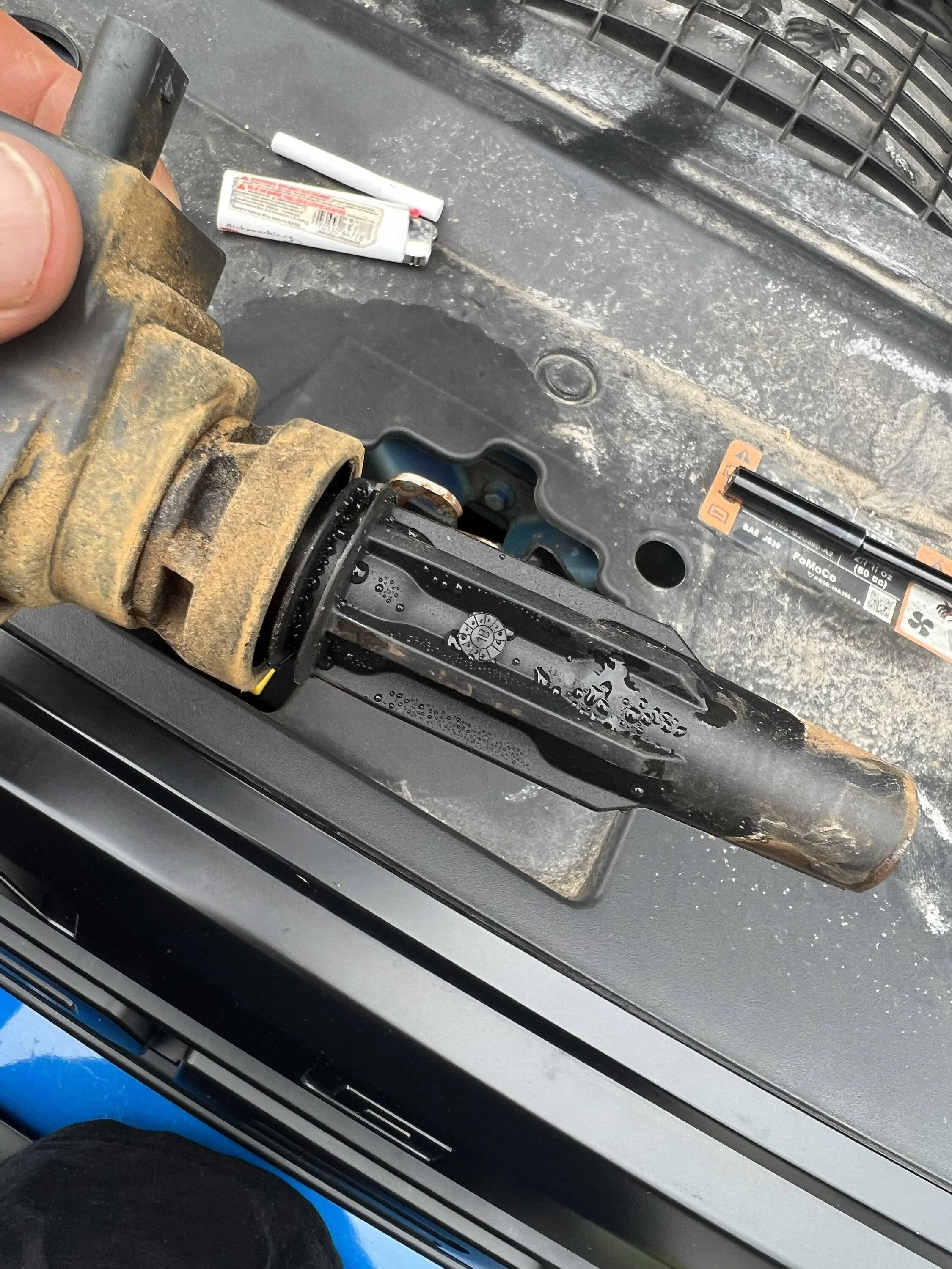

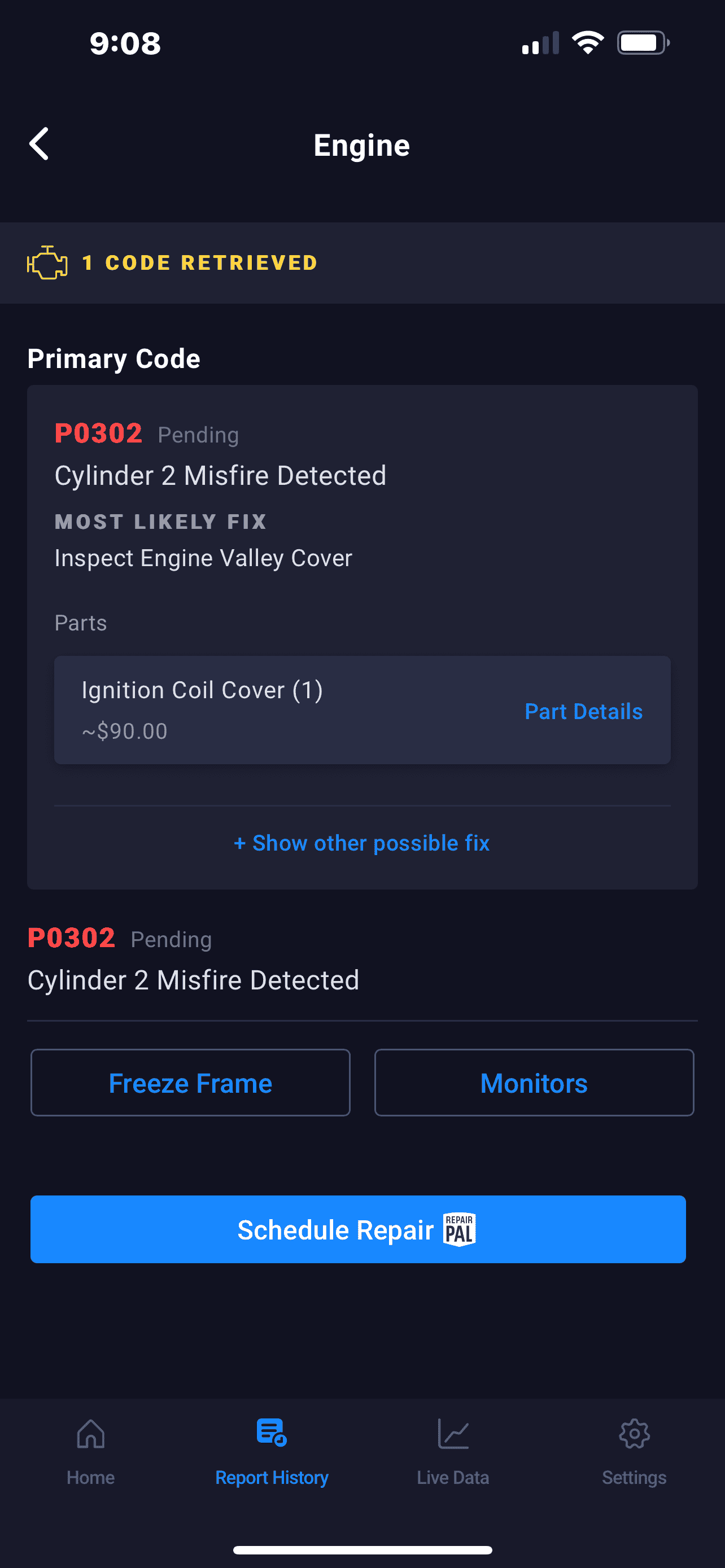

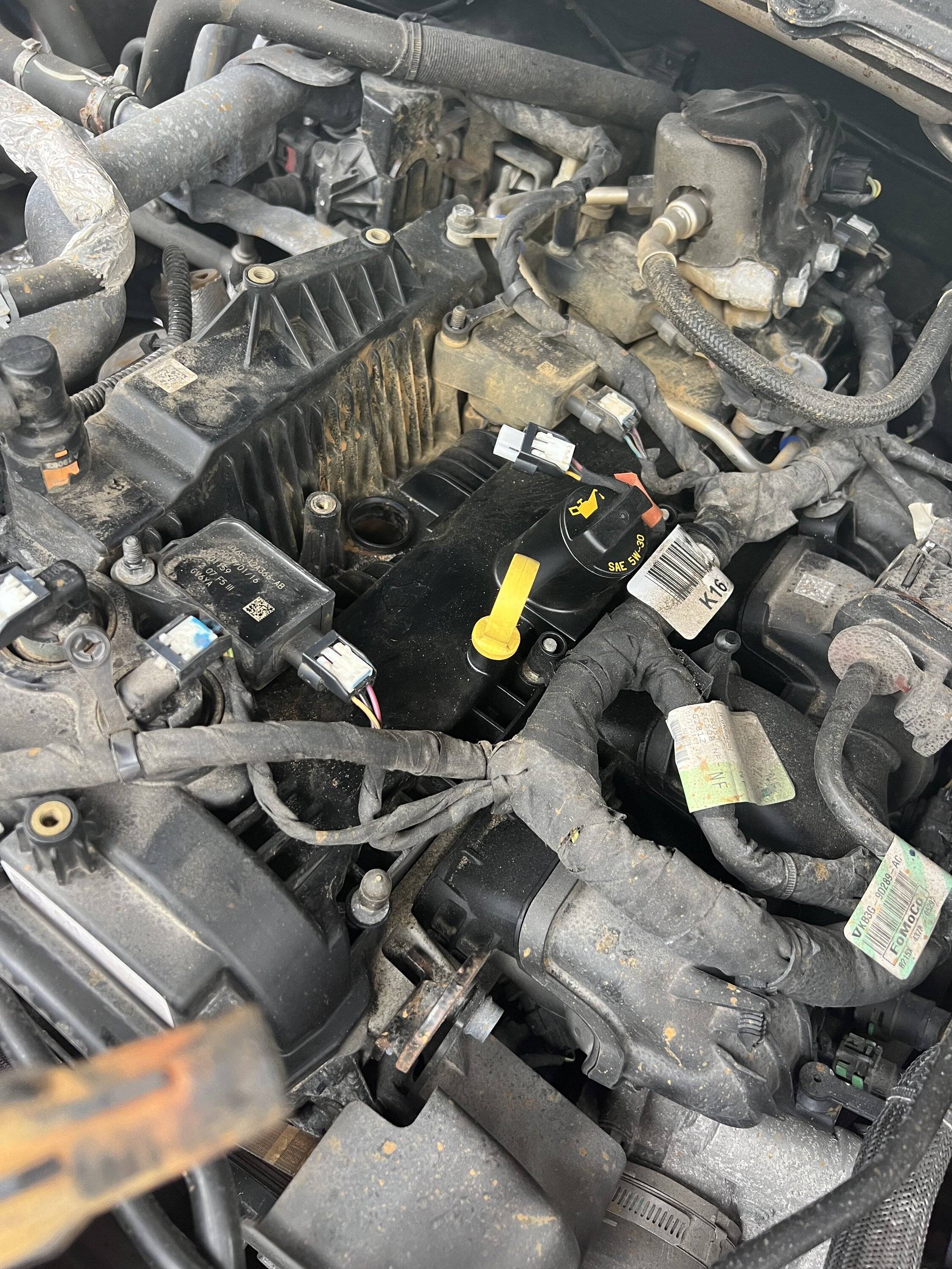

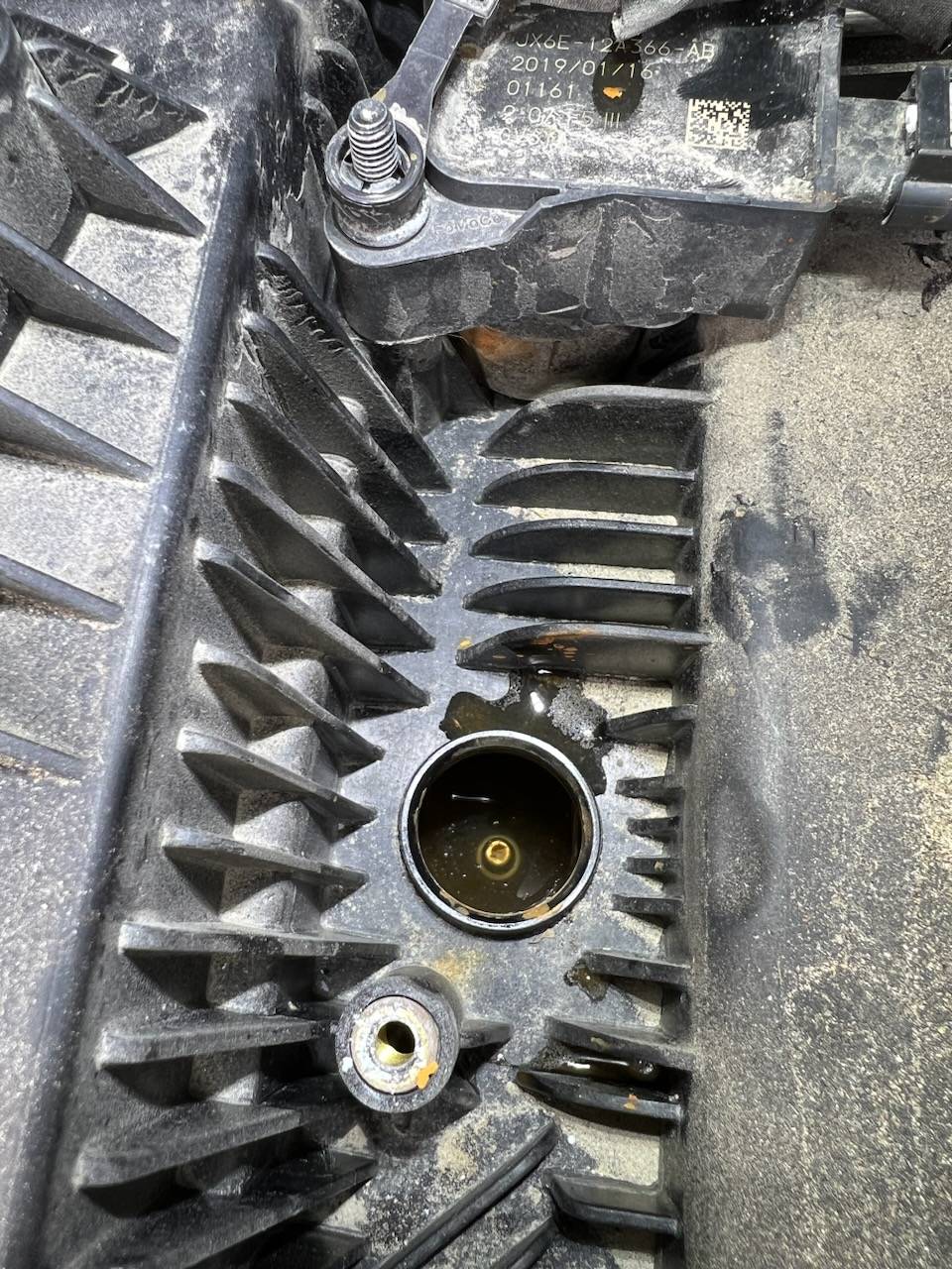

I have a issue with my 2019 Ranger XLT 81000kms.
was driving the truck and P0302 code popped Up. Pulled coil pack removed spark plug and found this. Took it to my mechanic and said it’s coolant in the cylinder.
Took the truck to ford in Canada and tech swapped coil 1 and 2. Misfire stayed with coil 2. Replaced spark plug. Truck returned. Same issue arose P0302. When looking at the cylinder after pulling the coil now I dont see any liquid.
ford dealership claims they can’t confirm liquid in the cylinder by my pictures or that it is coolant. Engine under warranty.

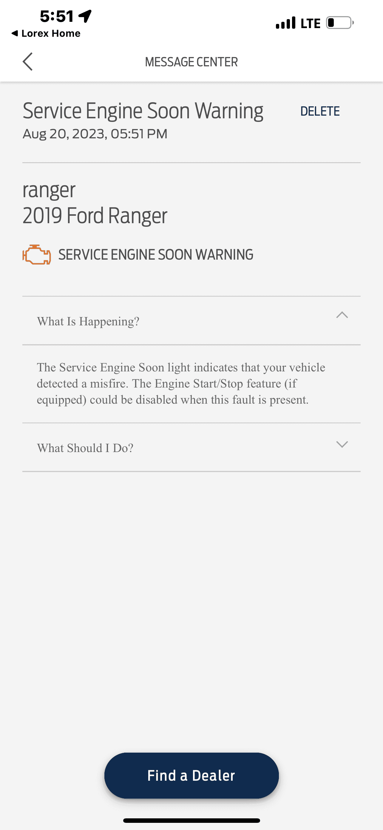

I have a 2019 Ford Ranger XLT with 81000km up in Canada.
was driving the truck and P0302 came on. Misfire cylinder 2. Took the truck to ford dealership and swapped coil and one 2. Misfire did not follow. Changed spark plug. Truck returned!
2 days later driving the truck same error code P0302. My mechanic removed the coil and spark and noticed the liquid which he stated was “coolant” and it needs to be taken to ford.
the coolant was at max when the truck was driven the first time the code appeared. Truck has only been driven 400kms since first code and second time after being serviced
what can I do as this is now the second time taking it to the dealer. They said they cannot confirm that by the picture that it is cylinder 2 or that it is coolant.
any help would Be appreciated

Phil's not a tech, he's a retired Ford engineer. You need to get a service department to look at that in person.
It’s been looked at by a ford tech. Changed the spark plug. Same issues!
I also know he’s a retired engineer. Was just inquiring if he knew of any help that could be passed along to myself with this matter!
