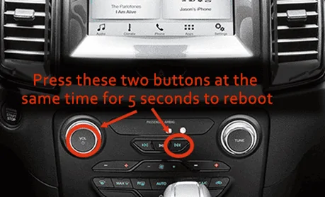

The Master Reset can be found under Settings. A soft reset is done by:
