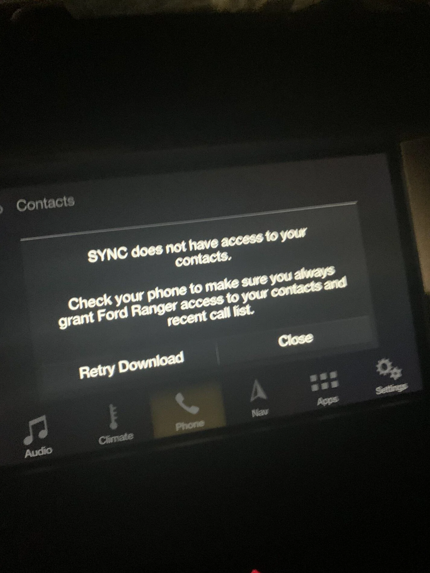

I suppose this issue happened after updating to iOS 14.2, or maybe auto update on my truck went to Sync 3.3. I am not sure as I just set up System Wifi on my truck a few days ago and not sure if it updated from a previous Sync Version. As I never noted the version prior to this issue.
I am able to successfully pull text messages to my vehicle, and have verified that Contacts are allowed on the Ford Ranger device.
Troubleshooting steps:
Deleted Bluetooth devices from vehicle. Deleted CarPlay devices from vehicle. Removed Bluetooth profile from iPhone.
Rebooted iPhone.
Re-Added to CarPlay and Bluetooth.
I ca use the “Dial” command as well, but there is no way for me to dial by contact...as it can’t download contacts.
The exact error is attached.
Thanks for any help.

I have android.
But the message says "....access to contacts AND recent call list". Are those both enabled? or is that the same setting?

I have android.
on iPhone, Bluetooth has 2 options, “Show Notifications” and “Sync Contacts.”

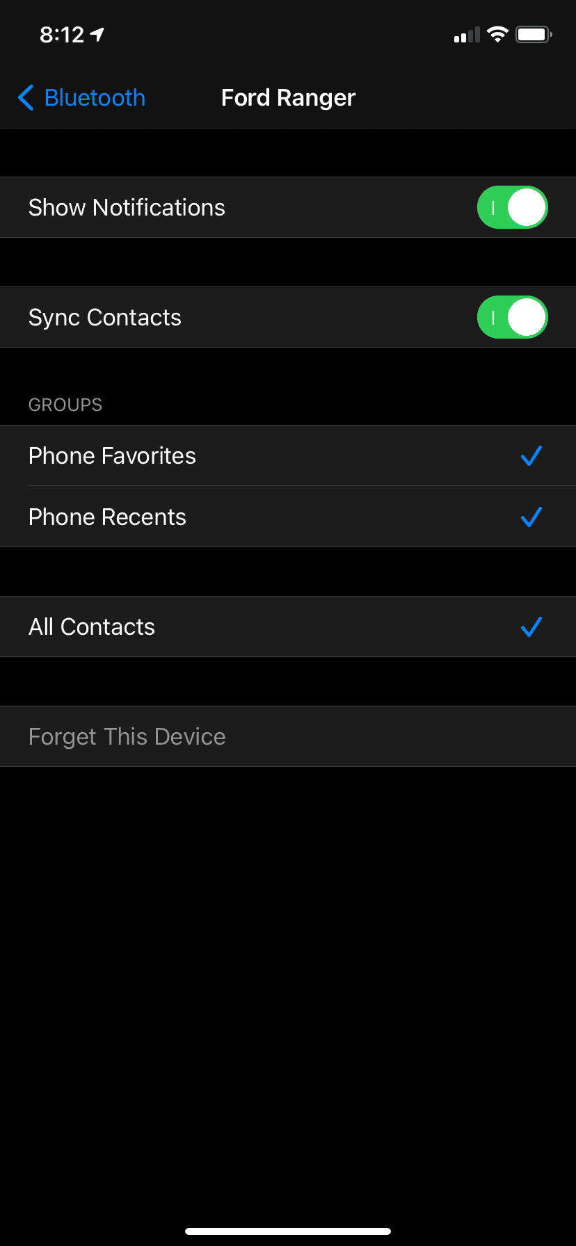

You can also specify which groups of contacts you want to sync, but I have all set to sync.
That being said, I am not sure if there is a nested setting elsewhere is iOS 14, but if there is I can’t find it.
Where can I find this setting, and are you on Sync 3.3 and iOS 14?
Thank you to all for your help.
Here is what my Bluetooth settings look like for the Ranger. All 5 options are on.
