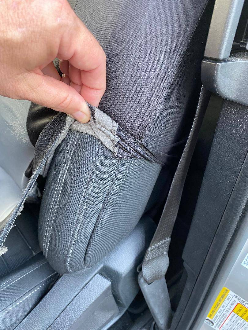

After my Dealer told me this issue is not covered under warranty because it is normal wear and tear, contacted Ford and they said the same. They did record my report into a case and I sent a photo of the damage. If they get enough reports from owners it would be under consideration for warranty coverage.
I prefer a fix that will cover the wear spot as well as prevent any future damage. Did an intense amount of research about upholstery fixes and evidenty an iron on patch would be best. Mostly negative reviews from users of stick on patches and other methods of fabric and upholstery repair.
It appears that Amazon offers the best iron-on patch: Amazon.com: ZEFFFKA Premium Quality Fabric Iron-on Patches Inside & Outside Strongest Glue 100% Cotton Blue Gray Beige Brown Yellow Red Green Repair Decorating Kit 14 Pieces Size 3" by 4-1/4" (7.5 cm x 10.5 cm)
Here is one of the reviews that is attached to it: By R. P. on February 8, 2021 Used the patch on a seat in a 2008 Jeep. Went on easy and a month later still there.
I would probably in addition to covering the worn spot with it, also apply some of it on the inside of the belt where it sets against the seat back for extra protection.
If this doesn't work then I would use a seat belt pad like some of you are doing.
Any thoughts?

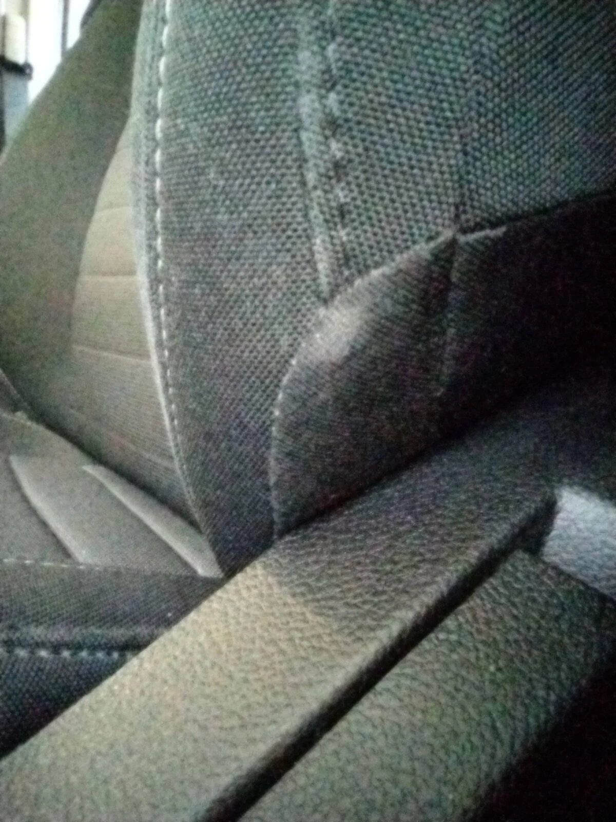

I inspected my almost-pampered, 2021 Ranger with 5K miles, 4WD leather-SEATING Surfaces Lariat and there IS a Very small area of wear, in the “Rub Zone“, on the outer left side driver seat, NON-Leather, woven fabric section. BUT I have a habit of OUTWARDLY Left-leaning stretching the seat belt-harness BEFORE I attach it. This stretching action MIGHT have minimized wear to the affected area, but I’m not sure. I’ve been stretching the lap/seat belt for decades, since retractable seat belts were the standard, in order to reduce resistance AND getting a comfortable and effective fit. I try NOT to rush, ever, in the seatbelt fit. This Outward stretching May Have reduced the friction on my Ranger driver seat upholstery “wear Zone”. In any case, my appreciation to the OP and replies.
Indeed.
This truck is used almost daily, which roughly figures 2 rubs per driving event; one attaching & one returning.
I will also consider coming up with alternative(s), to somehow, placing “roller” style jewelry beads, (or similar Or other possibilities, to offer choices to a Faux sheepskin solution, to act as a friction-reducing spacer and significantly reduce damage). I must now consider one or more methods (available genuine Leather patch material, durable plastics, ceramics, metals ? Whatever), to how best make a simple, wear-reduction, effective design, that Does Not hinder seatbelt function in Any way, And, provide a choice to the faux sheepskin option. Faux sheepskin may be subject to early wear And May only be a temporary solution, one that I will probably promptly use, until one or more successful, permanent alternatives are designed.
It would NOT hurt if FORD Corporate acted on this issue, with Zest. This May be a design flaw, regardless. It is an avoidable condition, but if the wear continues, will only be permanently corrected by an expensive fix, one that could be made non-existent, with some intelligent, cost-effective design, thought thoroughly UP FRONT.
Maybe ?
To Ford:
are you paying attention ?
We shall see.

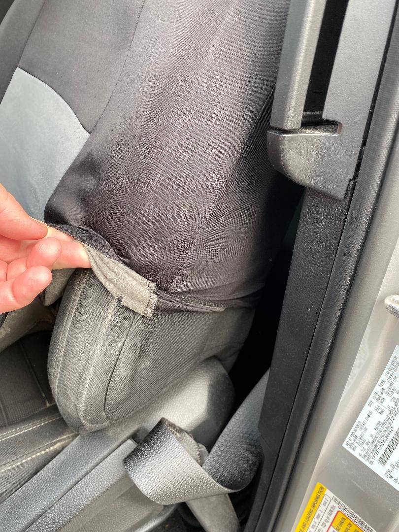

quick update...I was thinking about the pic of my seat looking faded an gray. I thought maybe it's the backing of the seat cover rubbing off an leaving a layer of dust on the seat. I went out an took a damp cloth to it an it came right off.
after wiping it down

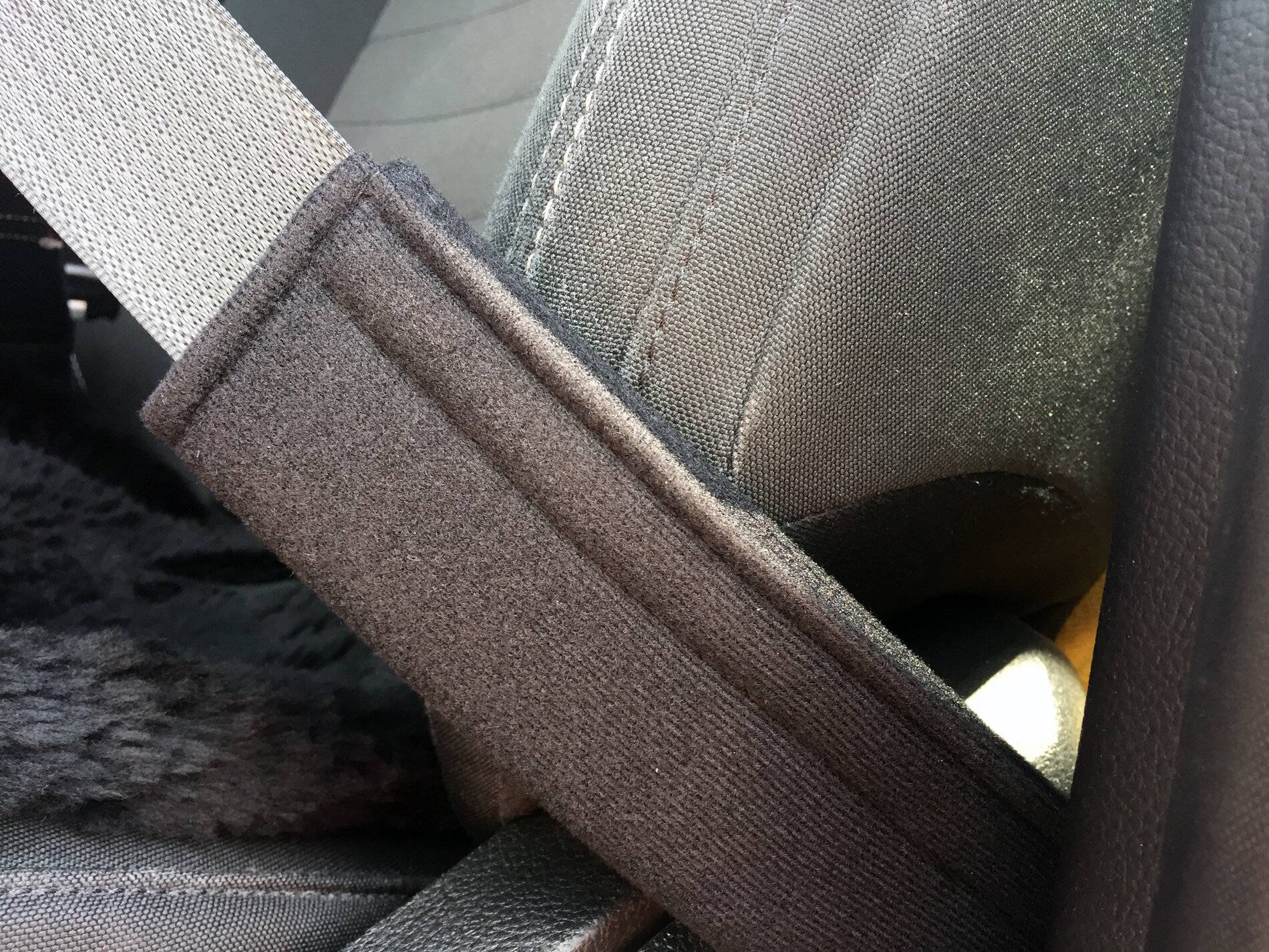

I have decided not to patch the wear spot for now. In the meantime will order these seat belt pads in dark gray to match the interior. Maybe this will be all the fix I need :)
Amazon.com: Soft Faux Sheepskin Seat Belt Shoulder Pad for a More Comfortable Driving, Compatible with Adults Youth Kids - Car, Truck, SUV, Airplane,Carmera Backpack Straps 2 Packs Black : Automotive
For $9...yeah. That's why I stole the one from my wife's car. Doesn't get in the way and doesn't really stand out visually (much).
That's what I just did...shame the Coroplast didn't hold...but this will at least keep things from getting worse...

Sid,
Thanks for letting me know that the patch didn't hold...won't do it either as it might create more problems! :)
Chris,
Does the pad need to slide up and down on the belt as you buckle and unbuckle it or can the pad be set at one point on the belt where the rubbing occured without having to slide?

Gravity keeps it down...where you want it...see my pic...it doesn't move...

It's set all the way at the bottom and doesn't move.
