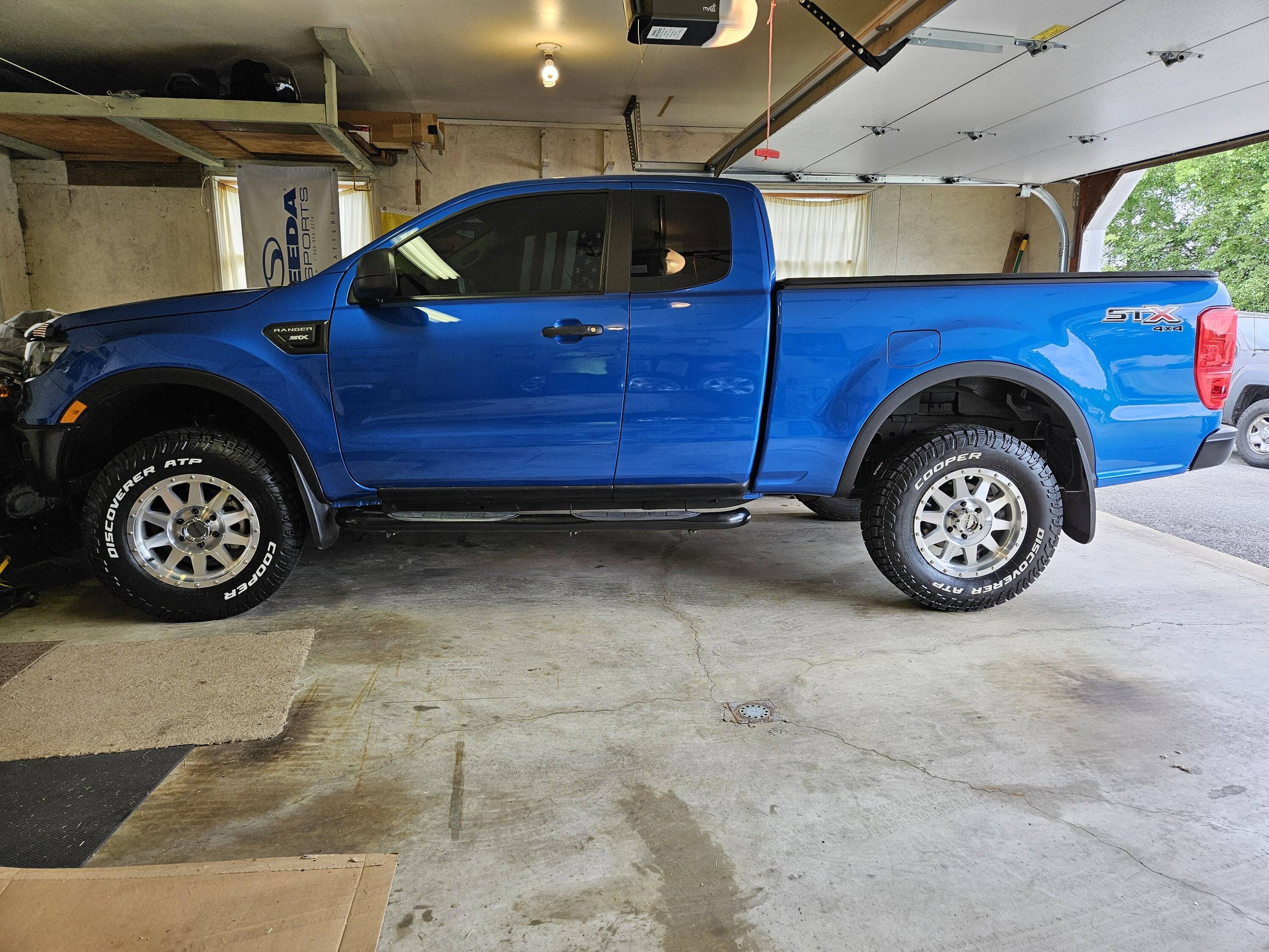

I don't have a Tremor, but I just installed Method MR 301's that are 17 x 8.5 with +25 offset and fit just fine (265/70 tires). May poke just a little bit.

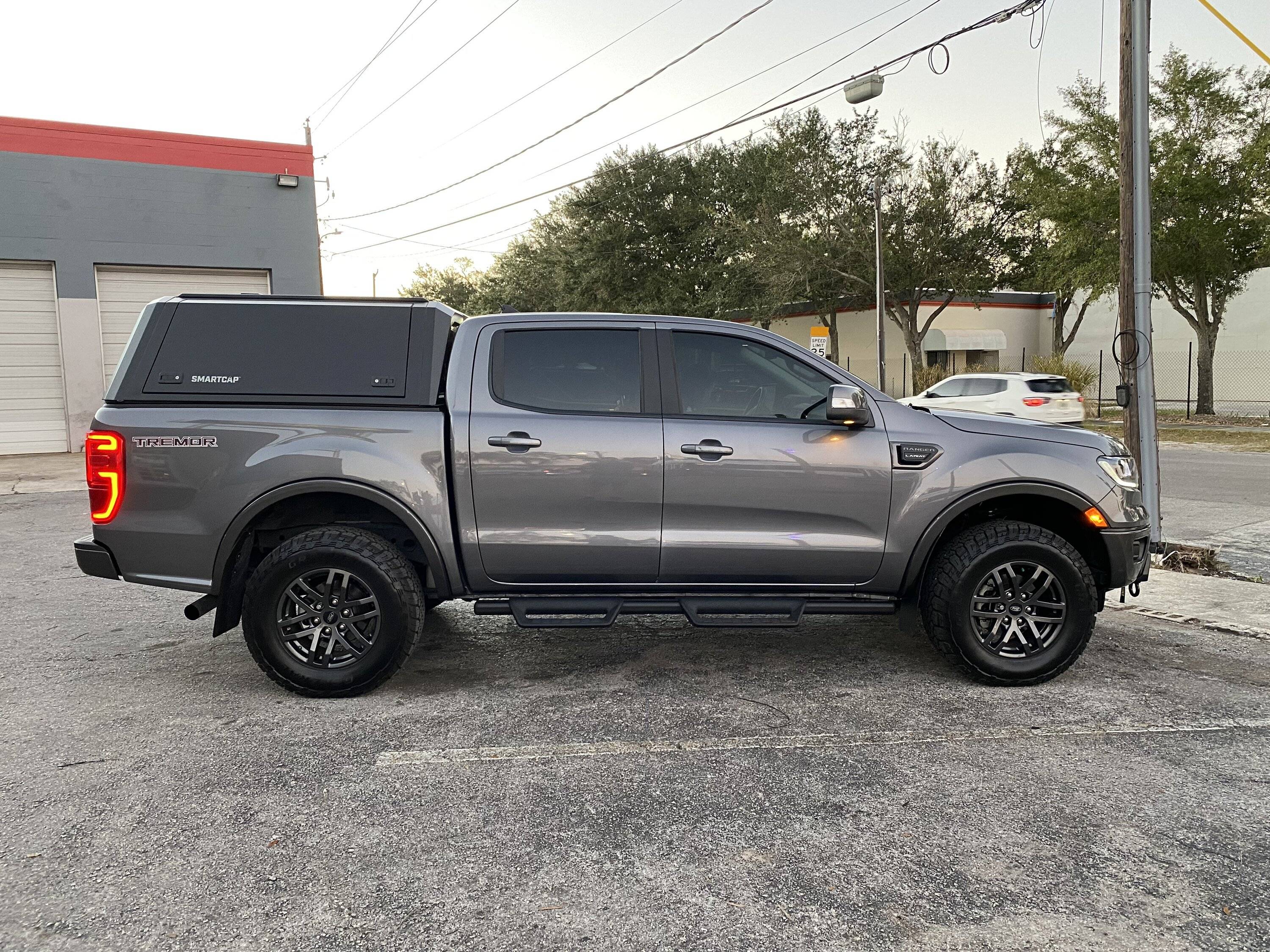

Unrelated, but curious - what kind of camper shell is that?
ATFIII
ATFIII
Anthony
Jun 11, 2021
Tampa, FL
2021 Lariat Tremor
First Responder
It’s the RSI Smartcap EVO Adventure— I absolutely love it and have zero negatives to say about it (less the cost).
pics or it didn’t happen!
