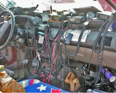

I have seen some absolutely horrendous installations of after-market wiring! I shake my head, and wonder who the idiot was who did the work!
Do it correctly, or don't do it!
