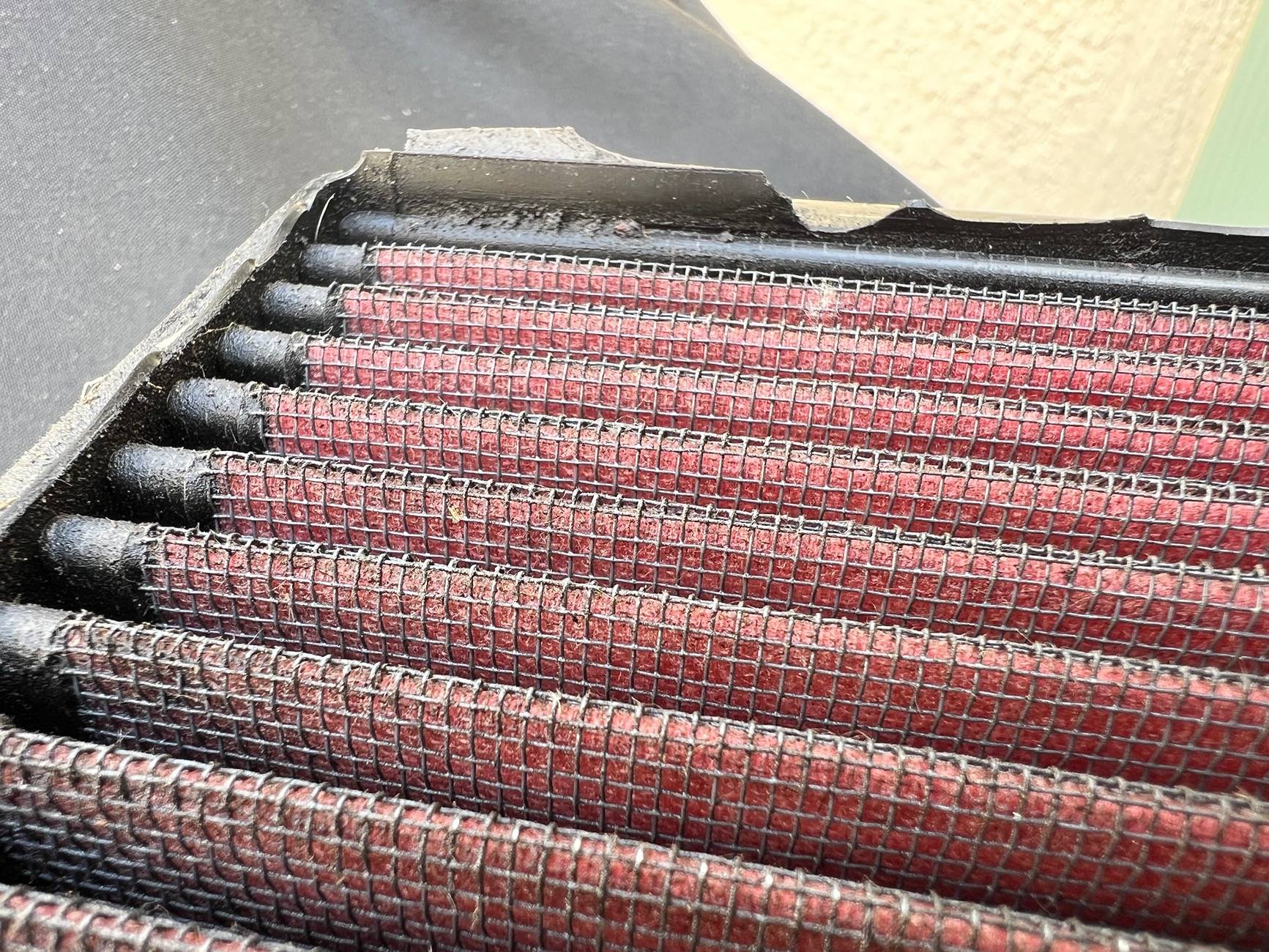

This is odd, right? It looks like the inner side of the air filter had bits of rubber pull off into the air intake.
Seems to defeat the purpose ... :/
Assume i should trash this and get another, yeh? It was a due for another cleaning...

The filter came with the Ford Performance tune so I never thought about the warranty. I will call KN and see how they handle this situation.
But besides that , it seems like a lot of rubber has been pulled into my air intake. I swapped in a standard filter and haven't noticed any performance or odd issues. But where would that rubber go/accumulate??

Unless those parts got stuck somewhere in the intercooler, they probably just got chewed up by the Turbo and burnt out the exhaust. I wouldn't worry too much since it is soft, not like it was hard plastic. Not saying it isn't anything to be upset about, just guessing you are ok.
I went back and forth a lot on getting another K&N since I replace them rather than clean them. I decided to go the route of the WIX filter. The performance differences are so small that it really just isn't worth it to me. Really for it to be worth it, I have to feel the difference in performance or MPG and I couldn't tell either filters apart.
I am also factoring I am in the desert now so daily driving and towing is usually more dirty than when I lived in Huntington Beach, add in direct injection so no fuel to clean the valves. Off-road is obvious but especially if you follow someone, I just didn't feel the risk was worth it.

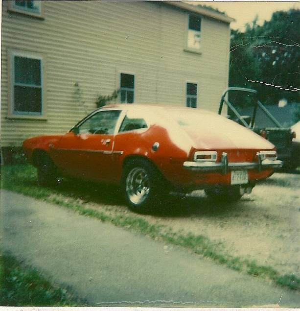

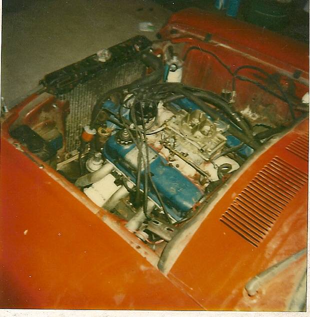

Well, when I was 19 I had a 1970 Mustang Mach 1 With a 428 CJ. Drove my new born son home from the hospital when he was born in a V-8 Pinto. Had a '72 F-100 with a 460 4V swapped in to it. Ya, the V-8 Ranger was one in a long line of fun, motor-swapped Fords. :) Sadly, a lot of the photos have gotten lost over the years.
