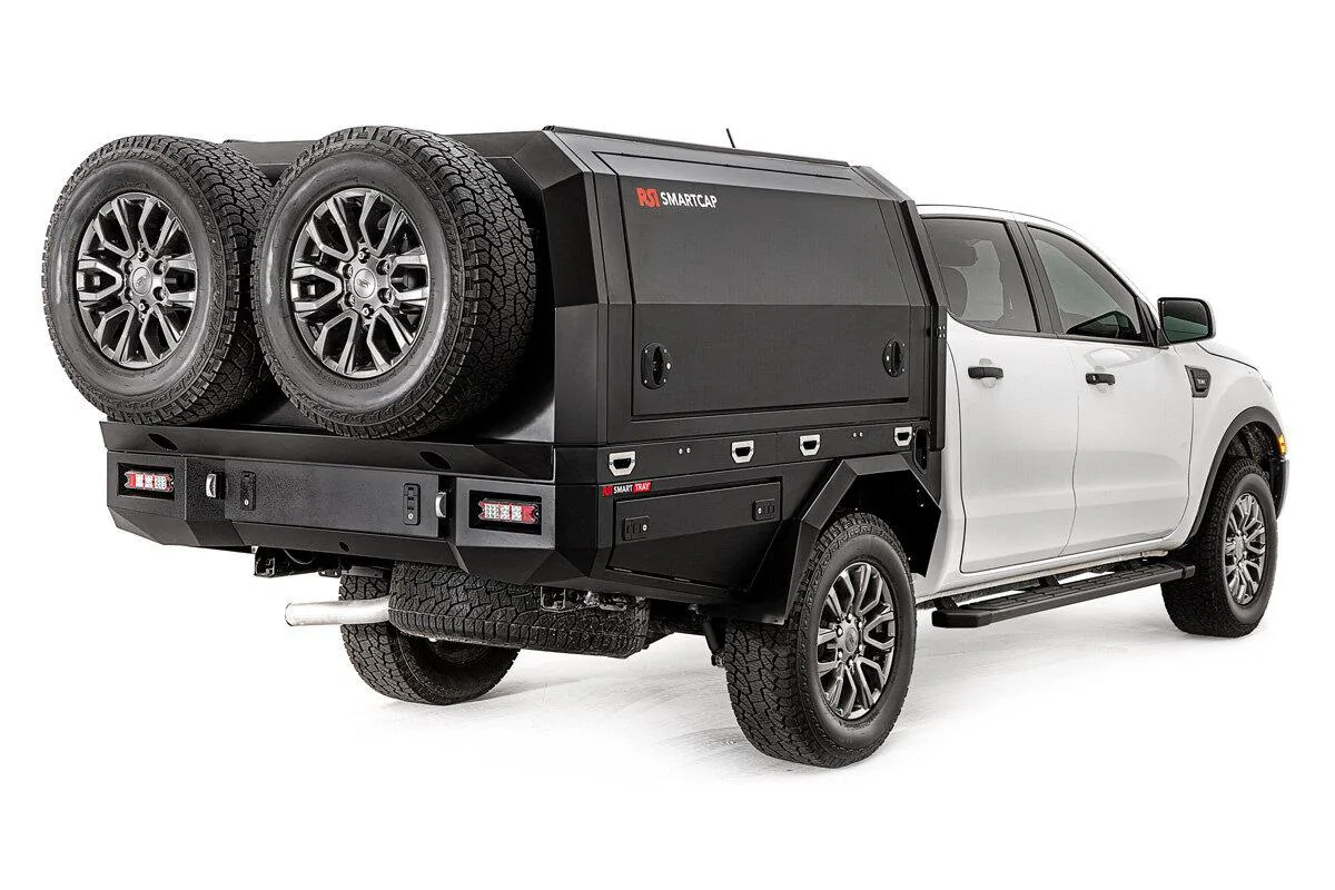

Info is rather limited, but if you have specific questions we're happy to investigate and get back to you.
This thread is the first time I have seen this.... interested.

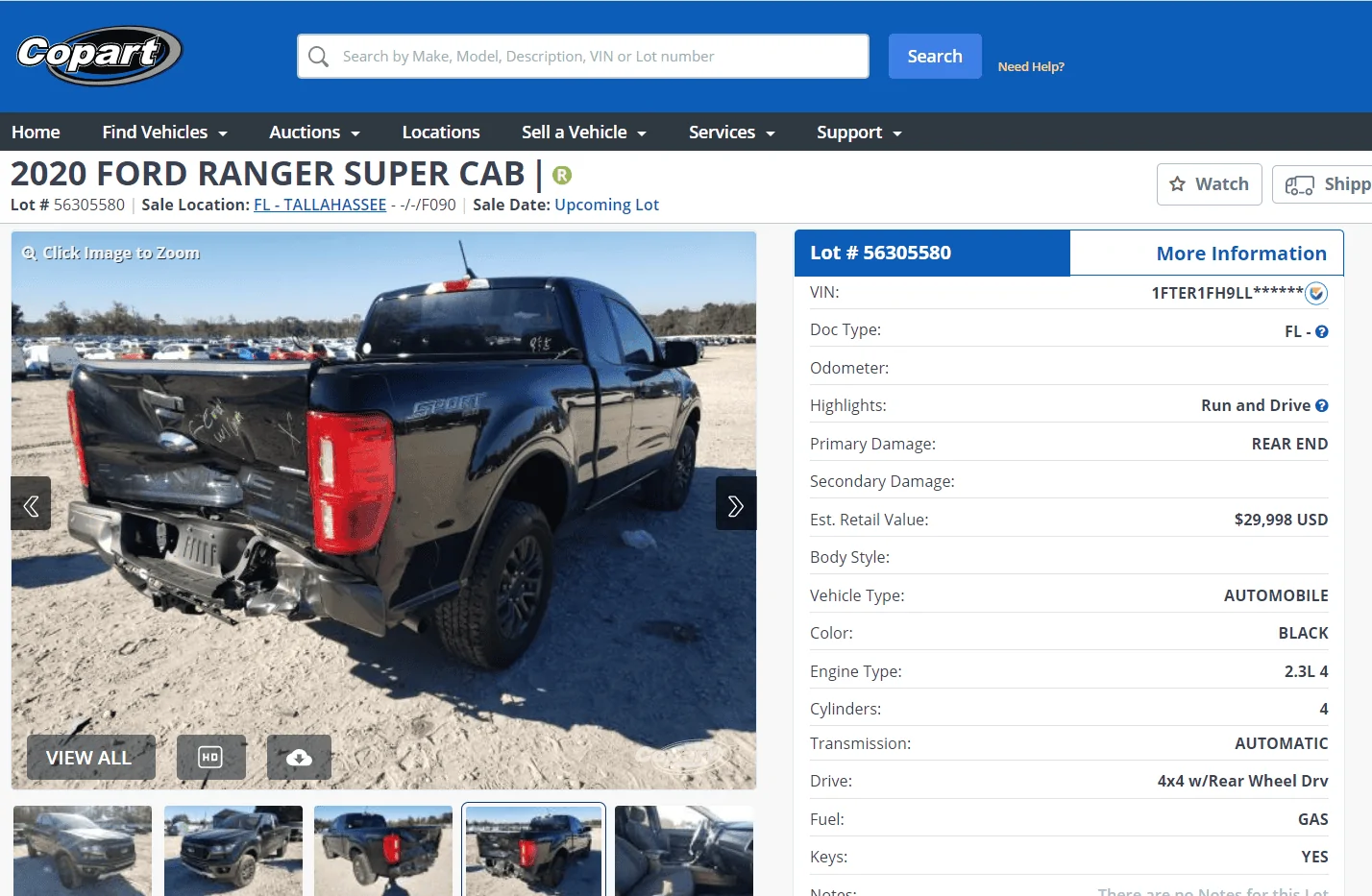

Can the bed replacement system be done by the truck owner or will the vehicle have to be taken to ??? to be installed? Is the factory receiver kept and used? backup sensors/camera kept? weight breakdown? I actually searched copart for another ranger that got rear ended...sorry for all the questions.

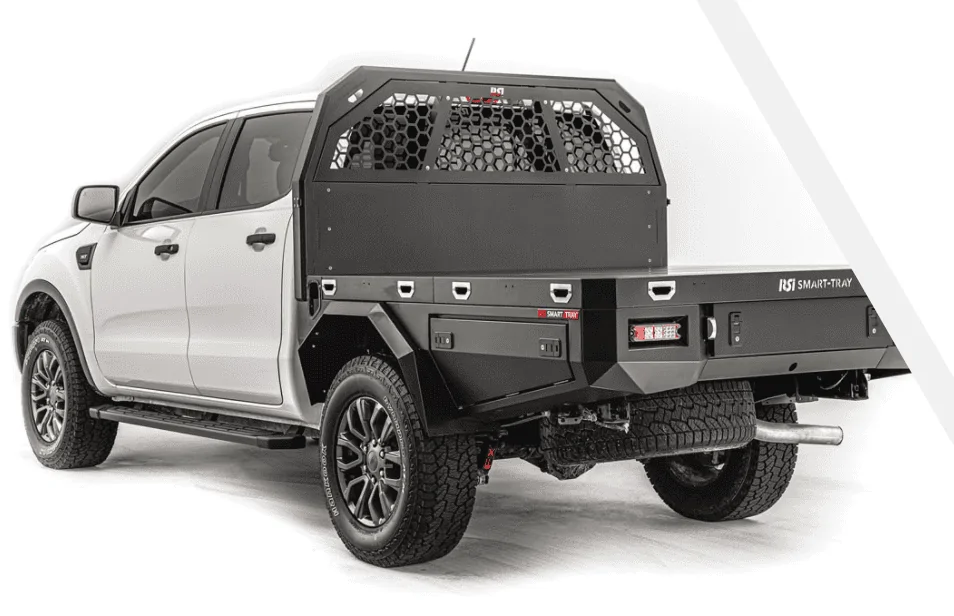

Hi Tom,
Spent two months in New Zealand and Australia. In NZ Ranger is the #1 vehicle. In Australia it is Toyota, but most have no pickup box and have such a flat bed. Seems to be cultural... I am guessing the Aussie's order with a box delete and put these flat beds on the back. Also, snorkels abound for the Dust...

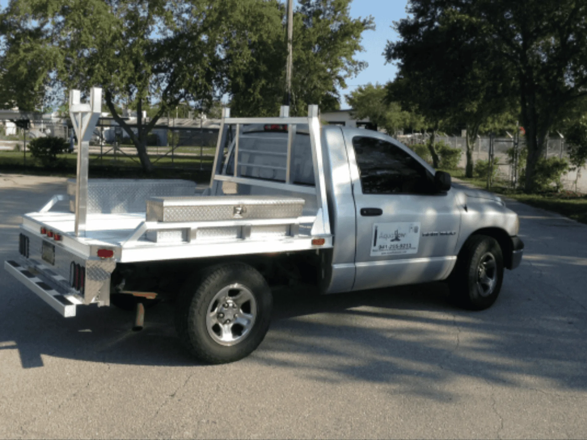

there is a guy in Bradenton who does custom beds...
the RSI bed replacement system looks like a great option. Here is what I was looking at....I just have a hard time taking off a good bed, hence the search for copart rangers that got rear ended.

Too my understanding most full size trucks in Australia and possibly NZ come with flat beds from the factory. Mid size trucks might have the option but it is still up to the owner if they want to change the bed for a different style.

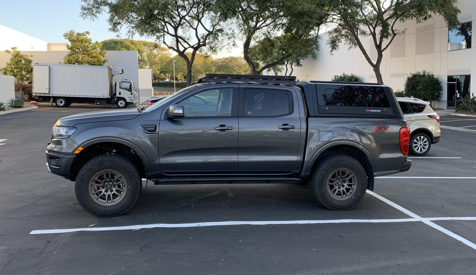

Agree on the rack - I’m gettting a low profile Front Runner rack installed in the next couple of weeks. I’ll update when I have images.
Here it is with the FR rack on. I like the combo. Definitely needs the extra leaf in the back, as sitting about an inch lower than the front with the weight of the RSI cap and ARB drawer. I’m waiting on some Icon rear shocks before doing this (back ordered forever...), if anyone wants to sell me some!
