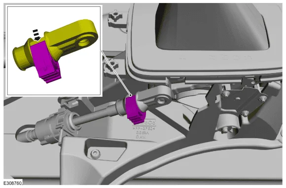

The problem with this theory is the fact the Ranger has a parking paw attached to the shifter via cable.
Yeah, my post isn't relevant here.
