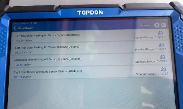

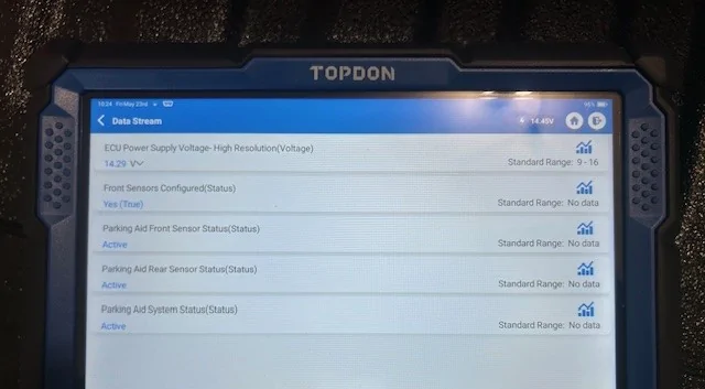

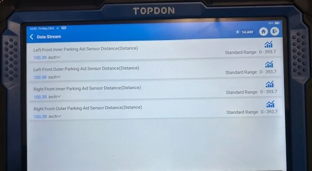

I played today since I had to hook up scanner anyway, pulled some Live Data PIDs when hooked up for a T-Shoot Reference.
Plus LEARNED something in the process as these are (Ultrasonic) sensors they produce a soundwave.
So as long as the Key is (On) and the system is active they are working, however they only send alert information when the condition is right (Reverse) or (Forward - Low Speed)
I first used a (Stethoscope) and could hear it (Cycle) then tried recording it.
So for a quick T-Shoot all sensors front and rear should be making this sound and they become active with just the key on.
Plus here is what PID's should show:
Note: Reading is with no obstacles, when you walk in front of or place object near them they react.
Rear Sensors
Front Sensors:
System Status PID's
