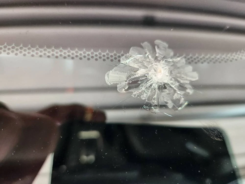

That one is going to be tough, with it being all the way through and it looks like a lot of separation between layers. I'm thinking replacement.
Yeah, the hit was super loud but I couldn't see it behind the black box. Looks pretty bad.:crazy:

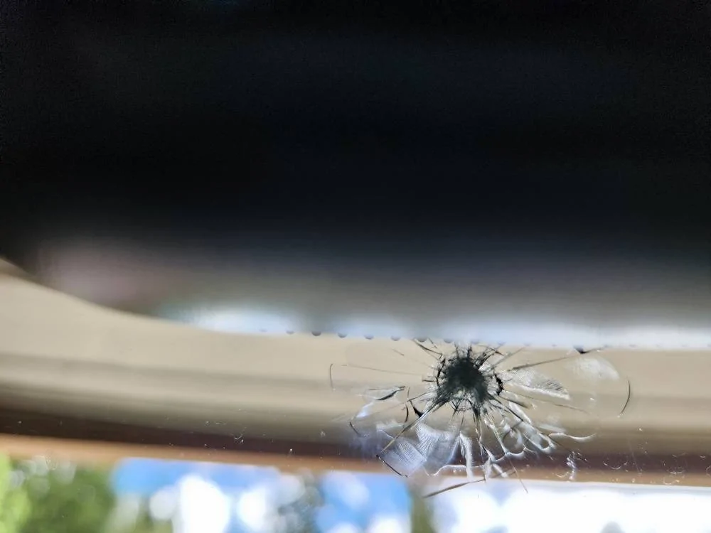

My confidence was very low with the glass repair kit but it worked very well. I did continually refer to the instructions but it worked.
It's been a year now and I still can't see the chip, I can see a thin edge of the filler stuff on one side, I never was able to get that flush, but it doesn't obscure vision and don't think that would cause an issue for a chip over the camera area.
That said, I think most places are pretty reasonable to fix chips (if I remember right, when I lived in Massachusetts, chips and replacement were "free" as covered by law).

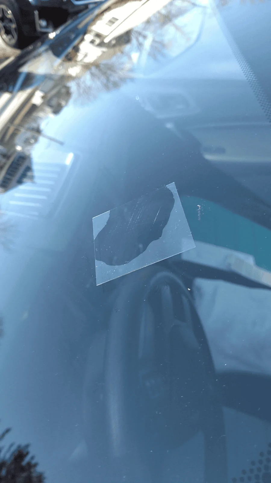

this edge effect below became less pronounced after some isopropyl cleanup
this is the last step for curing that shows where the filler was, it matches the "done" image above

Got my 4th window star today and asking you repair peeps if this one can be fixed. It's about size of a half dollar but luckily just out of eyesight as it is at the bottom of the black box on the windshield.
One picture from the outside and one from the inside.
Oh man, that doesn’t look good at all. :( Sucks that it happened.
