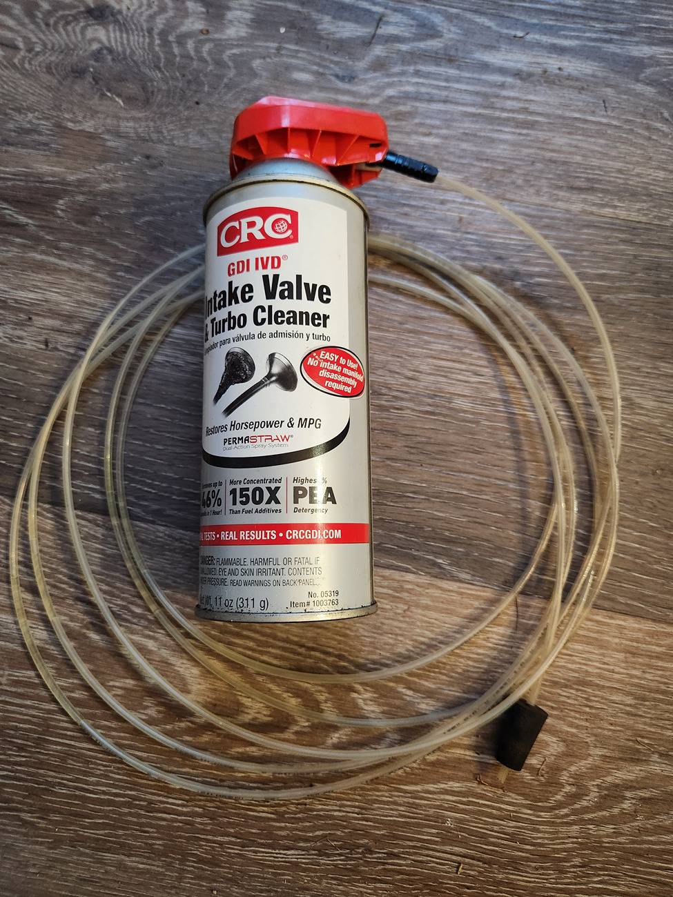

What I did use every other oil change (every 10K miles) was CRC GDI intake cleaner. I used the MAP sensor port, plugged with a rubber stopper and a long hose, to inject the cleaner while the engine is running.
Cool. Do you have a photo of this setup? And how much of the can do you use?
You'll have to tape the 1/8" hose connection or it will leak all over you. Again, this was for VW, so you'll have to find a suitable sensor port on the 2.3. I haven't got to that point yet, but I will soon, and I'll post about it.
The way it works is, you disconnect the sensor and remove it. Plug the hole with the stopper. Run the can and hose through the driver's window. Start the engine and hold the pedal to 2,000rpm. Squirt the cleaner and add more throttle to keep the rpms at 2,000. Hold each shot for about 10 seconds each. I used about 1/3 of a can each time. For the last shot, take your foot off the gas and keep squirting until the engine stalls. You may get all sorts of warnings on the dash. It's ok. Replace the sensor and let it sit for an hour. Change the oil in that period. When you're done, take the vehicle out for a drive on a road where you can hold the rpms steady at 2,000rpm to 3,000rpm or so for 20 minutes. Then find a road where you can do full on, full throttle blasts. Do at least five of them. The first few will blow out all sorts of nasty black crap. The rest may or may not. Once the exhaust looks clean, you're done. For me, the difference in the throttle response was immediate, and the next few tanks got better mileage.
