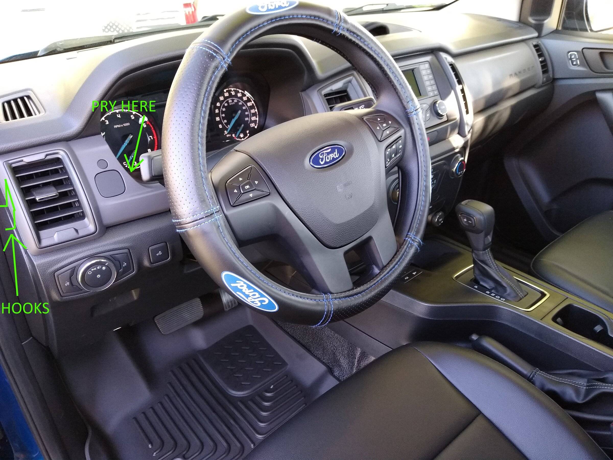

That panel with the mirror switch does just pop off. The left side of it hooks into the dash. So you have to pop it loose on the side closest to the gauges. I've had mine off a couple times.
