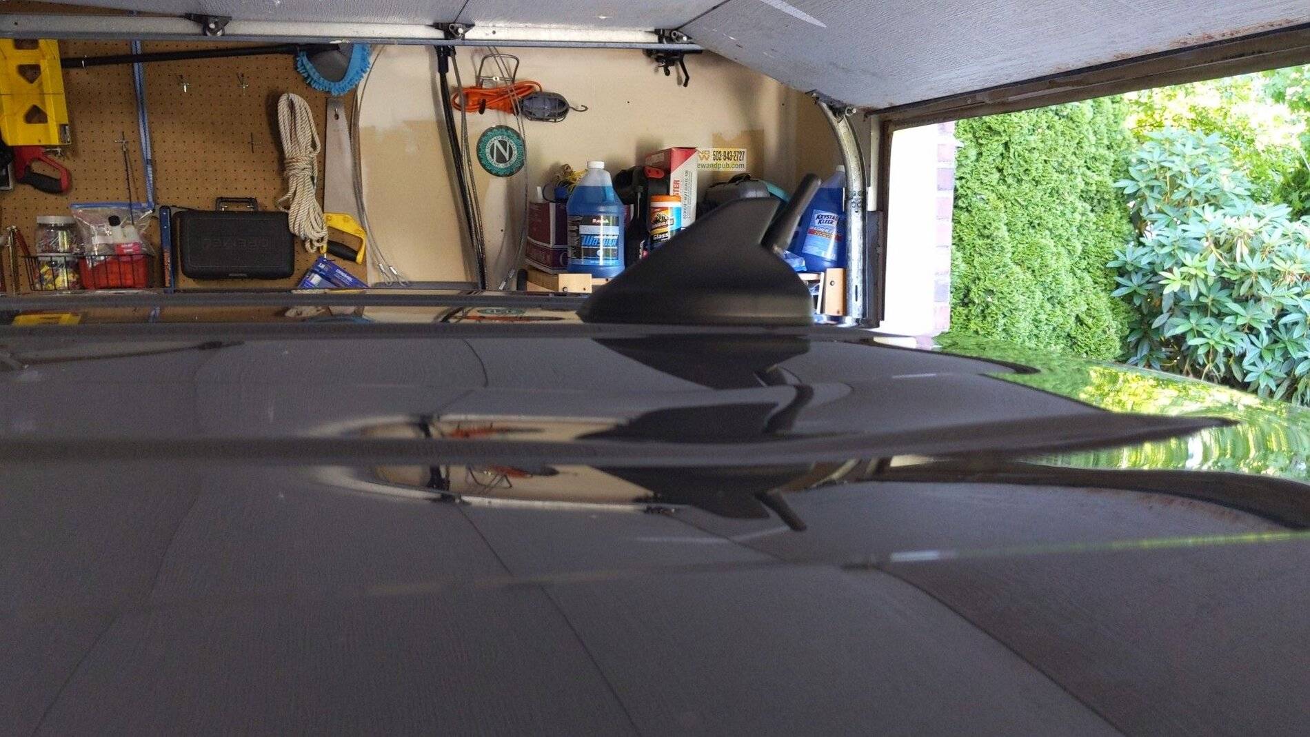

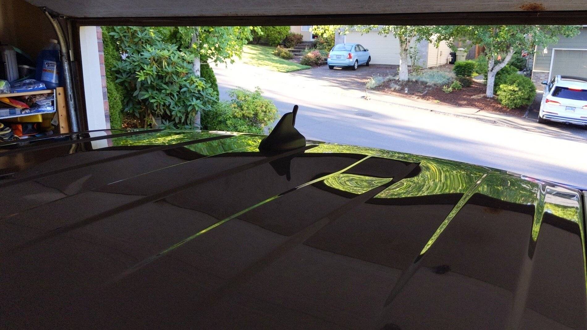

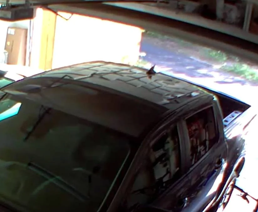

My truck has a roof dent. It looks like a ball or other large blunt object hit it. See pictures below. My PDR guy is confident he can repair it, but he suggests I remove the headliner first. I have removed door panels and dash panels in other vehicles (Suabrus, Mazdas) for stereo installs, but never touched a headliner.

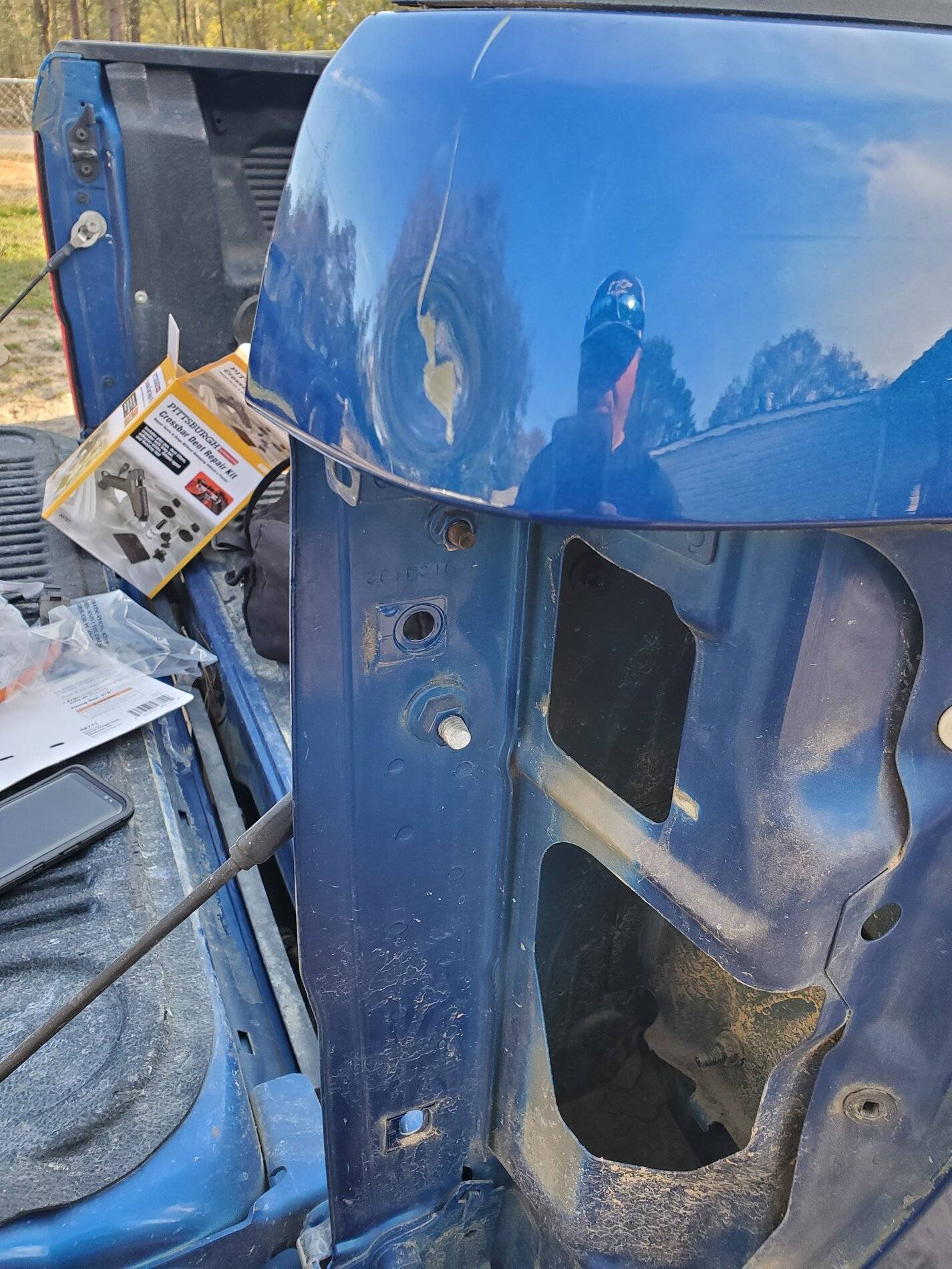

I've also had recent luck on my Ranger with this dent. I used the harbor freight dent puller you see in this photo. Worked well for me, in this case my dent was a bit much for the canned air trick.
I would have just gotten a PDR guy to repair this for $100-200. Looks like easy work for them.

Funny you suggest that....
I went to a body shop, to get their take on a repair. Their estimator said my removing the headliner and PDR was a good option. He stated they would remove the headliner anyway for their repair, which would also involve removing the read window, roof gutter, etc. Then they would have to paint and blend the roof.
After looking at it, and telling me the above, he said "Have you tried to just whack it from the inside". Well, no. So I opened the rear door and punched upwards directly under the dent. Pop. It snapped back into shape. OK well there are two tiny ripples if you look close where the sheet metal probably stretch a mm or two, but being on the roof, it is unnoticeable.
The body shop estiamter said they do that a lot with hood dents that are similar to my roof dent. He guessed it was a basketball, as they see a lot of that.
