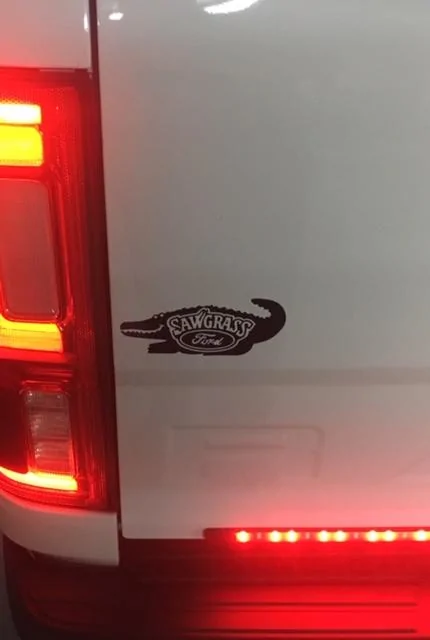

I was gonna to remove the dealers advert sticker, but living in Florida and being a Florida Gators fan, this one seems like it needs to stay. What do you all think, keep or remove?
If you want to advertise the dealer, keep it. If you want to show you're a FL Gators Fan, get the proper sticker... :)
