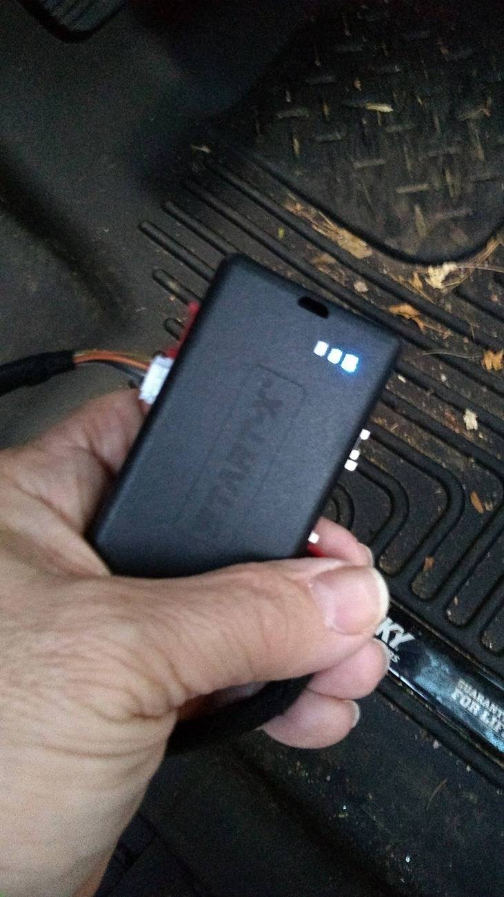

I did some digging on the (EU) Rangers
Start-X relies on (Settings)
Lock - Start (2x's) or whatever setting the instruction s state
On the North America Version (Ranger) this WAKES the BCM (The Lock-Signal) via Can Bus
On the (EU) Version Ranger - The (Lock) signal does not FULLY WAKE the BCM and Can Bus stays in partial sleep.
Start-X - is Requesting Remote Start, but since the bus is asleep - the message is not sent.
When you open the door (The BCM - Fully Wakes and the Can Bus also wakes) via the Door Ajar - Signal - so with the BCM & Can Busses awake - Remote Start Works
Basically - This
The EU Ranger appears to be programmed differently than the (NA) Rangers.
The EU version does not allow the (Lock) signal to wake a BCM that is in Sleep Mode, yes, the door locks work etc - but it does not wake it fully and therefore will not wake the can bus either.
However, the (Unlock) signal will wake both the BCM and Can Buses, if the information I have is correct vs opening the door (which you have confirmed - does)
So - TRY This:
With the Truck Locked and it's sat for a while - modules go to sleep
Press: Unlock (wait about 2-seconds)
then press Lock & Start (2xs) - or whatever normal starting procedure the instructions state.
Basically, I want to see if - The Unlock (First) then procedure (for the remote start unit) will get you past the main issue, the BCM is not waking up and the (UNLOCK) signal just may be the key for the (EU) Version Rangers that have this specific issue (Remote Start-Not Working) unless the door is opened.
