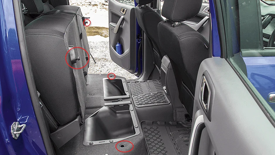

Yeah, sorry. This is for the seat cushion where it folds up to reveal the under-seat storage on my Crew Cab. There are to feet that have rubber bumpers on them, and one of them in gnarled to the point of falling off because it doesn't align properly with something in the floor pan. I believe the metal on metal is was was rattling since the rubber was essentially non-existent on one side of this foot.
I haven't seen the truck since I dropped it off on Tuesday, so I unfortunately don't have pictures of the issue from my truck. Here's a pic I found from the T6 Ranger that kind of covers the areas i'm referring to.

^^^ That sucks. As the other proud owner of a truck that spent time in the shop, I feel for ya. Good luck.
PS. I'm surprised if the floor pan was bent that bad that it would still fit flush to the frame and the doors all still fit tight. I guess I figured it would throw off alignment of other things, not just the seat.
