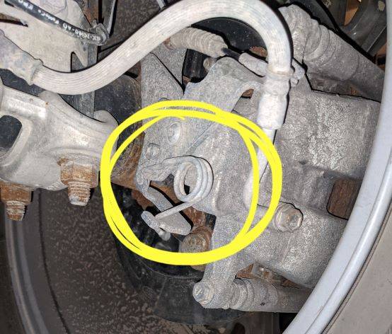

I’m curious to know if the parking brake return springs would cause an issue if they were missing. Anyone know? Are the springs still there Shane?
I’ll check and report back. I don’t think about the parking brake much though… I just don’t use it much. Pretty flat here and I’m just not in the habit of setting it like I used to be with a manual trans.

Yup. They are there. Both sides.
