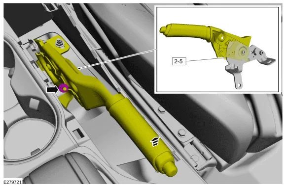

Is this a normal amount of play for my handbrake? Seems pretty loose
airline tech
Aug 24, 2022
4,483
8,555
Midwest - KS
Aircraft Tech
That's loose ? , mine only clicks a few times ...
Parking Lever stroke = 2-5 notches with the (First) notch verify Park Brake Light is Illuminated
plus, when fully down ensure brakes do not drag
Pull trim to access adjustment nut

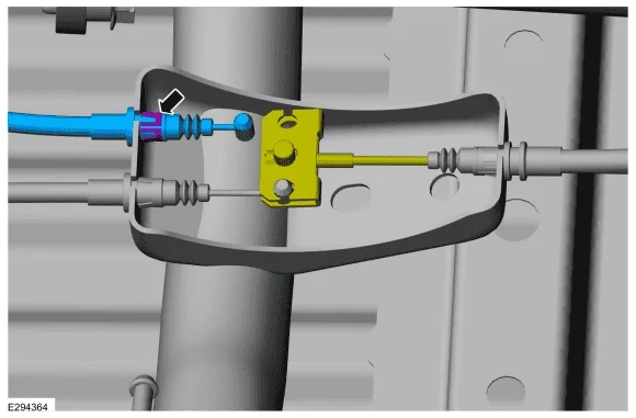

HOWEVER, it appears they possibly just loosened the cable and did not adjust it. I am thinking the whole issue and its being overlooked is a sticking cable to the left rear.
The Springs on the calipers are the tension return of the cables, if a cable is sticking you will have slack in the cable.
The adjustment nut pictured is the only adjustment for the cable system
Another possibility is the LR caliper was not installed correctly, meaning the piston was not properly aligned to the caliper alignment marks, the purpose of this step is to ensure the internal park brake (clutch cone) of the caliper will engage and disengage when the park brake is applied and released.
I hate to throw a tech under the bus, but the tech is possibly missing something here and just short-cutted the issue by loosening the cable. This means that when you apply the parking brake (IF I AM CORRECT) then the LR wheel will not be fully locked (park brake applied)
If you look under the truck near the rear axle you will see this, I suspect the LR cable will have more slack than the RR. I could be wrong, but I highly suspect this is your issue.
If BOTH cables have the same amount of slack, then just adjust the cable. But spray some lubricant at the open ends of the cables and actuate them to ensure they are not sticking.
This is 100% the issue. I got up underneath the truck and the left side has much more slack than the right side. Thanks for the diagrams man.
