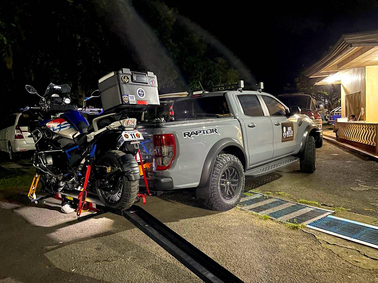

Anyone know? A fellow Raptor owner had to do an emergency transport of his friend's bike. It's around 250kg, well within the Raptor's payload, although we were concerned about the load on the rear axle.

500 lbs on the rear isn't going to bother the axle, but depending on how that bike carrier is mounted there might be an issue as that exceeds the tongue weight. I would assume a double or triple hitch setup, frame mounted, which would be fine.

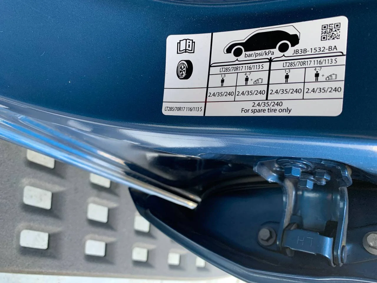

This is the frustrating bit. I'm in the Philippines, it isn't listed in our local Raptors. The door sticker only has recco'ed tire pressures.

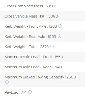

The pertinent numbers for the Ranger Raptor (in Australia at least):
