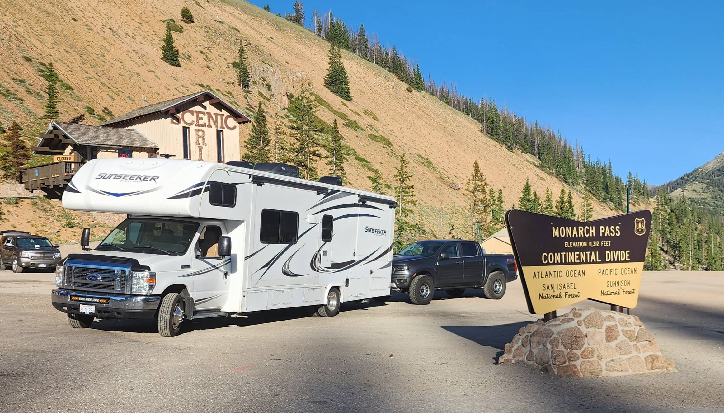

Towing over Monarch Pass....kinda sucked with the weight, But RV still made it.
My setup is similar with forester.
