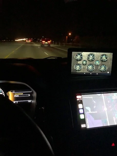

Sounds like a cool project. I tried to set up a remote vhf monitor with a Raspberry Pi setup in grad school. My problem was lack of a cell signal to transmit data. So you will not be able to monitor anything that you can not already monitor in Torque Pro for $4.95. With a $21 OBDII wireless dongle. All you need is a cheap android tablet and you have instant monitoring. I have not found the PID files to get extended functionality yet but I just have not played with the other Ford PID files. There is not one specifically for the Ranger as far as I know.
PID files are the custom programming to read the sensor data from our Rangers thru the OBDII port. There is default programming built in too Torque Pro that gives basic monitoring of boost, coolant temp, exhaust temp, fuel rail pressure...etc....That is what I am tied into at this point. If anyone knows where to get this data please let me know. I have scoured the Focus RS forum and F150 forum for this information.
